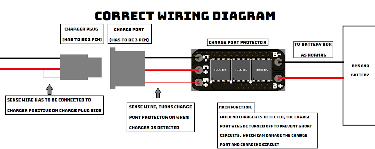

I was curious, guessing that diodes on charge ports like will be used on Floatwheel ADV will make this not possible.
Maybe this could be used and allow that boosting charge port feature still.
Using a MOSFET charge port protector or a diode shouldn’t have any effect on a “universal input” voltage to boost converter setup.
