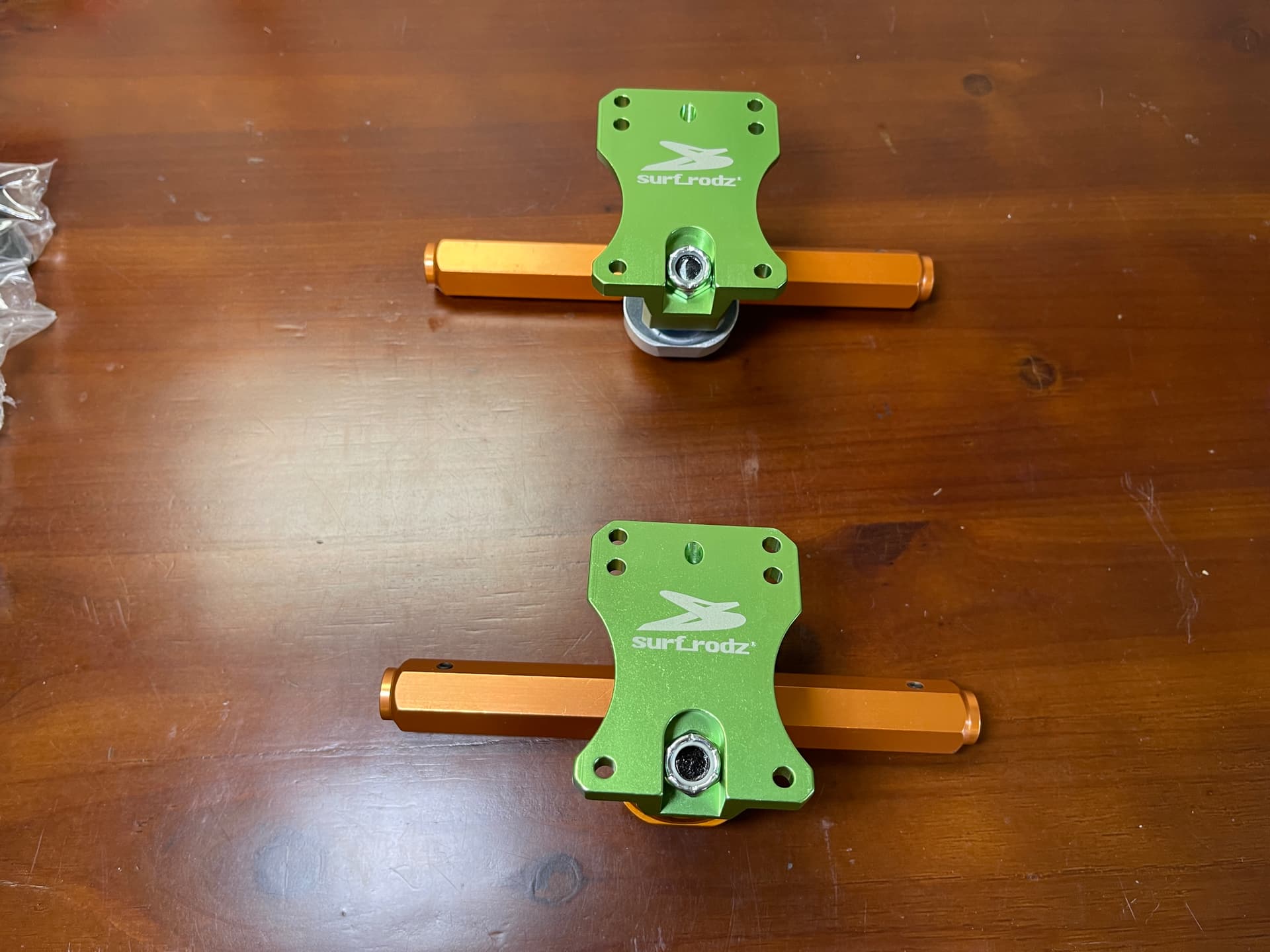

[US] New Surf Rodz RKP and TKP
From the mystery box. Just swapped some colors and don’t need these.
Item 1
SR RKP 176mm 50 degree baseplate and 35 degree baseplate
$160
Item 2
SR TKP 177mm
$120

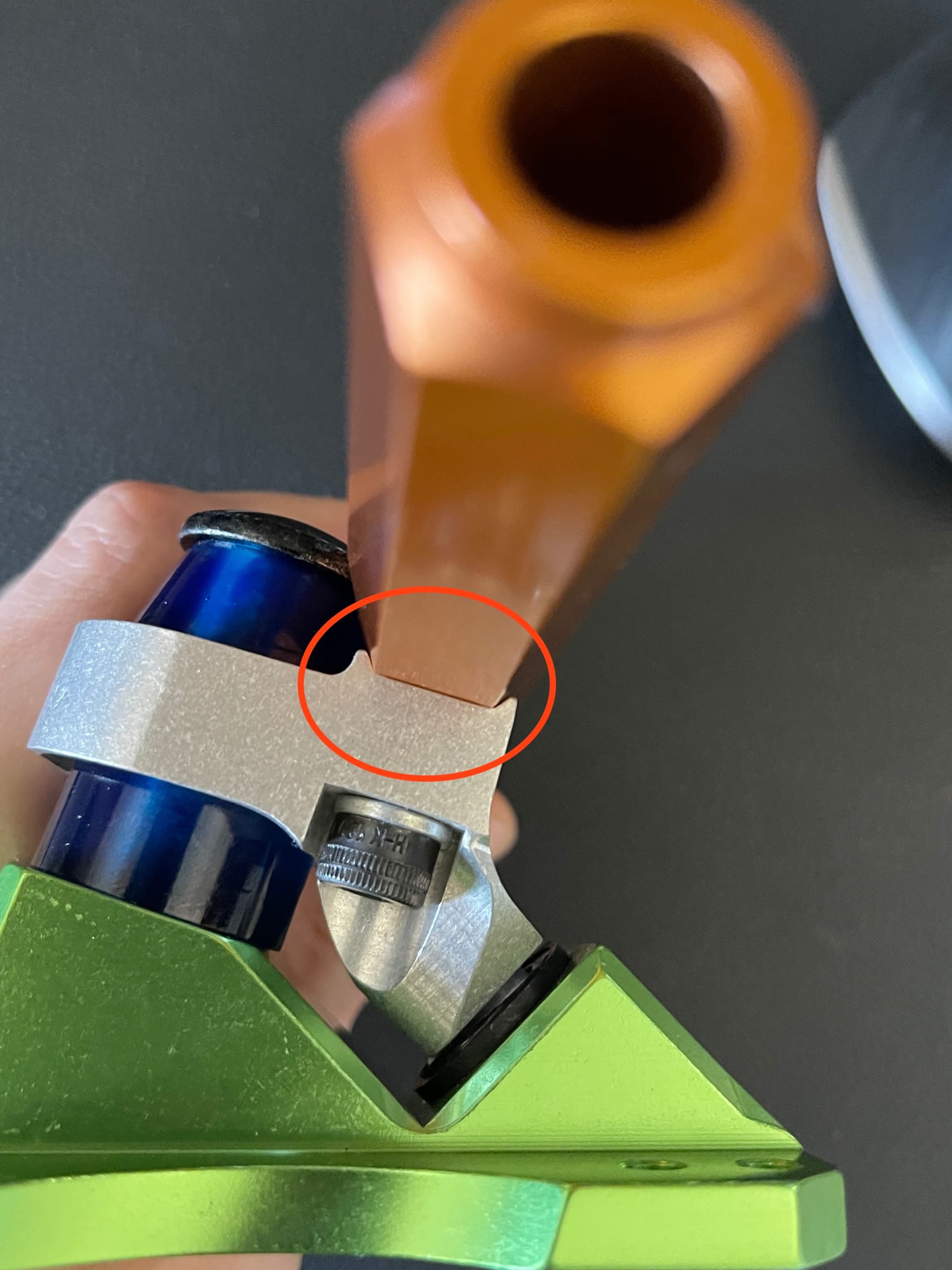

The TKPs have a “common” failure point where the hanger attaches to the bushing support. Two bolts can’t handle the sheering force. I have yet to have a problem, but I tend to ride sub 30mph. @glyphiks has snapped a few, but I think it was just him trying to bleed and not really a problem with the trucks

Don’t wanna shit in anyone’s cereal, but seeing as I was tagged here, I’ll share my insight.
I have broken these several times, always at the interface between the pivot piece and the hanger. Either the bolts have come loose, stripped the threads in the hanger, or the bolts have just straight up sheared.
I cannot in good faith recommend the surfrodz tkps be used on an esk8.
That said, they are an absolute dream to ride and i don’t regret my time with them.
I’m about to put them on a deck and that sounds concerning. It’s for my gf’s board and she’s only 100lbs. Do you know of any fixes? Maybe using titanium bolts?
The best fix I have come up with is to use different trucks.
The ‘fix’ that lasted the longest for me was to epoxy the bolts in, epoxy the pieces together and epoxy the heads of the bolts so that they couldn’t come loose.
They still broke.

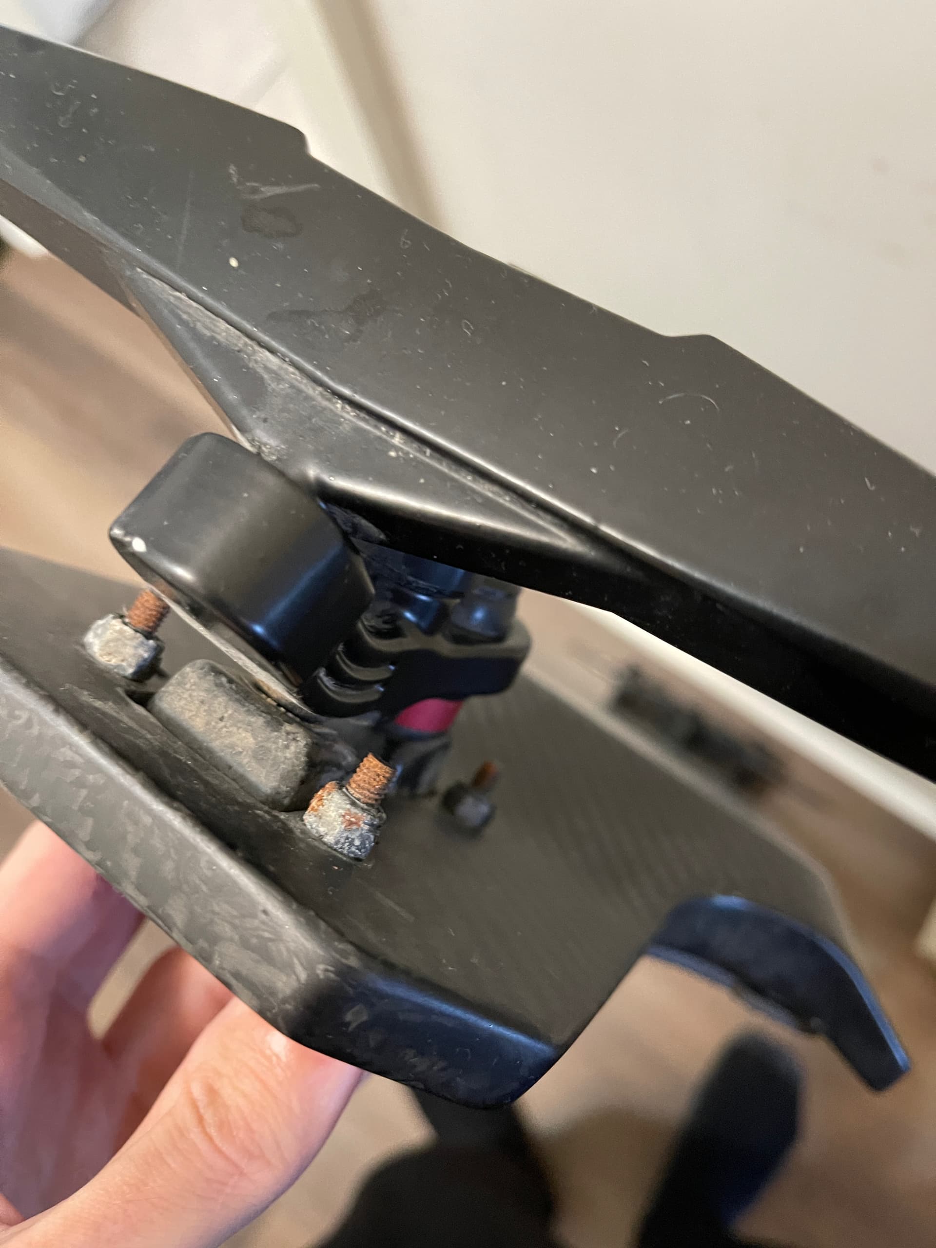

But, titanium will stretch twice as much as steel before it breaks. It’s also more resistant to corrosion, which is a huge factor considering I live on the coast! Here is a picture of my 1 year old eovan. The strength of these bolt have definitely been compromised.
