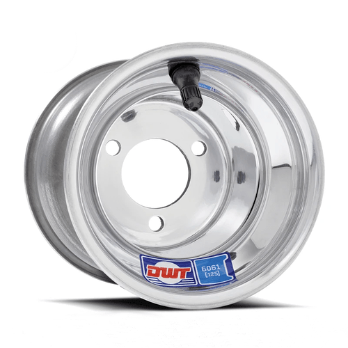

This place has kart rims in much narrower widths, 3.25”, 4” and 4.5”. Think there’s value in that, particularly for the case of using 4.2”-4.5” rain tires? A closer matched rim could permit lower pressures, or affect the wear pattern.

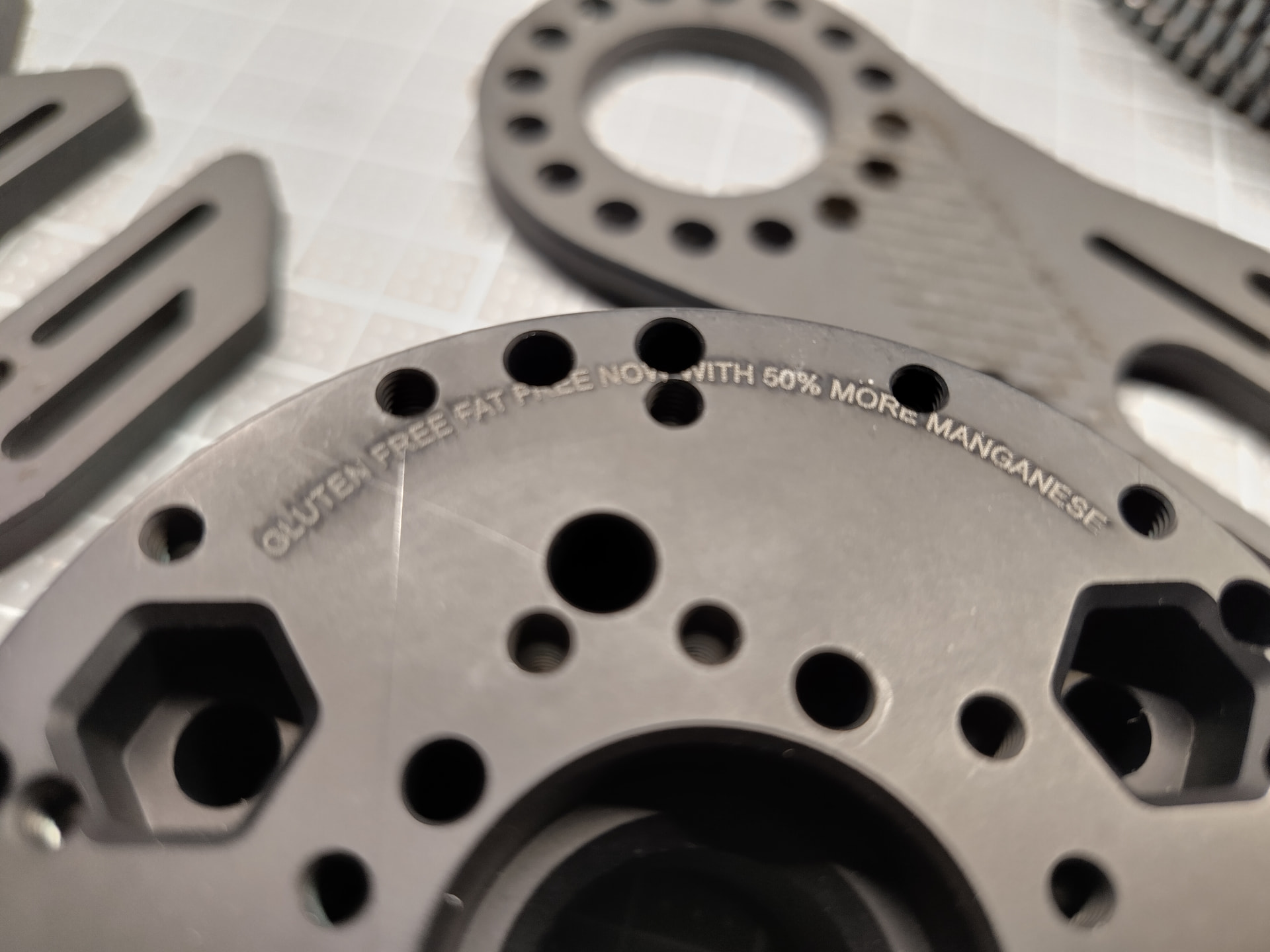

So far, the nylock pockets are tight, but you can pull the nuts into their pockets using the bolts. Getting them out is a later problem :sweat_smile:
They fit and center well onto my particular wheels even without centering rings, though I haven’t spun them up. The holes look like they line up for MBS pattern, and I’ve got hardware coming tomorrow to confirm for sure
