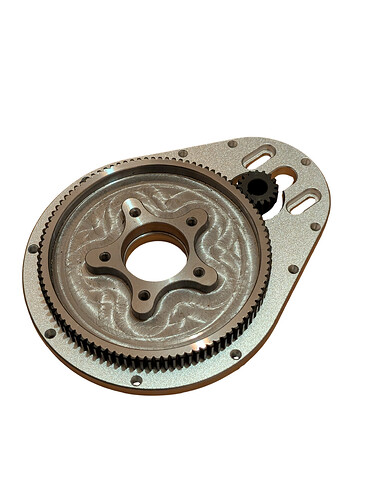

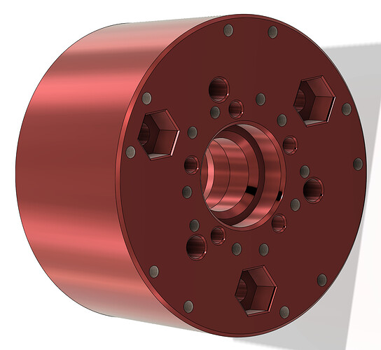

Go kart tires are starting to catch on in the esk8 racing scene. Like it or hate it, I wanna try it, and currently the only way to do so is by having Stooge make you a custom 5/8” axle for your 3-links and modifying an off the shelf go kart hub to mount to his gears.
I wanted something with maximum compatibility with existing esk8 trucks, drive patterns, standards, and go kart wheels, so anybody can use these tires to “ruin esk8 wheel to wheel racing forever” -@Evwan :wink:
Enter:
GK Hubs

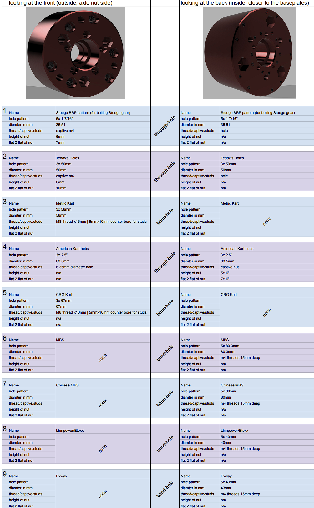

Compatibility list:
Bearing spacing:
  • MBS - with extended outside bearing bores, you can stack up to three bearings for increased load capacity, depending how much axle space you have. We worked closely with Big Bearing™ on this design to ensure you’ll be buying as many bearings as possible.
  • Urethane (please don’t actually use this, it was put there exclusively for shits, giggles, and photo shoots) - one 22mm bearing seat, one 28mm bearing seat. Use one 608 and one 638 bearing
Esk8 drive bolt patterns:
  • MBS - threaded holes
  • China 80mm - threaded holes; MBS usually works fine but we added it just in case
  • Linnpower/Etoxx gear drives - 40mm circle
  • Exway gear drives - 43mm circle
  • SRB drive hub pattern, but M4 instead of 8-32 (in case the MBS interface suddenly disappears again :wink:)
  • Additional patterns might be added on a case by case basis if you ask within the next few days, but no guarantees
Go kart wheel bolt patterns:

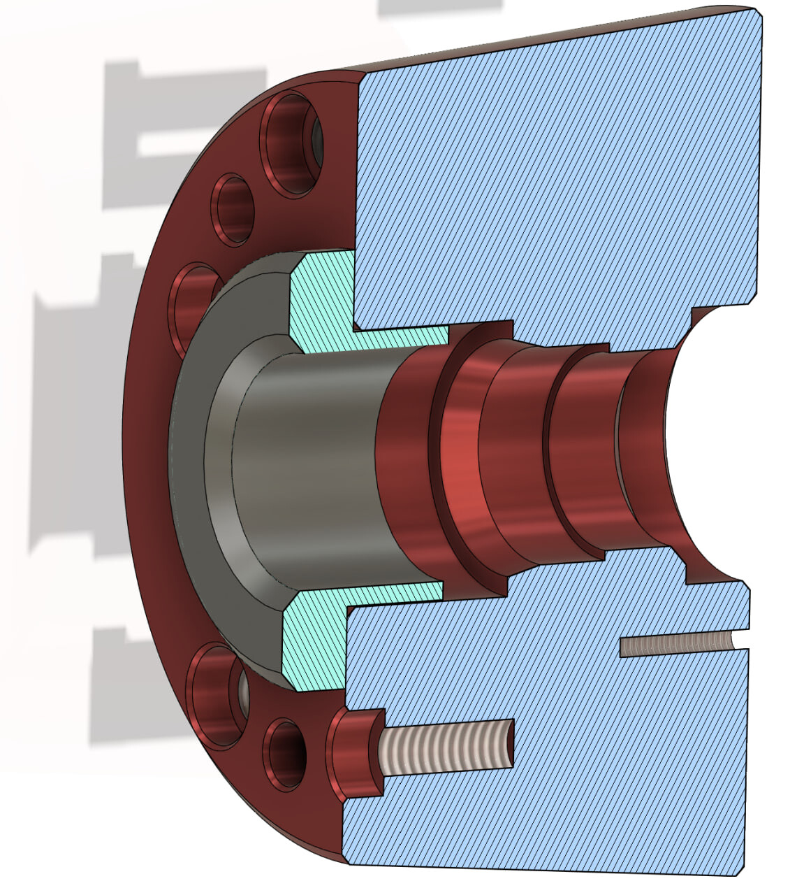

  • American standard - uses captive nut pockets on the inside of the hub and bolts to attach the wheel. These hubs have been tested to fit inside DWT Classic American standard wheels, which is what Stooge has been using
  • Metric standard - counterbored threaded holes to accept standard M8x1.25 kart studs
  • CRG front hub standard - counterbored threaded holes to accept standard M8x1.25 kart studs
These hubs are designed for kart wheels with 2” backspacing or less. Others might work, but likely future batches of these made at different lengths will be required.

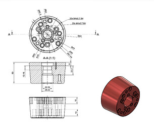

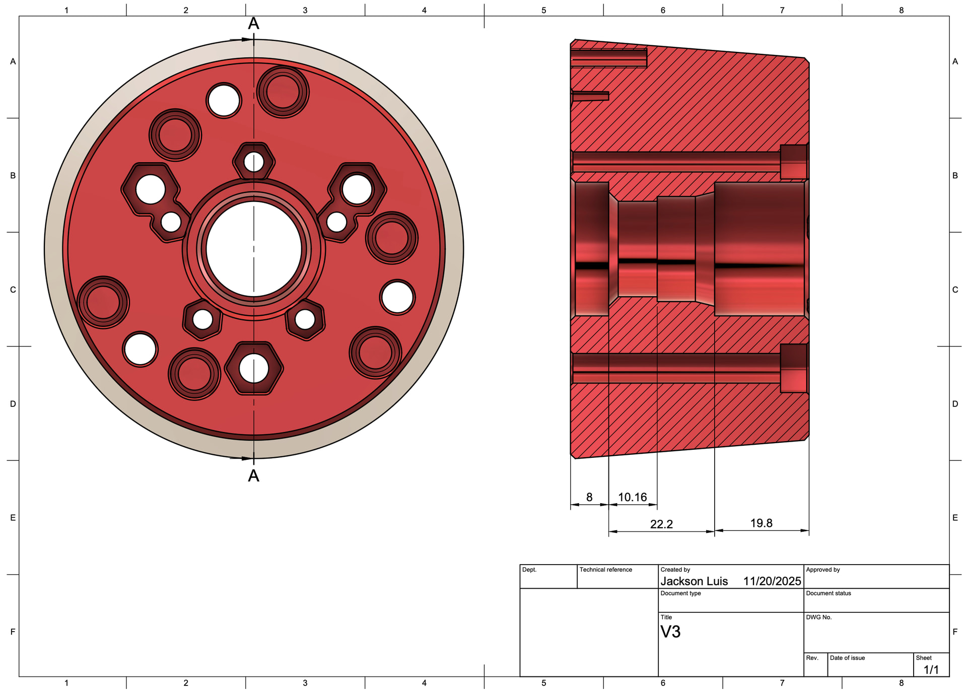

Drawings, courtesy of @jack.luis, who will take over selling these after this initial batch:
If you need custom parts designed, hit him up on his website:

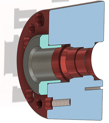

I’m not super knowledgeable and don’t want to start an argument or anything, but isn’t the centering ring on a go-kart hub supposed to help support the weight? I was under the impression it was there for more than just centering. I’m somewhat interested, but feel like I’d prefer something that has an integrated centering ring, even if it ends up being less universal as far as the kart wheels used or requires some kind of adapter or something.
That’s new info to us!
We are gonna do some research on this and get back to this thread with what we find and how we changed the design to account. Thanks for the heads up!
Edit after very quick research:
First thing I found is this video
At about 20 seconds on they share the same info I assumed while designing this. I am more than interested in getting more opinions. Thanks again!

It seems I may have been mistaken. I think I was told that the lugs don’t support the weight of the wheel and thought that meant the ring does, but what is really happening is that once you tighten the lugs with everything centered, it’s the friction between the wheel and the hub that actually transfers the force.
Glad we were able to clear that up!
While we’re on the topic here is what the centering ring will look like. Comes free with the hubs and you just lmk what your go karts center circle diameter is. This example is 1.75in.
GKH Centering ring.3mf (18.3 KB)

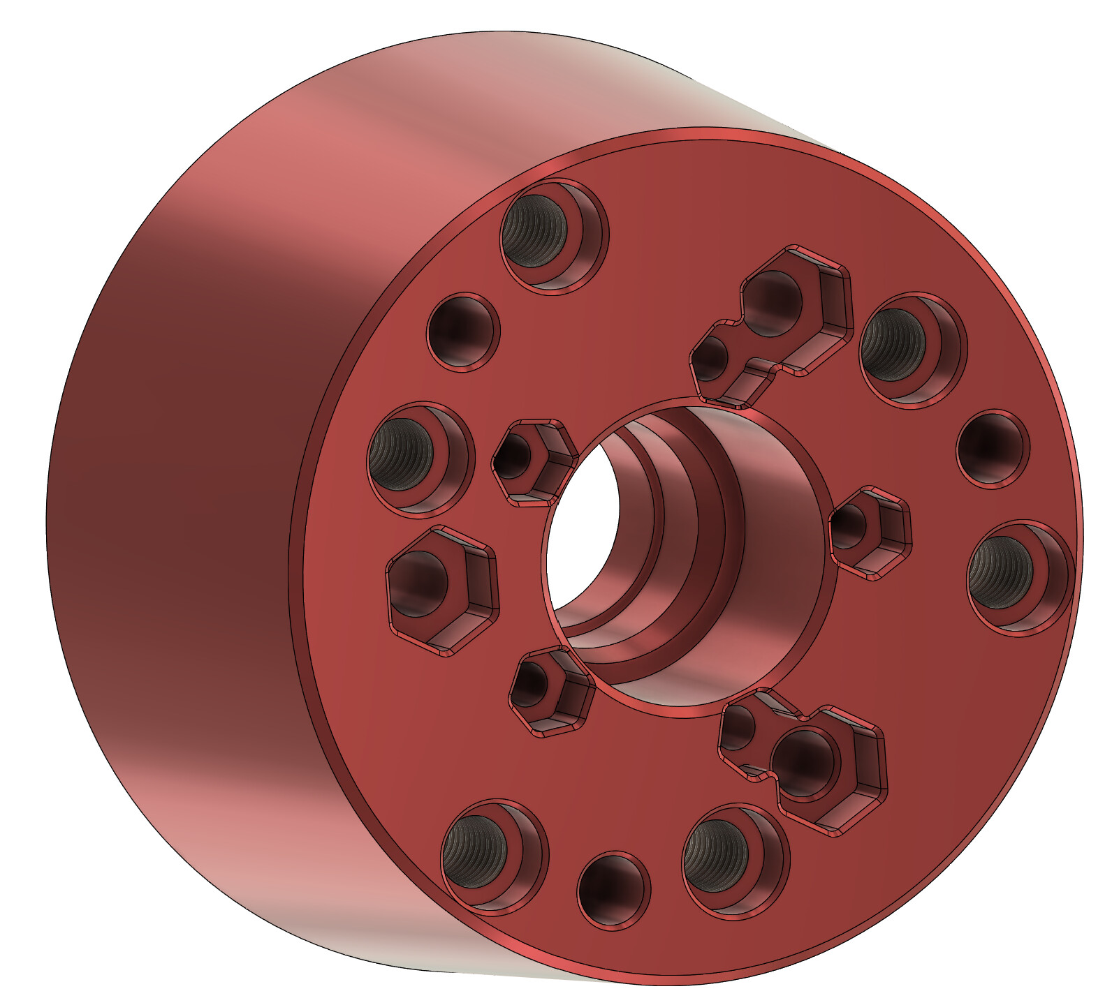

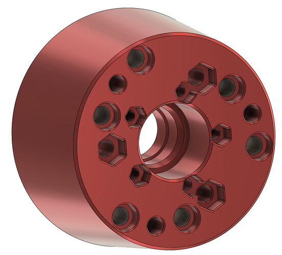

Is there a way to distinguish between the MBS and the 80mm China pattern on the hub?
carefully

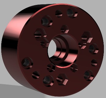

Looks like you’re planning on using captive hex nuts instead of tapped holes(?)
Any reason for that(cost?)
Personally I prefer tapped holes, less faf. but that’s personal preference
Don’t have to wait for loctite to cure?
