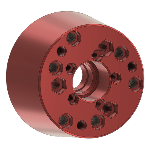

But I’m not sure which kinds of hubs they fit on but probably one that will fit one of the mounting points on this piece of Swiss cheese

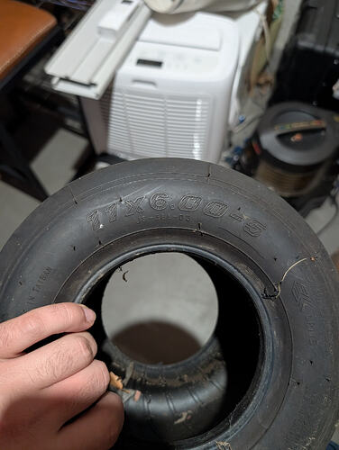

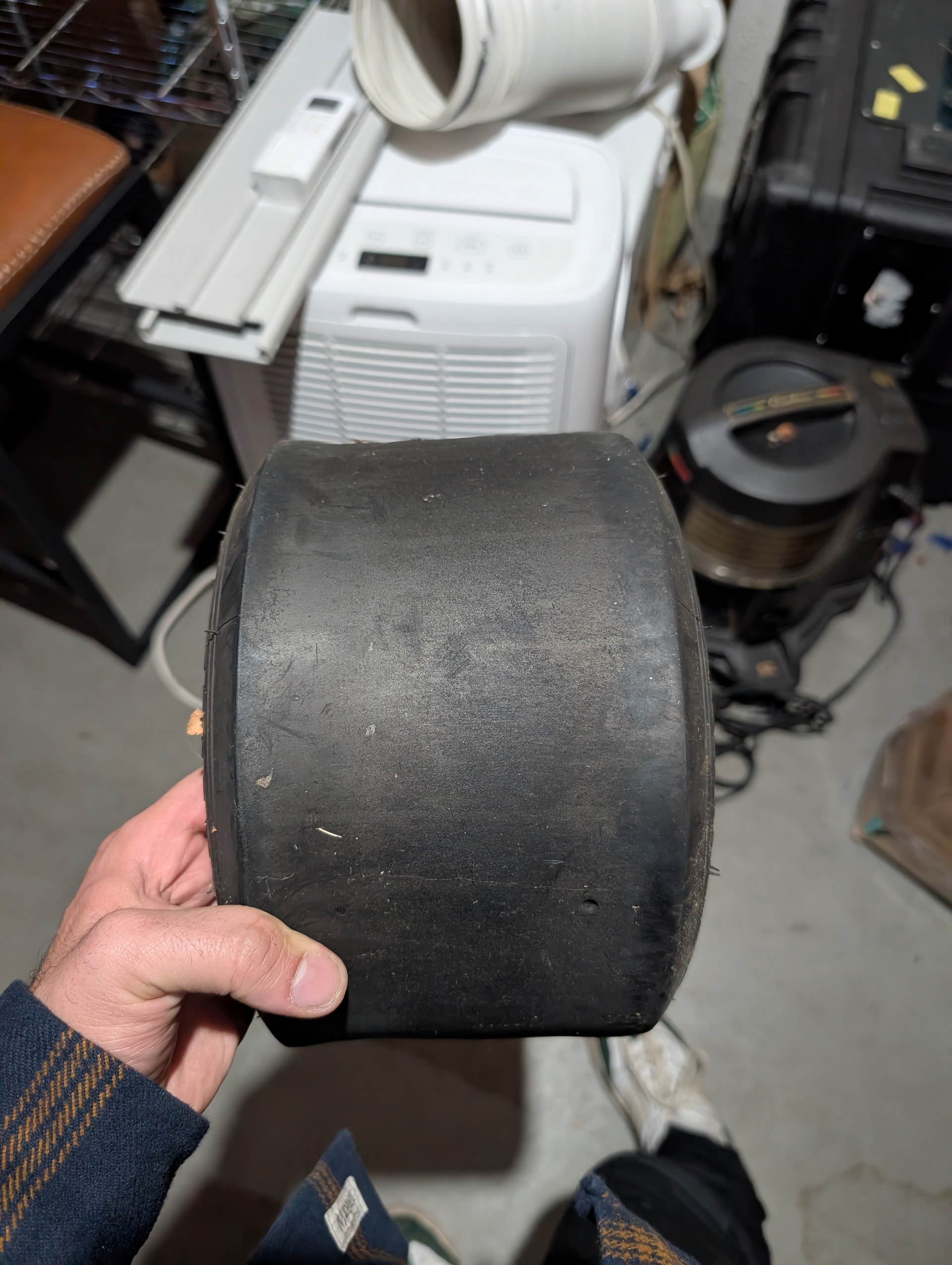

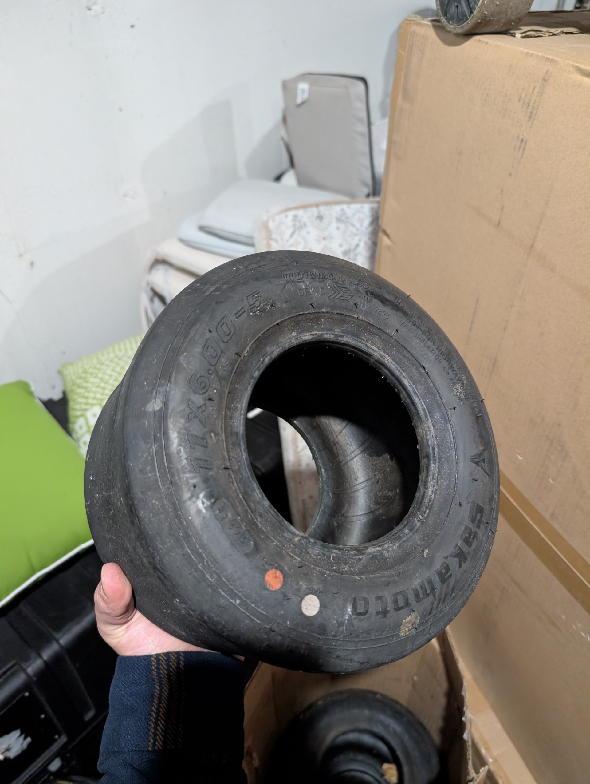

If you want to try it without spending that much, go to a karting place and ask them if you can dig around in their trash tire pile. Rental compound tires you’ll find a bunch, with a bit of luck you might also find softer tires than that. Use your finger nail to judge the rubber compound.
40$ a piece is realistic for rims, I paid about that for mine. For brand new tires you should be looking at fronts, I’d honestly be surprised if you find fronts more than 55$ a piece, in Europe I can get the best race compounds for that kind of money.
I finished our season finals race at 3rd place on trash pile tires that the karting place said I can take for free.
So it’s looking like we have room for only one set of trampa holes. I say we make them threaded holes as removing threads is much easier than adding them.
Thoughts?

It’s definitely cool if that kind of cheaper wheel works in addition to full race kart rim/wheel setups. When I was looking I was thinking they were might create problems with the 2 inch backspacing requirement.

What is the largest pulley that’ll work with these?
I don’t think a pulley too large exists for wheels this big
Yes
Yea agreed I’m asking if anyone knows of any huge pulleys that’ll fit these adapters
Naw, most likely you will have to get a custom one.
