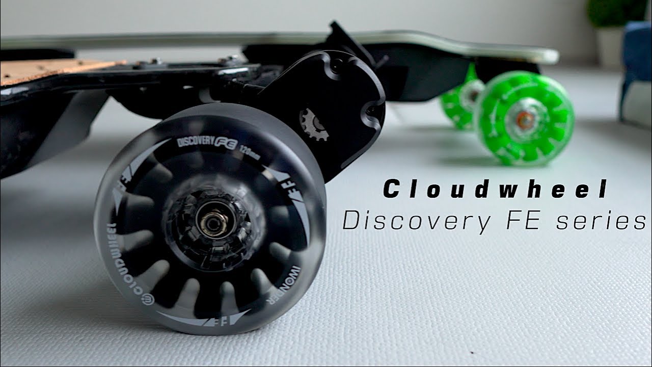

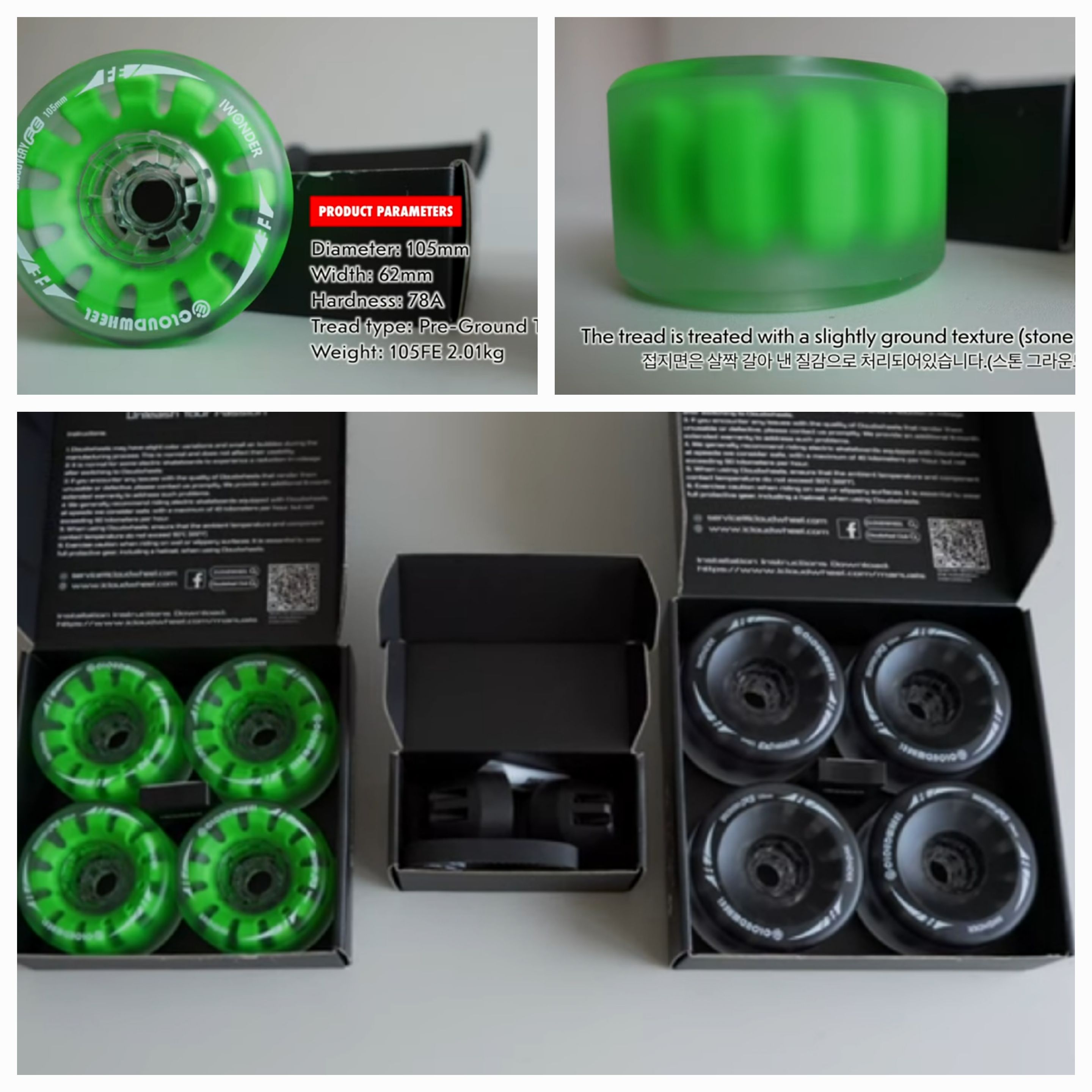

New cloudwheel discovery FE 105mm and 120mm wheels.
I also really enjoyed these wheels, definitely good stuff. Haven’t tried them with any moisture but I assume the experience would be about the same.
Noice video brother. You’ve made me a believer. I love my cloudwheel rovers 110mm as they got me through a soggy winter. Was hoping they’ll do a 120mm version.
Based on your initial impressions, I’ll take the FE 120mm as my commuting summer wheel.
