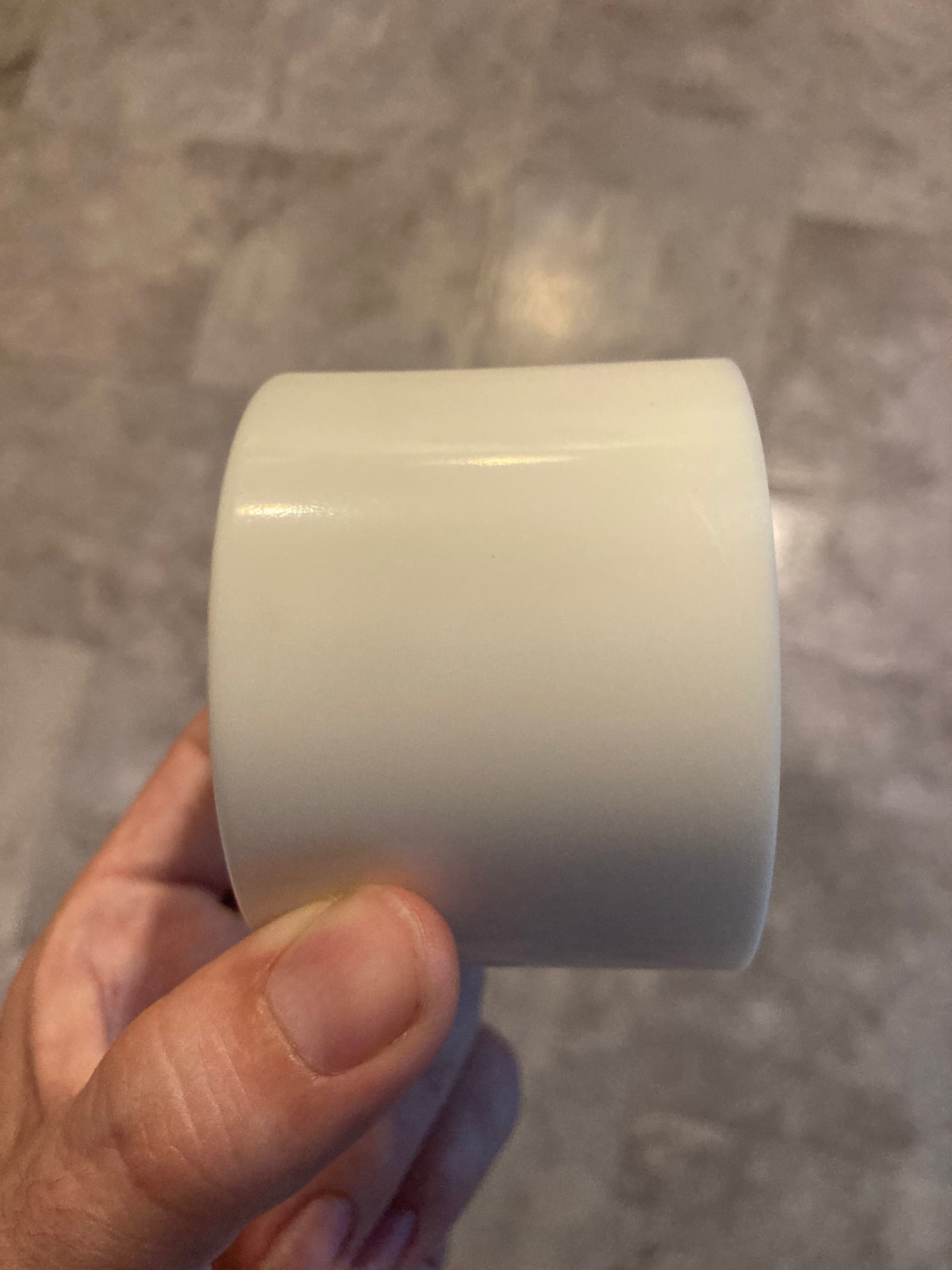

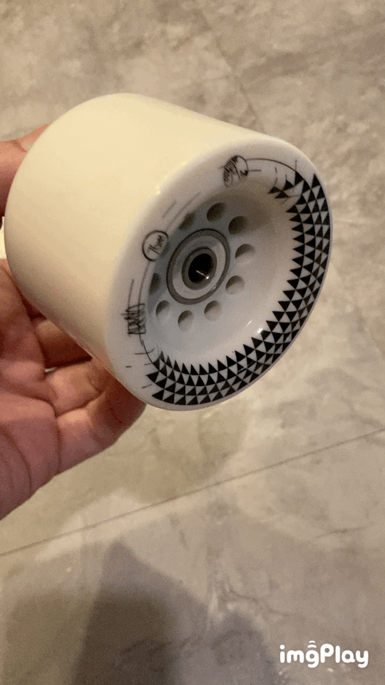

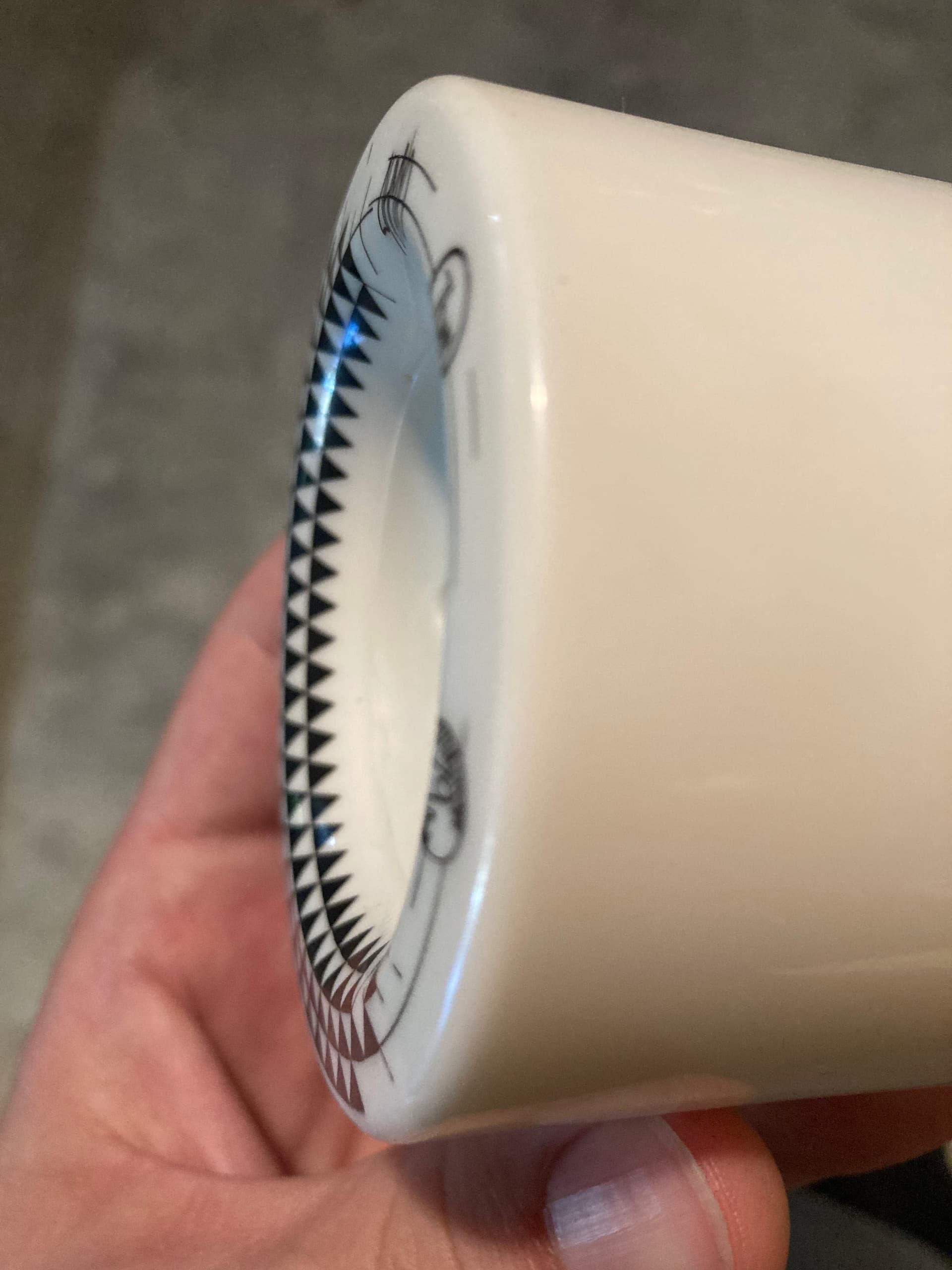

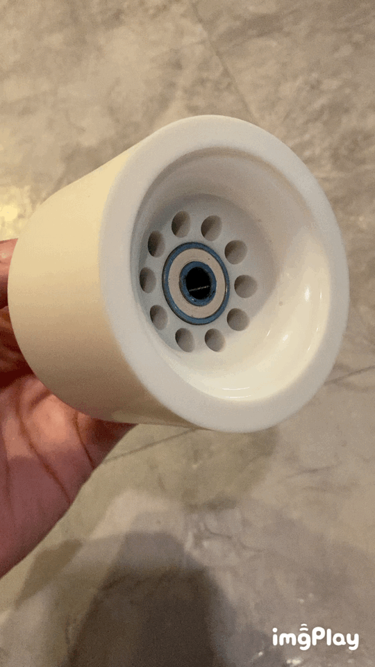

I have a set of DH Akashas and some 32T evolve pulleys. It seems the inset core on the DH is oriented so the kegel pins snap in correctly from the outside face and don’t seem to engage properly from the other.
Haven’t run them on a build yet but they fit nicely and seem pretty solid test fitting with them flipped
thanks for sharing this dude.
they are such cute little wheels.
the evolve pulleys do go in some with them facing the normal way right?
I wonder if with it all bolted in place it would be fine.
do the outer and inner lips have a slight differebt profile.
Yep the pulleys go in the same amount either way, they just don’t snap into place and stay put on the inside face.
Bolt on pulleys would work just fine either way I think, and as long as the axel nut is tight holding the wheel and pulley together a press fit would probably be fine on the inside face still if the excess lip material is removed.
Outside lip is rounded, inside lip is sharp like the Venom Mach 1’s

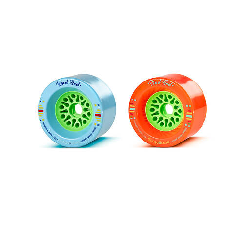

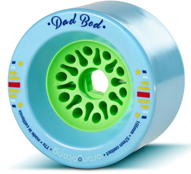

Anyone tried the new Dad Bod 77A?

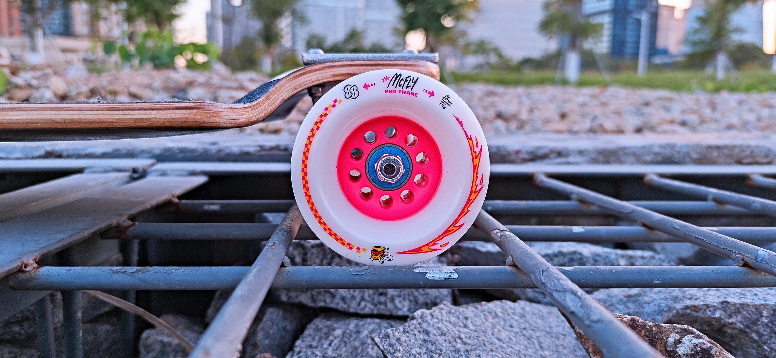

Kegel core options:
88 wheel co
They have a couple 80 &86 mm options with the core

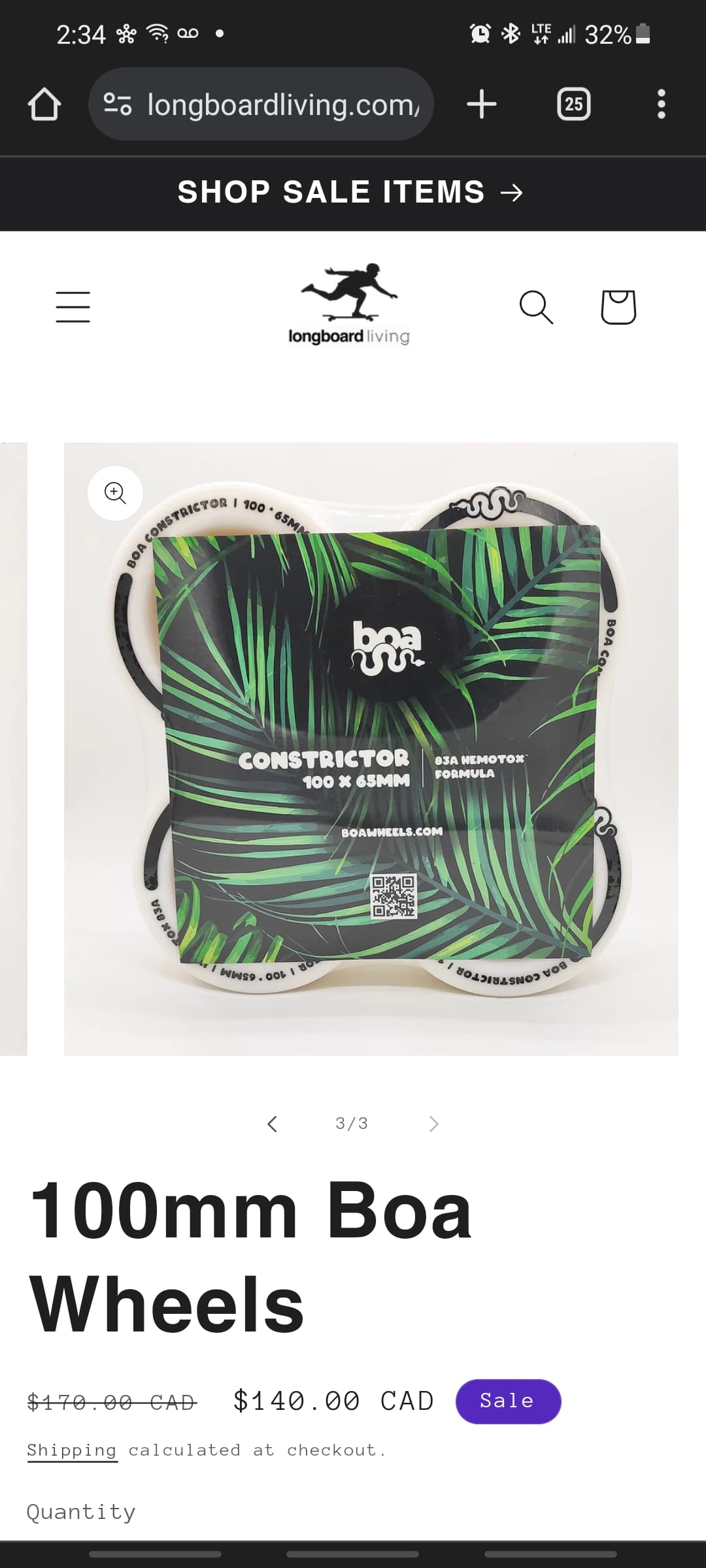

For boa’s, all the 83a are og usa wheels? No clone core 83a? Also how is the fitment and wear comparison between og and chinesium boas?

I am curious cause i see these listed at a local shop, and if theyre going to ruin my pulleys or cause issues, probably not worth, but if theyre the og that everyone seems to rave about here then i would be very curious to try them out.
my motors are a bit too close to the ground to run 86’s i been beating the shit out om my motors with eovan 105’s which im pretty sure are actually 115, cause my numbers are off on my voyager, but thats besides the point.
They are not the OG ones, those aren’t sold new. They are gone unless you find used ones. Those might ruin your pulleys.
I was hoping i got lucky and they just been in stock for 4-5 years :sweat_smile::rofl::sweat_smile:
