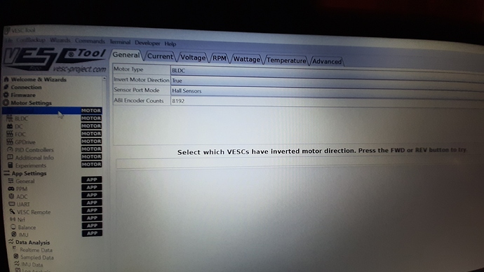

Hi Guys, I posted in the dead forum Electric Skateboard Builders Forum and thanks to BillGordon that told me about this new forum…anyway, thanks for letting me in and I hope to solve my dilemma…I fried my V2 Esc and I am trying to replace it with the Flipsky 4.20 plus but without good result so far. After the setup with Vesc Tool the board is very slow with an awful start, basically no power, no torque …very slow start and I can’t understand why… The motor are the cheap chinese 5055 sensorless but It should work better with a Vesc rather than the original esc.

Glad to see you made it over. If possible, take screenshots of your vesc settings. I ran those dual 5055 270kv from a pair of 4.12 singles before, and it worked quite well.
Hi Bill…thanks for your prompt reply !
I attached my settings…
20200206_234609|690x388
did you run the motor detection? those motor values seem a bit low…

Yes, I did…the motor detection gave me max amps of 19.50…very low…that it is why I put 25amps…does not make any sense…It has a very slow start in a Foc setup with wizard detection, then I run the motor dect in Bldc sensorless and on the ground has hiccup and need to be pushed to start to run.
hmmm… I’m not really an expert at this, but I run similar motors at about 42 amps which was what was detected, so it might be worth double checking the connections, also were there any faults in the logging?

ok guys…I put 42amps in Foc sensor less and It works much better but not as before…and most important thing the motors are really hot compared to before… :roll_eyes: :roll_eyes: :roll_eyes: :roll_eyes:
