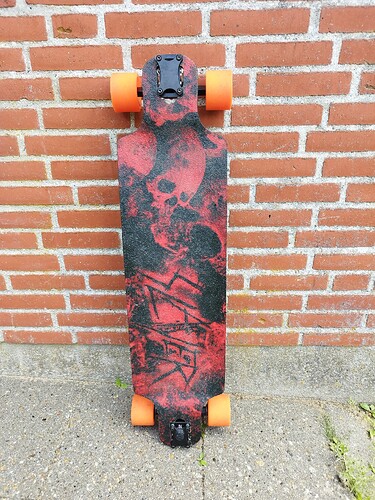

I originally didn’t plan on making a build thread for this one, but I have to because it rides so nice and I am also very happy with how clean the inside looks.
It all started when I saw this skinned and reinforced Hummie deck half complete for sale about 2-3 months ago, back then the plan was to build it out with a 3ds gear drive and 7" pneumatics. However that setup wasn’t that great in my opinion due to having too much motor bite and not much deck lean.
Then @AlexB asked in the makerx thread how the DV4S behaves with unlimited hubs, and thus the build was inspired to happen in it’s current form.
Now onto some teaser pics

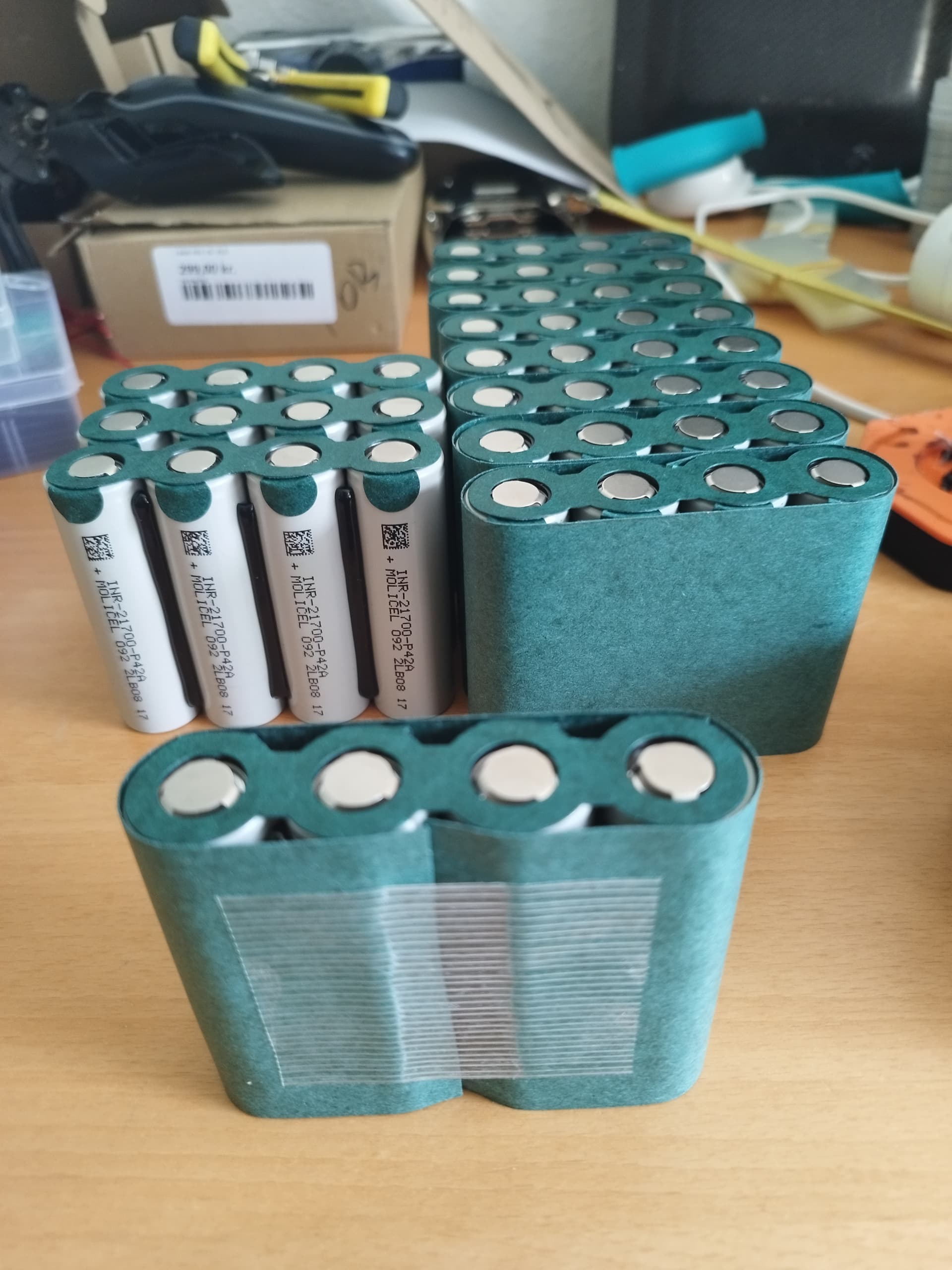

So naturally as I am a battery builder I took the opportunity to build the battery pack for this thing.
First taping / insulating the cells
The cutout was enlarged by the previous owner, so the configuration is not quite the conventional hummie config, the P groups are rotated 90°.

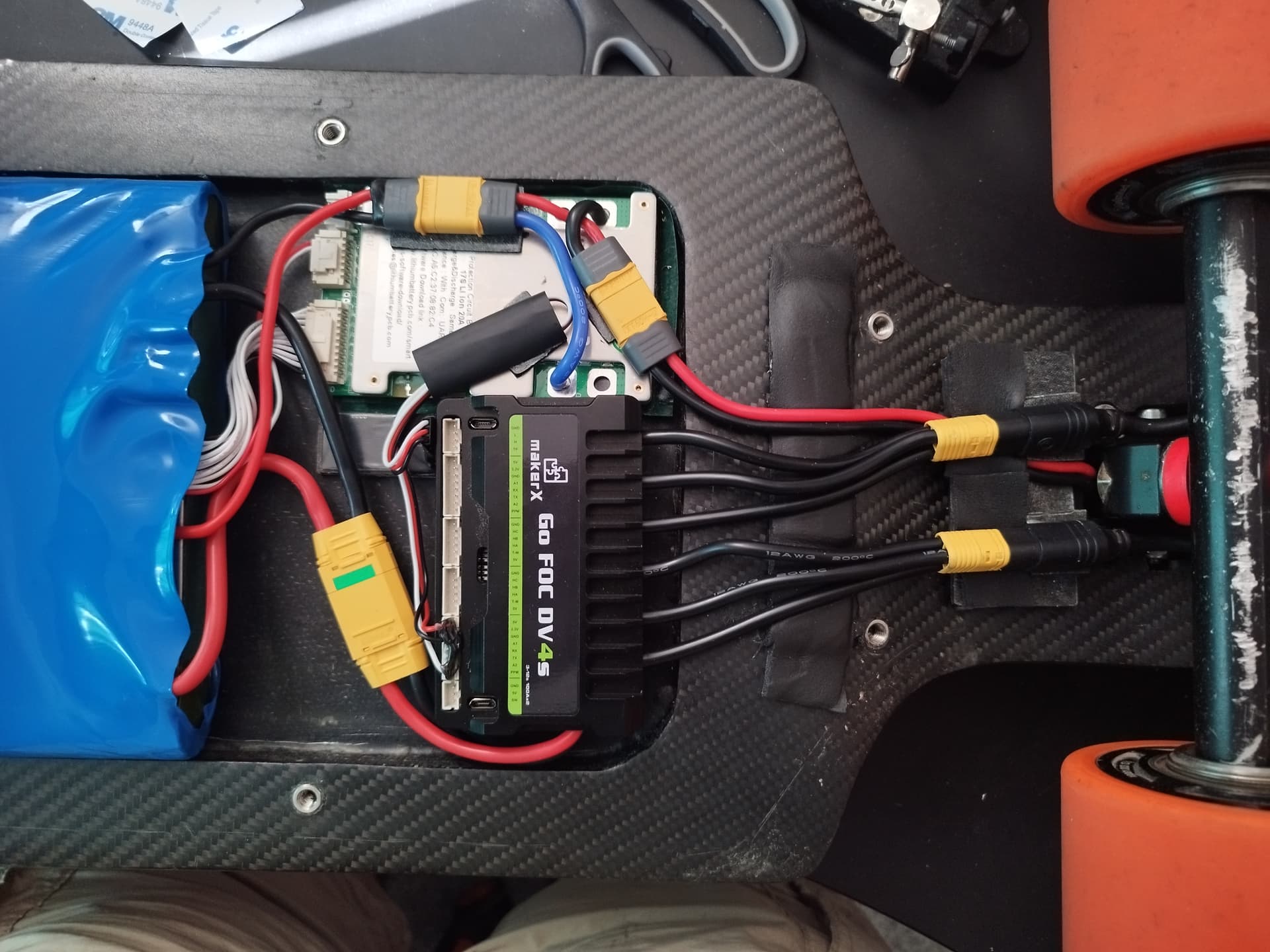

Rest of the wiring. Way too simple, no sensors, no switch (I use exclusively push to start), no Bluetooth module for now. Had one but just found out it doesn’t work.

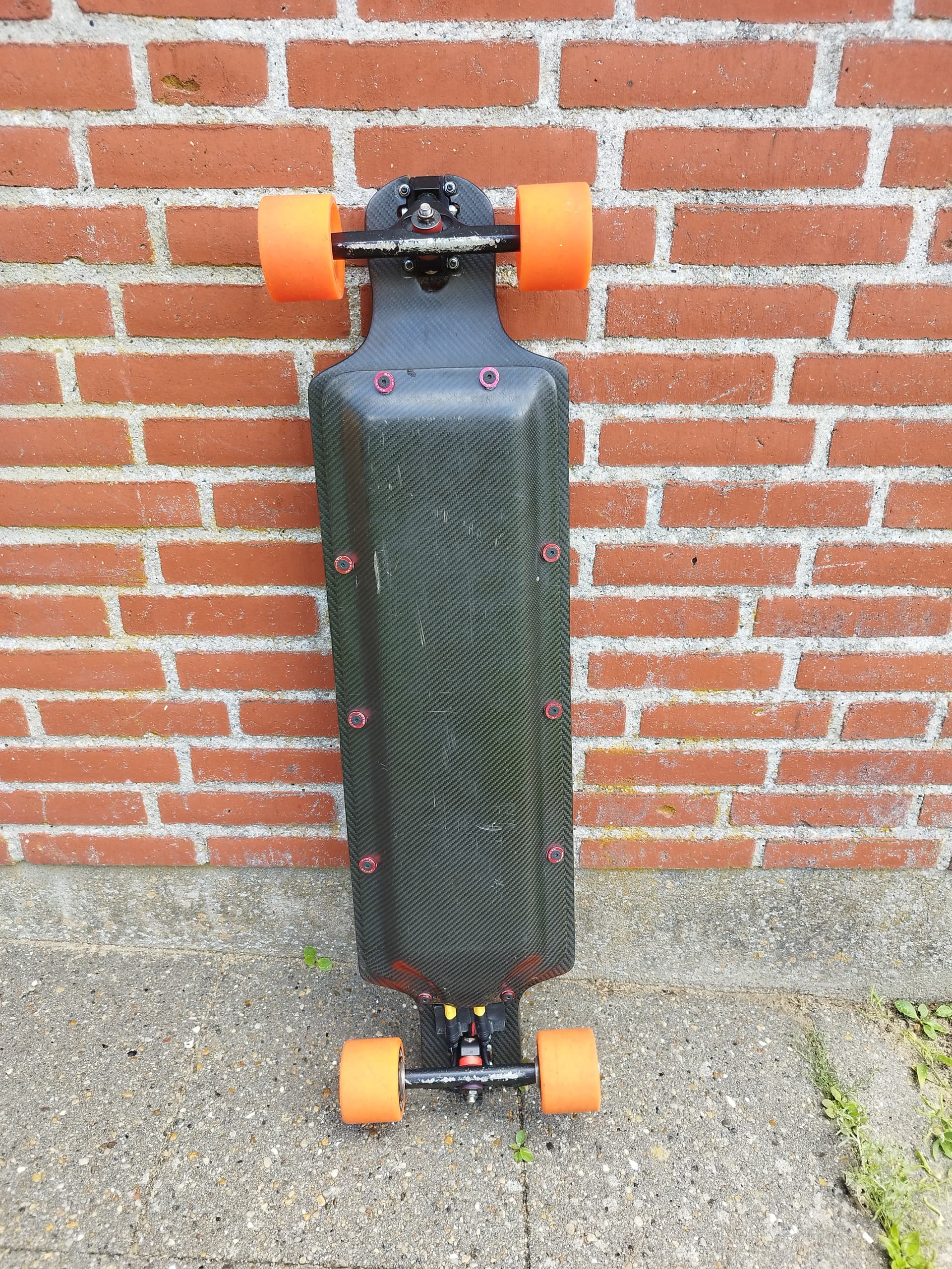

Overview of the whole belly

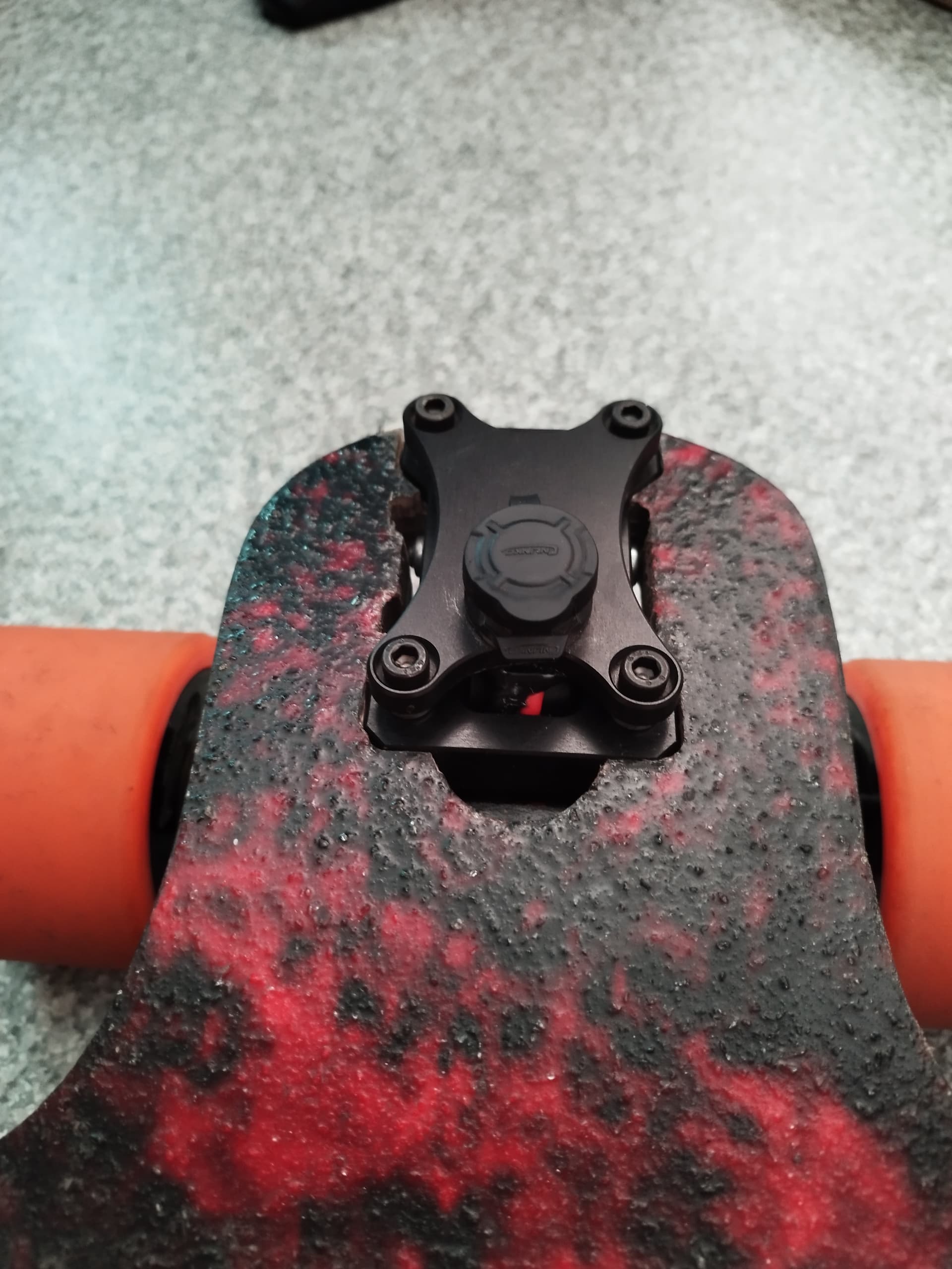

LP16 charge port on the rear anti sink plate
Now let’s talk about drivetrain a bit. The deck was cutout by the previous owner so that the 3ds adjustable baseplate sits flush once dropped through, so I ended up going with that baseplate. The ride height is okay. I would prefer slightly lower but then there’s the tradeoff of clearance which is about right at the moment.
The unlimited hubs were mounted on 10" raked caliber III hangers, and 3ds adjustable baseplates at around 43° front 36° back. These caliber III hangers are really really good. Feel much better then cal II and it’s derivatives.
In the back using Venom HPF 90A bushing, with the plug for cal III. In the front blood orange stock caliber II bushings, and a plug bushing to remove the slop. All around flat washers. It’s feels really good and lively, while getting bonus points for keeping to the orange/ red/ black theme.
And the weight is decent as well at 11.5kg or 25lbs
Regarding the VESC setup I am running 50A per motor and the moment and they feel really punchy compared to hubs, will have to see how much they heat up like this. VSS ended up working best for me, but it’s quite stuttery at 0 speed. Also I am running a VX1 with a brand new potentiometer which I’ll change out soon for something else as I don’t trust it.
Maybe VX4 with 3ds hall sensor or just plain old GT2B with a 3d printed case. I haven’t decided yet.
