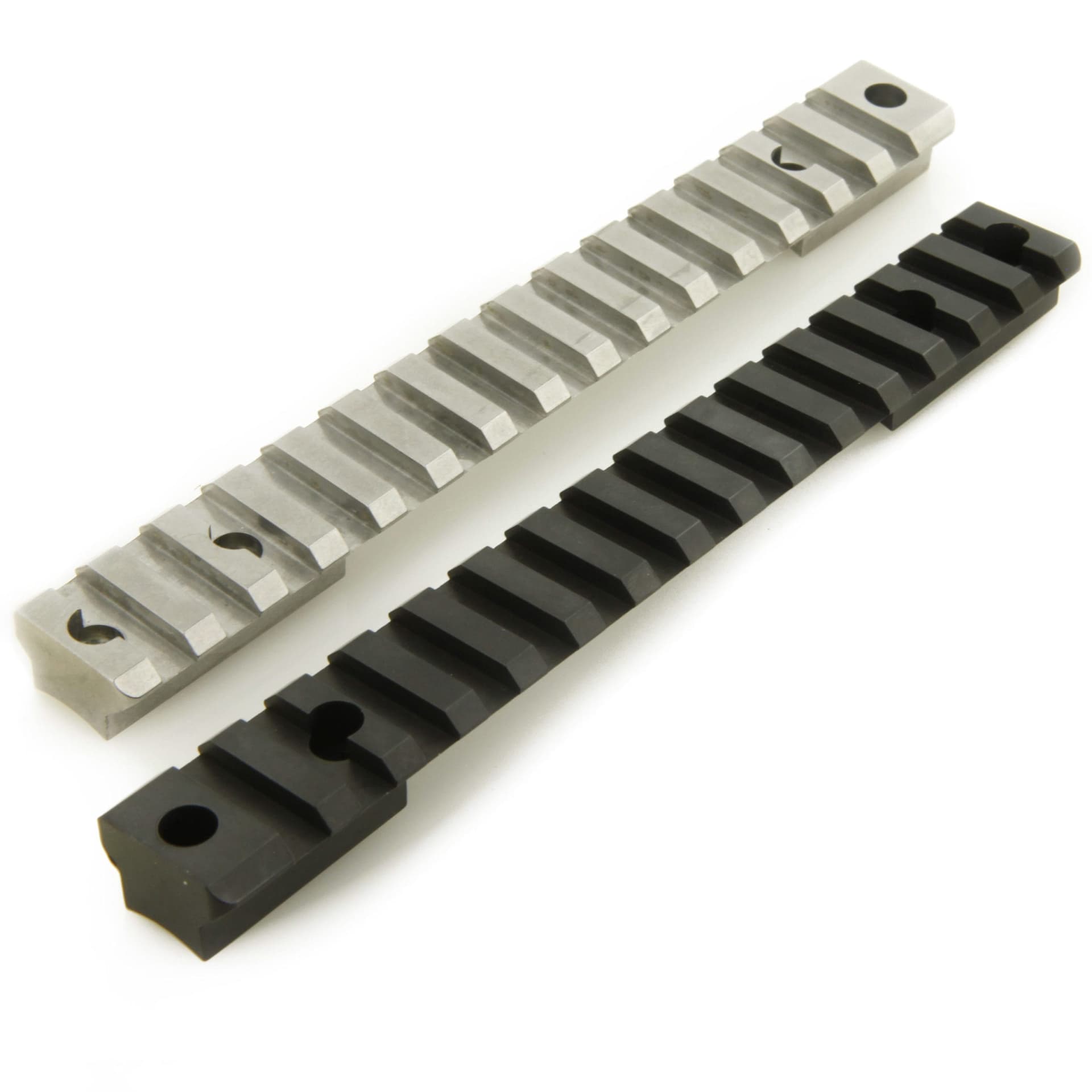

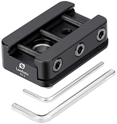

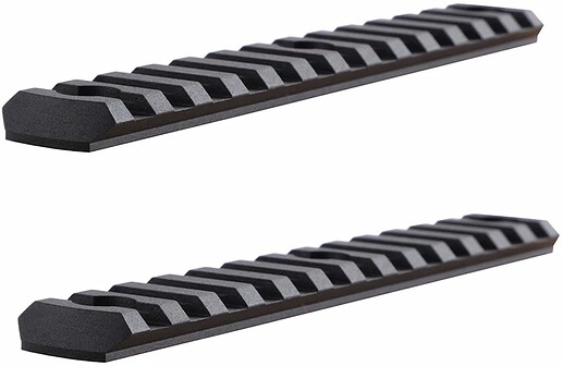

For an actual universal standard, you’d want something simple, strong, and quick.
Something like a french cleat / dovetail / picatinny rail. Mount it end to end or side to side - the orientation can still be configurable based on board flex, size/space, and construction. Standardizing orientation is unnecessary.
Fasten the rail clamp to the bottom of the enclosure. Fasten the rail itself to the board. Add rubber washers beneath the rail. Picatinny rails are already standardized, utterly proven, come in metric (the NATO upgraded version), are very low profile, and have a million parts already available in aluminum for lightweight, strong, quick attachment.
Don’t reinvent the wheel.
In particular for just the esc, you barely need strength at all. you could 3d print a rail and it’d probably hold up just fine.
