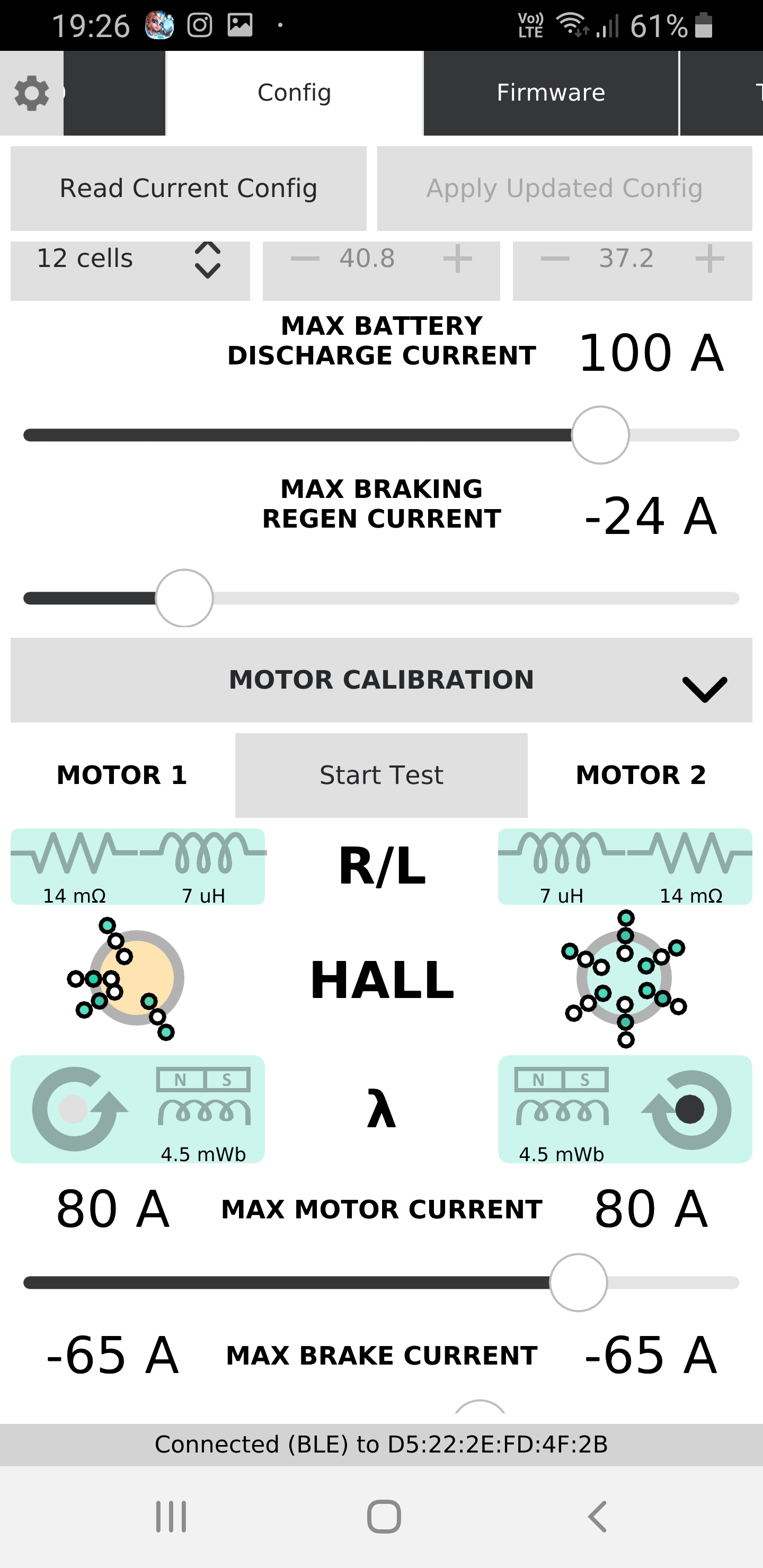

Hi guys,
So I have been using my unity for ages with 23.43fw with no issues.
I broke my own rule and updated it today to 23.46.
This forced a new setup of course, but using my s9 and laptop I cannot write settings, the apply updated config button is clicked and just fades and just sits there. Nothing is written to unity.
Anyone had this or knows a fix please?
Also tried my desktop PC, and 2 cables, no joy.
If I knew how I would go back to 23.43

For completeness, I unplugged the davega and its writing now.

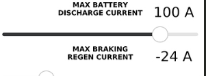

you could also try these settings though to me they seem to spell death
it detects everything just fine…the problem for me is when i press apply updated config…it turns gray and hangs there.

I have had some luck, by reinstalling the app
using unity UI on android phone.

I can connect ok…but after setting it up when i press the apply updated config button…it hangs.

I work around this by pressing apply settings and then read settings if it hangs until it actually applies and give the green ok at the bottom.
edit: It’ll take like 4 or 5 tries before it sticks.

I never found a fix, I have to unplug davega for it to take.
