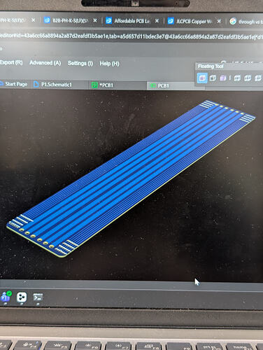

I assume the smaller traces are for sensor wires but what are the 4 small lines at each end of those?
What’s the plan here? Are you gonna make these available for purchase?
They’re gonna go in a vantablack revamp. Once I know they work I could sell them
Big traces are phases small ones are sensors,added extra holes for redundancy.
ignore the autogenerated silk screen
