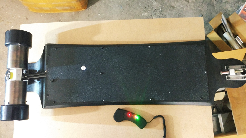

Where are the problems with your actual design of the deck?
Its integrated, right? With lid on the top?
no, lid at the bottom
StOrmBreaKer_BullyDeck 37” Integrated Enclosure | MAD Storm DD | Popoca 90mm | Focbox Unity | 12s4p 30Q you can see picture here and the bad first ride I had :rofl:
Basically all the other decks I design were based on existing mould, so you cna press them properly. If you do that the several layers will run for the whole deck length giving great properties to the board.
For this one I could not find a proper mould so decided to press a multiple layers flat, get a cube and work all the shape with the CNC. That ended up cost me plus 300 Euro and mainly not having all the layers runing for the entire length, due to the drop down configuration. If it would have been a classic deck no problem, but drop down put a lot of forces at the ends and not been properly supported by al lthe wood layers made it cracked.
Now I found a mould for it, but not sure I want to invest again to make it. For sure this time with the mould it would be pressed properly, like the ChooChoo and should work no problem. The short riding experience I had was really really nice.

oh man, I love you for doing it this way, bc lid on the top sucks imo.
yeah, that is the main problem on drop down decks machined from a block.
No way out of this, even not with carbon fibre or FG, thats for sure.mhhhh :thinking:
Maybe some kind of metal plates to strenghten the areas where the forces are the strongest :man_shrugging: …sorry, just dreaming :unamused:

yes I prefer lid at the bottom, You cna use real concave at the top. I know made a short kicktail deck that I am working on since 6 months. Need to find time to finish the gear drive for it. Deck is made and looks amazing, inspired to my favourit short deck from MADRID skate.
Yes the drop thorugh could be achieved with metal bracket but I prefered all wood. So the only way to do it properly is by pressing it. Now I found a mould nad would work but I mainly use short boards, so this one was an experiment.
