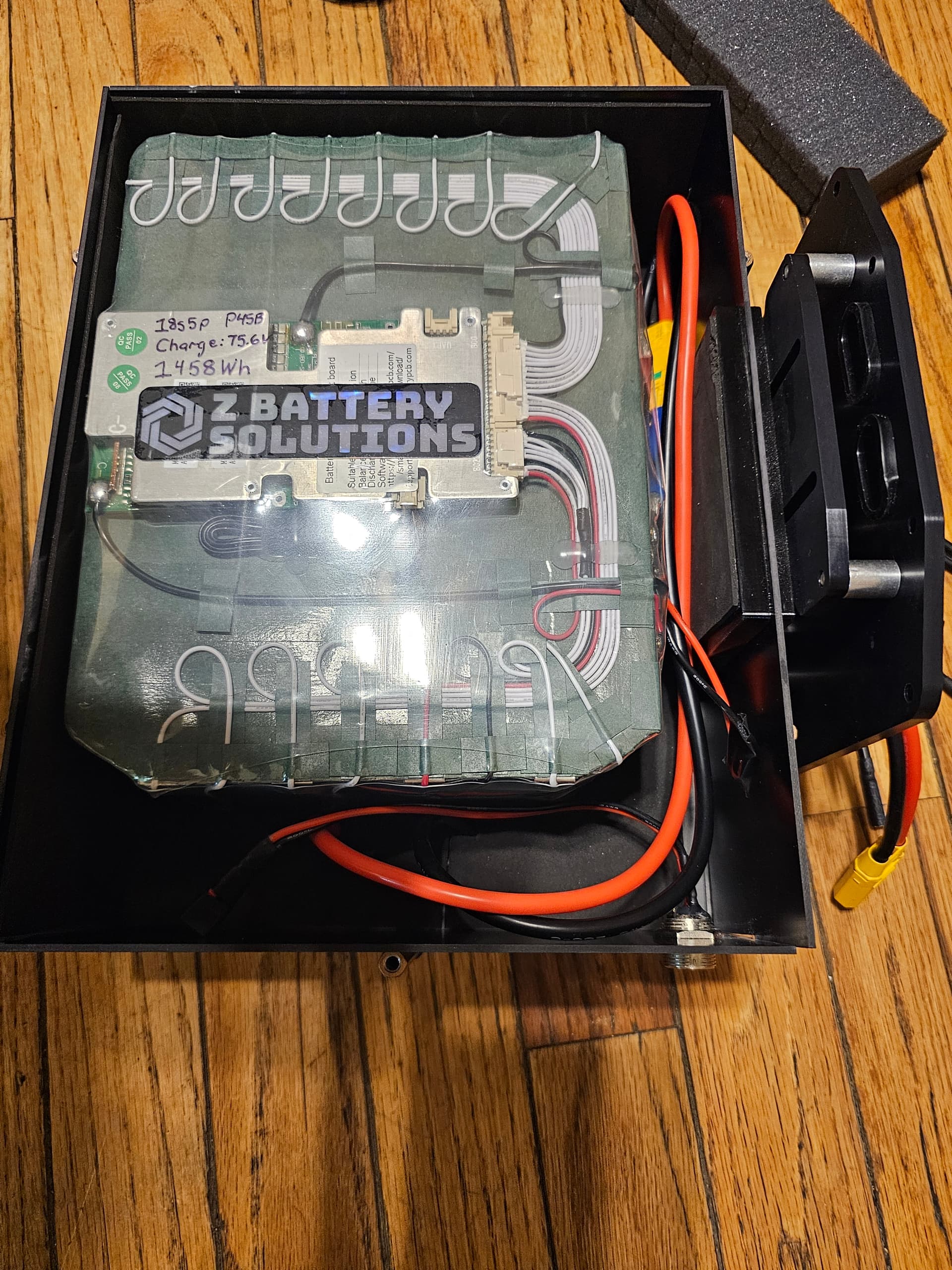

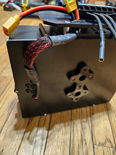

Any suggestion or input on this battery box set up besides velcro and more foam? Is the whip open in the box like this ok?
What’s your throttle and brake sensors? Not sure if i could find those in the thread
