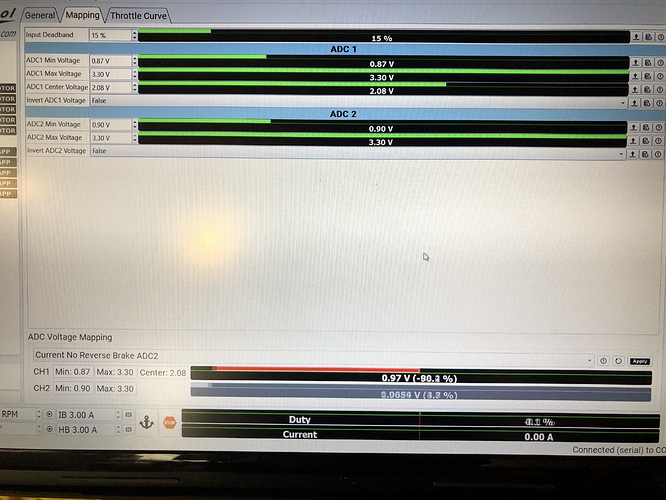

So I’m setting up my scooter project with 2 FOCboxes and am using ADC 1 and 2 with hall throttles. I have it set to current no reverse brake ADC 2, it registers my input when I go through the wizard. But it has the Adc 2 box greyed out and won’t work. (I’ve been able to use ADC 1 and 2 on my ebike so I’m familiar with the setup)After completion the throttles only working with no brake
Nevermind, I was able to re flash FW and now it’s working
