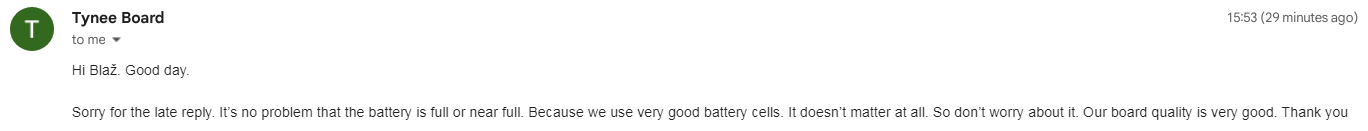

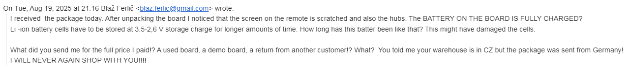

It came wit a fully charged battery and a few scuff marks on on of the hubs/rims. And the protective cover on the remote screen was also scratched up. I am wondering if it was a return or someone in the warehouse played with it. No Straight answer form Tynee. Just bullshit. I will not shop with them again.
My e-mail:
the response:
Take that as you will.

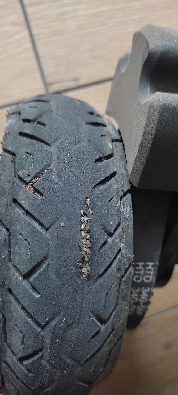

My tynee explorer is a lot of fun, specially after changing the crap original bushings.
Now I can carve hard - its kind of surfboard-feeling.
Sadly, the wheels aren’t build for that. After 100km I killed the first wheel.
Are there any tyre recommendations? What dimensions should I look out for? Are there any tyres that are more resistant to hard carving and drifting? The strain on the tyres is already enormous.
Congrats on wearing your first set! As someone who also likes to carve a lot, tires are a wear item.
Esk8 tires are mostly standard sizes (except the ones that aren’t)
Undoubtedly the best tire for the Tynee is mboard’s nova, imo. You’ll feel a massive difference when you upgrade, and they last a long time. I did a short writeup on them here MBoards NOVA Tires Discussion - #6 by tuckjohn
They’re also what I was riding when I did this
Thank you. The Nova tires looking great, specially the wider contact patch. Unbelievable, that most of the esk8-manufacturer still use round scooter-tires.
But ordering from the USA is too much hassle for me. I don’t want to have to deal with customs again. What’s more, the 4 tyres cost USD 150 including postage, which quickly becomes USD 200 after customs and tax.
To be able to ride again quickly, I ordered 4 Hota 6-inch 150x50 tyres from China (22USD). They should be here in about a week.
I may have to break the habit of letting the tyres break out in the turn. That was never a problem with PU wheels. A harder rubber compound might also be a good idea.
I am still looking for durable tyres in Europe.
After 400km with my explorer I killed 6 Wheels and 4 tubes. Are there any other advices for durable wheels? It kills the fun, if you have to change a tire every second day.
My PU wheels lasted 6 years…
I’m on holiday in france an run out of spare wheels :-1:
Pneumatic are always going to be wear items, especially if you ride hard. NOVAs are the best everyday tires by basically every metric imo
Thank you. But then, unfortunately, the purchase was a bad buy for me. As comfortable as the pneumatic tires are, investing €200 in tires (nova incl. shipping) every 380 km (10 days of vacation) is unacceptable to me. I will look for suitable solid rubber tires.
Note that my NOVAs wore so quickly because I did nothing but racing and carving.
I know more normal folks that have ridden them for 2000+ miles without issues
