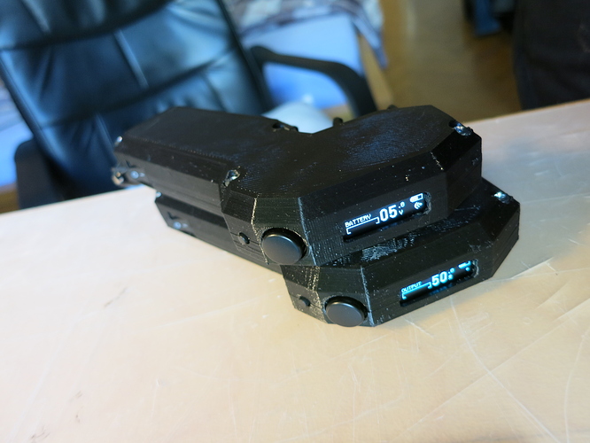

This topic is about a custom remote I made. It’s an improved and customized version of solidgeek’s remote and ervinelin’s remote.
Features:
  • Trigger style remote with long stick travel.
  • Cheap to build, with easy to find parts from aliexpress.
  • OLED display showing board battery voltage and distance remaining.
  • Battery voltage sensor in the receiver that can measure 0 to 51v.
  • Automatic distance calculation based on LiPo or LiIon discharge curves.
  • Two PPM outputs for connecting regular ESCs or VESCs.
  • Dead man switch that prevents accidental throttle.
  • Setting menu to set display rotation, Throttle and brake endpoint, Smooth braking and acceleration, and other settings.
  • Cruise control with smooth acceleration.
  • 5 meter RF range.
  • RF collision avoidance when using multiple remotes, autobinding algorithm. Selectable RF channel.
  • Carefully written and tested code with many fail-safes in place to avoid any injuries.
  • 20+ hours battery life on one charge.
  • Internal micro-usb charger.

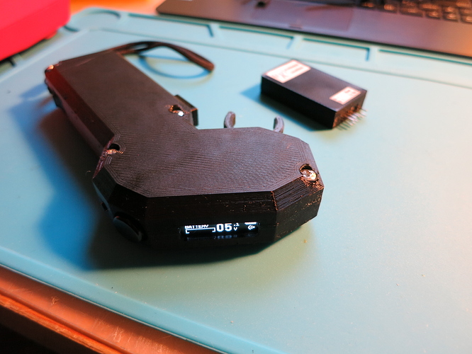

Build Instructions
Making your own should be pretty straightforward if you follow the links above and look at the pictures. Nonetheless here are some instructions and tips:
  • Get all the parts from the parts list.
  • 3d print the plastic parts. Some tolerances are quite tight and important. Make sure all the mechanical parts fit and move well. Adjust your slicer’s horizontal compensation otherwise. Some parts also need to be rotated.
  • Make the PCBs. Use small thickness PCBs, I used 1mm ones. The PCBs are one sided. I etched them myself, so if you plan on ordering them please double check that there are no problems such as missing holes, missing masks, problematic silkscreen, etc.
  • Upload the firmware to the Arduino’s using the Arduino IDE. You can do this easily without soldering by holing a pin header at an angle on the programming pins.
  • Solder components to the PCBs. All components should be in the parts list. The NRF module is extremely close to some solder joints. Make sure it’s insulated properly with double sided tape. Make sure the Arduino board sits directly on the PCB; if you use a pin header as a spacer, the module might not fit correctly.
  • Finish assembling the receiver by placing it in the case and screwing in the 4 screws.
  • Place the LiPo charging board in the transmitter and solder the 4 wires to it. You can use spring contacts for the battery or carefully solder the wires directly to it.
  • Solder the wires to the rocker switch, bend the contacts of the switch so they don’t touch the LiPo charging board. Insulate the switch so the contacts do not touch the PCB which is added next.
  • Place the assembled transmitter PCB in the remote and screw in the 3 screws holding it.
  • Attach wires to the Hall sensor, OLED screen and the 3 switches.
  • Glue in the Hall sensor, OLED screen and the 3 switches.
  • Glue the dead man switch cap to the micro switch.
  • Place the bearing inside the trigger plastic part, use a bit of glue on the sides to hold it in place.
  • Solder all the wires to the square pads on top of the PCB. Refer to the schematic+board for the correct connections.
  • Power it on for the first time and check that the display and buttons work correctly. Set the active page to “output”.
  • Place the magnets inside the trigger part. They need to be in opposite directions and placed correctly otherwise your throttle will be in reverse. Check that you placed them correctly by checking the screen. Adjust the position of the magnets so the throttle response is roughly linear (don’t worry about the endpoints yet). For 5*8mm magnets, they should be as high as possible.
  • Place the lever and spring and make sure everything moves smoothly. Use a bit of glue on the part holding the bearing.
  • Go to the settings menu and calibrate the throttle min/center/max values. Adjust the position of the magnets if necessary.
  • Place the final top part and screw it in.
  • You’re done. Double check every function. Your safety depends on it.
