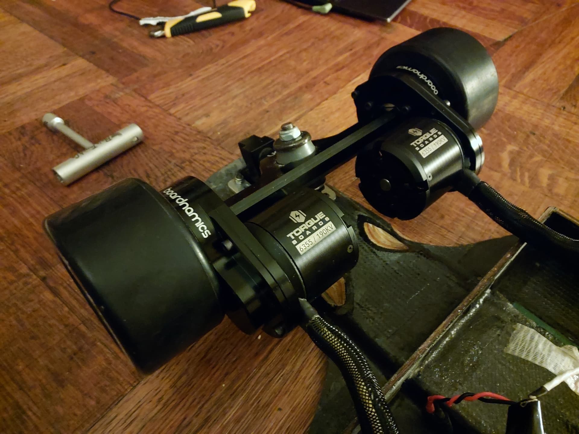

Drives are sorted. Retaining compound on all the screws, threadlocker on all the gear teeth, a light coating of red n tacky between the motor shaft and pinion, and 2 papers worth of space between the inner and outer housing cases.
Also wanted to share a hack for those too lazy to get circlip pliers: you can get them off by bending out the prongs of a pair of tweezers, and then forcing the tweezers apart with regular pliers. Guaranteed to work by at most the 14th attempt.
Had to take care of a scraping noise inside of one of my motors, turned out just to be the end of the sensor wire sheath being a bit loose.
