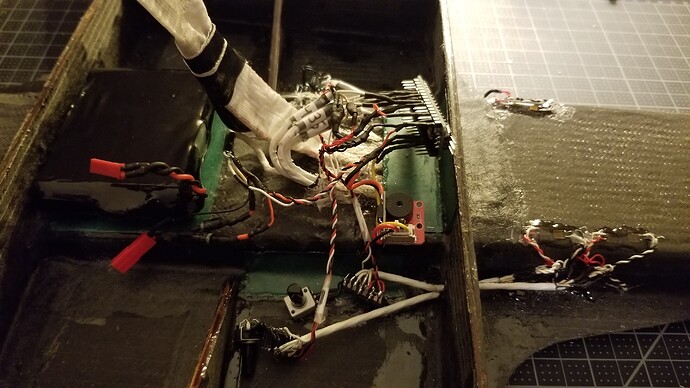

Been a long day but I have the control system circuitry fully assembled. Sensors, arduino, uninterruptible power supply, and piezo buzzer (to indicate armed/disarmed). Pending some multimeter checks to try to make sure it won’t set itself on fire when I plug it in, I’ll start testing each of the sensors tomorrow.
Not sure what to make of today, pretty bummed tbh. Of the sensors (0 through 5), #0 and #3 were responsive, the others output 80mV at minimum gain (like normal), but were not responsive to gain adjustments or weight. Later on in the day as i made adjustments, number 3 stopped working, number 0 became erratic, and the rest began to output zero as if they were disconnected?
The main difference from before is that the amplifiers are now running on 5V from the Arduino regulator instead of 12V from a battery. I started off by powering the gauge bridges directly from that 5V supply instead of the amplifier’s internal 5V reference like it had been before, but since I had 4 guages unresponsive I decided to change it back. I mistakenly connected the 5V reference to the 5V supply, tested it, I realized my mistake, fixed it and tested again. It was at that point that I started noticing with the erratic behavior, so I’m concerned I fried something I guess? I have 1 spare amplifier from the initial test that i could sub in.
Check the resistance over your bridge (w/ disconnected amplifier)
Getting 350ohms over in or out pins should indicate that the gages are at least not fried.
Sorry it took so long for me to write back. TBH I had some problems with getting motivated to work when I realized that I’ll need to wade ass first into some headachy troubleshooting of black box electronics.
To recap, after installing all six sensors, #0 and #3 are functional and the other 4 are unresponsive, they only produce the 80mV rest voltage and their output does not change when adjusting the gain. After finding this out I realized I may have made a mistake in how I wired the power supply for the amplifier chips, then changed it back, but that didn’t fix anything. I said in my last post that the functional ones later became erratic, but I would like to strike that from the record now, because they have been fine today and I think I just had a spotty ground connection to my meter last time (lol).
All of the bridges are 350ohms to within a few tenths, which is as good as my cheap meter can tell me (they’re highly consistent though, all have the exact same reading). I took the non-responsive #5 sensor, and swapped out its amplifier chip for my spare one, which was confirmed working back when I used it in the first successful sensor test. The spare chip was also not subjected to whatever wiring errors I made during the first pass of setting up the 6 sensors, but it was still unresponsive after being installed in the #5 location. I confirmed with my meter that the chip is being fed 5 volts, it has a ground connection, the top of the bridge is connected to the 2.5 volt reference supply on the chip, the middle points on the bridge are at 1.25 volts, the bottom of the bridge is at 0 volts, and the gain potentiometer is working correctly. There are no shorts to 5 volt or ground on any of the pins when the system is powered off, either. And all of these readings are exactly the same on the functional #0 sensor. Ugh.
So I asked myself the all-important question, “how would I have borked this up if I were a mathematically optimal idiot?” and then tried switching the pin connections for the left and right sides of the bridge. After I did that to the #5 sensor, it exhibited the weird behavior (that I had seen before when trying to set up the initial test sensor) where I can set the gain such that the resting output voltage is large, and then application of weight to the board results in the output voltage decreasing. My guess right now is that this implies the bridge is unbalanced or I hooked up something in it backwards somehow, does that sound right to you @dani ?

Here’s a close-up of the #5 sensor array. Top of the picture is tension.
When the twisted wire pairs come together into solid black, red, and white pairs, they correspond to +Vin (red), -Vin (black), +Vout, and -Vout (both white) in this diagram. The white pair that comes from lower left to upper right in the previous picture is supposed to be -Vout and vice versa.

It’s hard to see them in the picture. Can you also do a zoom out and identify the directions of the gages?
If the top two are tension they should be on the opposite diagonal sides of the bridge (this might be your issue)
