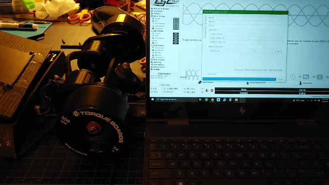

It’s alive. IT’S ALIIIIIIIIVE!!!

Thanks! I assume the half second of thinking that something shorted when the detection starts is a universal experience, yes? :joy:
100%
welcome to the club :slight_smile:

I got the board running pretty good but there’s a few action items left:
  • While the way I use my body is very important in controlling the tendency for the acceleration to surge (my mass and the stiffness of my legs are part of a mass-spring system along with the board’s control system, and e.g. going limp makes the board go crazy), there are still probably ways to help damp this in software “a la d-term”. I’ll keep testing.
  • The amplifiers appear to exhibit a kind of settling, or drift: if I lean forward for throttle for an extended period of time, the system “gets used to it” and I need to continue leaning further and further forward. Gets pretty annoying. I think that I can patch this in software as well.
  • At the end of the day I discovered a crack in the glue joint holding the retaining ring that the enclosure cover screws on to (!!!). I done goofed here, I kind of rushed through that part of the structure. I will be re-gluing and adding mechanical fasteners.
