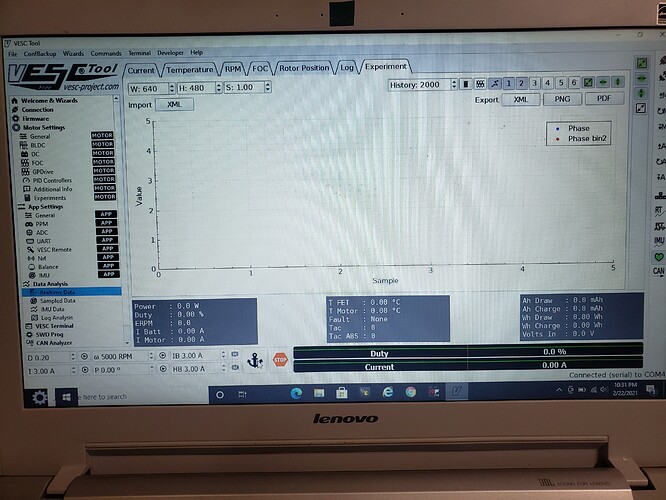

I can’t get vesc tool to plot properly. It’ll give a single point of data then nothing else.

Try setting AppSettings > PPM > General > Control Type to Off and see if the plot comes on. That’s what I need to do to get the arrow keys to work. Also rebooting the ESC and the tool isn’t a bad idea.

@b264 I’m at this point, when I hit the anchor I get a very quick blip of hfi noise, then nothing. It doesn’t stay making that loud noise for more than 1/10 of a second. I can’t get any plots on the screen, any ideas?
Click App Settings > PPM > General and change Control Type to Off. Then write the settings and click the picture of a keyboard on the right side.

Now that I got these 6380 kind of working on hfi and am armed with your knowledge on how to plot properly, I might give it another go.
