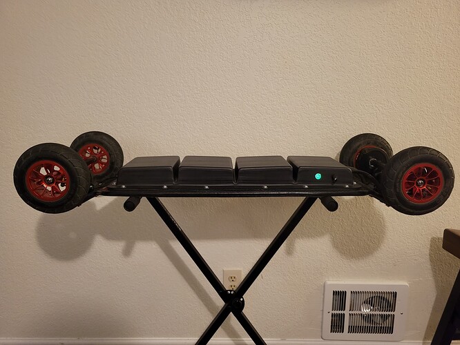

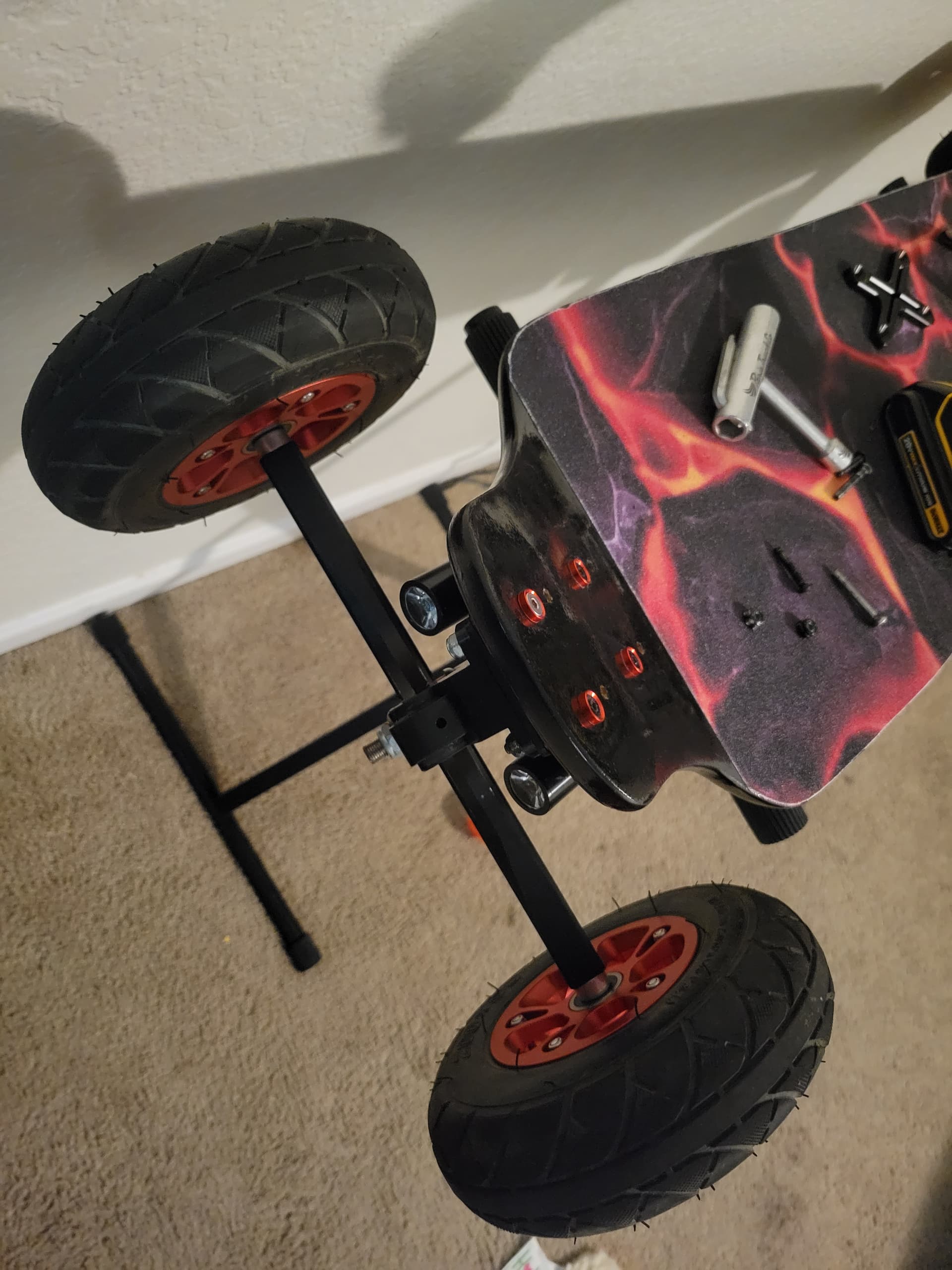

Alright, so I’m back to the drawing board for a bit of a different reason. I had my wobble issue sorted after some angle adjustments and tire changes, but now after switching to my tomiboi deck, the BN270s have a pretty unavoidable wheel bite problem.
I can adjust the angle so that turning is basically impossible and the wheels don’t bite, but then turning is basically impossible. My current thought is to get a set of @Savage1 trucks next time they release. As I understand it, the TKP design helps to extend wheelbase and prevent wheel bite. Am I correct?
Any other suggestions are greatly appreciated. Ideally I want some trucks that are maneuverable at low speed as well as stable at high speed, and wide enough not to bite the deck.
After spending a lot of time playing with different extensions and adjustments with my new 3links attempting to adapt them to the flux I’ve come to the conclusion that it’s just not the deck shape for them. I can get it to work with a waterborne extension but then I get a very divey turning style.
I then went out on a ride on my normal flux on matrix ii. It’s so carvy and great the way I’ve got it setup (for me) that I think they’re just the best style truck for angled decks personally. Other options will work but we’re adapting them to do so and not really optimizing the setup imo.
My setup for my 150ish pounds with full gear on that I love is.
Matrix II trucks
Yellow bushing front
Orange bushing rear
Rear truck dewedged about 10degrees with a 3D printed wedge.
I’m able to pretty comfortably hit 35-38mph and still have good low speed carving. No wheel bite, no problems.
The board carves great and feels fantastic.

So I’m planning to get a set of Luna 350 hangars to use with my existing BN adjustable baseplates. Seems like the cheapest fix I can find that will work with my drivetrain and deck. Plus I get to stick to RKP which I have no complaints with.
If you want to get rid of the BN270’s lemme know!
I’m selling the hangars. I can give you a deal on em if you’re interested!
Yeah shoot me a DM, I’m interested. Need to start compiling parts for the vanguard 42 build
Maaan, you both made and ruined my day. I didnt know those luna 350s were a thing, theyre exactly what i want. Right after i bought a set of BN280s as a step from my BN270s too lol, sounds like i gotta sell em both and go luna.
Yeah, I wasn’t that interested until I realized they fit my baseplates and drivetrain. Seems like the easiest solution. Plus they’re some sexy hangars
