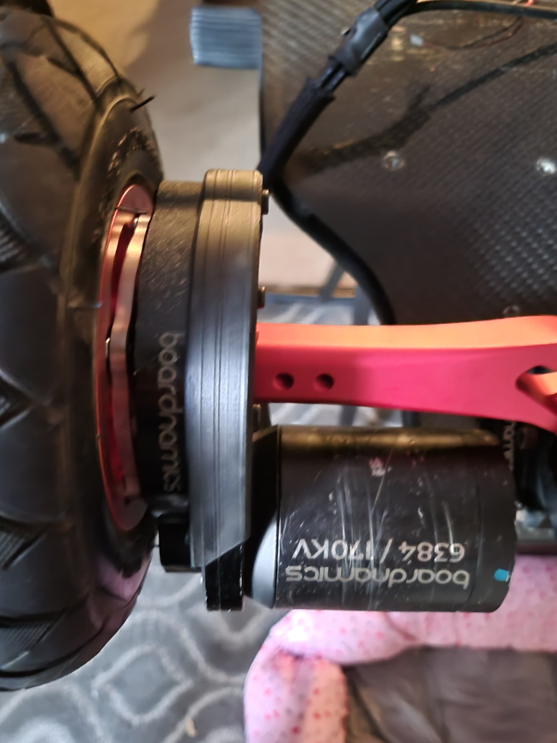

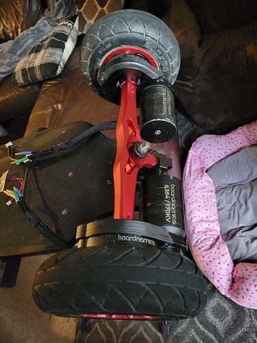

Got everything put back together with the modified wheel adapters. This may be the first BN m1-AT setup on Luna 350s(?)
Just need the loctite to cure, and once my brake lights come in the mail I’ll plug em in and get everything mounted again. Haven’t ridden in over a month, can’t wait to get back on the road :sob:
