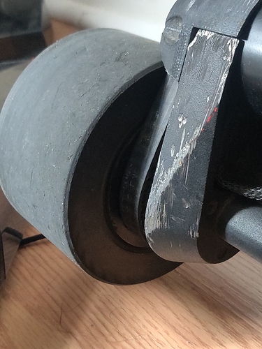

Not much to get from this picture really but here’s my setup. They’re linked to the ABEC 107s
Whats the gear ratio on your drivetrain?
That pulley looks small for those wheels, iirc the dickyho kit is 15/36. if those are the 270KV motors that might be a bit much for such a large size wheel. I think he does have 180KV versions which would probably be okay at that ratio.
I haven’t counted :/. I’ll start counting when I get home later today. It might be the 15/36 that came initially with the kit, if those pulleys fit in the ABEC 11s 107mms wheels then I wouldn’t doubt it. Here’s a close-up. They do seem like small pulleys but again I’m new into the belt world. 255mm belts from what I remember
that makes sense to me, especially if the gearing is mismatched. I was talking to another guy that had a similar setup to me and he was fine, but he said had wheels like 30% smaller or something like that. The fix is either smaller motors or bigger pulleys then?
Also, breaks are super weak. I imagine that’s a pretty normal feeling going from hubs to belts with no idler/tensioner right
I’m guessing its 15/36 I could be wrong, I think 13/36 was also an option, but either way with the 107’s your top speed is at/over 40mph. And I’m guessing you’re not getting anywhere close to that due to the heat and inefficiency.
The brakes sucking is a result of high KV and the huge wheels. A higher top speed ratio means less torque, witch is accel and brake torque.
I would check the order if possible to see what you purchased, if not check the ratio and then see if you can make any sense of it based on your speed’s with the eskate calc. Im gonna guess 97mm is the max wheel size you should use with that ratio or jump up to a 40/44 tooth wheel pulley.
Yup, I counted 35-36 teeth on the wheel side.
Ran some numbers. Gonna go ahead and get a lower kV motor vs a new pulley, be best for top speeds then. Little concerning hitting 32 mph on Cloudwheels if I ever get em but we’ll cross that bridge when we get there.
