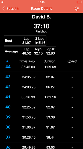

Went for this season’s first winter track session. The previous two seasons have been frustrating as I havn’t been able to match that golden best lap time from 2020.
I have been tweaking and adjusting the setup and practiced on the track again and again. But just havn’t been able to find the lap times from that one session in 2020.
But today it only took me 15 min. and I was under the 2020 lap time four times. I went from 32:32 in 2020 to 31:97 today and I even had a skip with the rear wheels in one of the hairpins.

With this standardized track I could compare myself to all the other racers out there. I saw that there were people out there who was faster than me. So I saw that it was possible to go faster, and that forced me to push harder. If They can I can! I also immediately felt that racing the T-Race track would make me better. Both as a racer and overall riding my boards.
On my winter track I could accelerate sooner and break later. Also had a better feeling of how much I could push the grip.
There are no doubt on my mind that it have been T-Race that have pushed my limits in a way “just” practicing on the track couldn’t.
