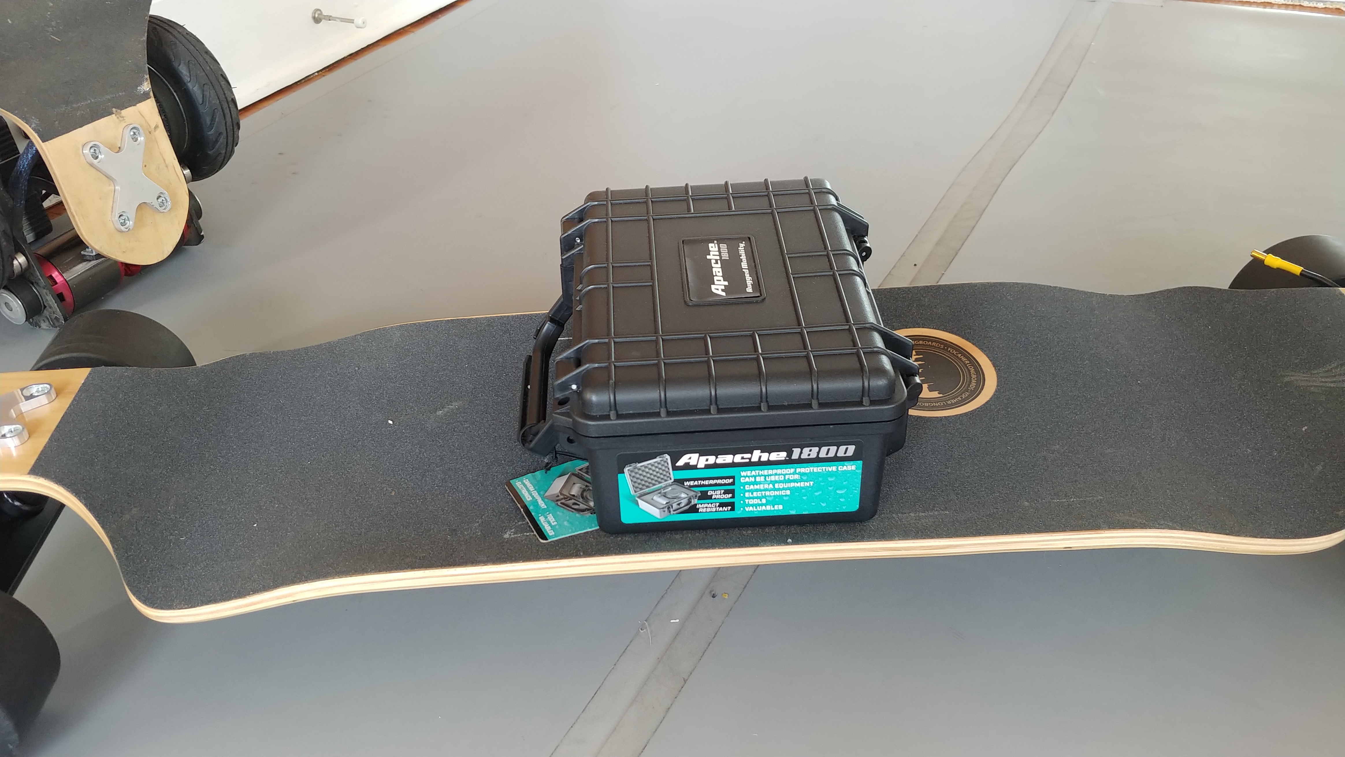

So i have this idea for a future-future build… currently making a super low rider 107 on a 1.5" drop deck so that means not mounting below, so for this Ill be using the apache 1800 which is a perfect size for a simple build… can easily fit 60 cells and perhaps more if you get your geometry skills on…but the the bigger the battery the less space for electronics especially if you want hard wired lights and other fun stuff…

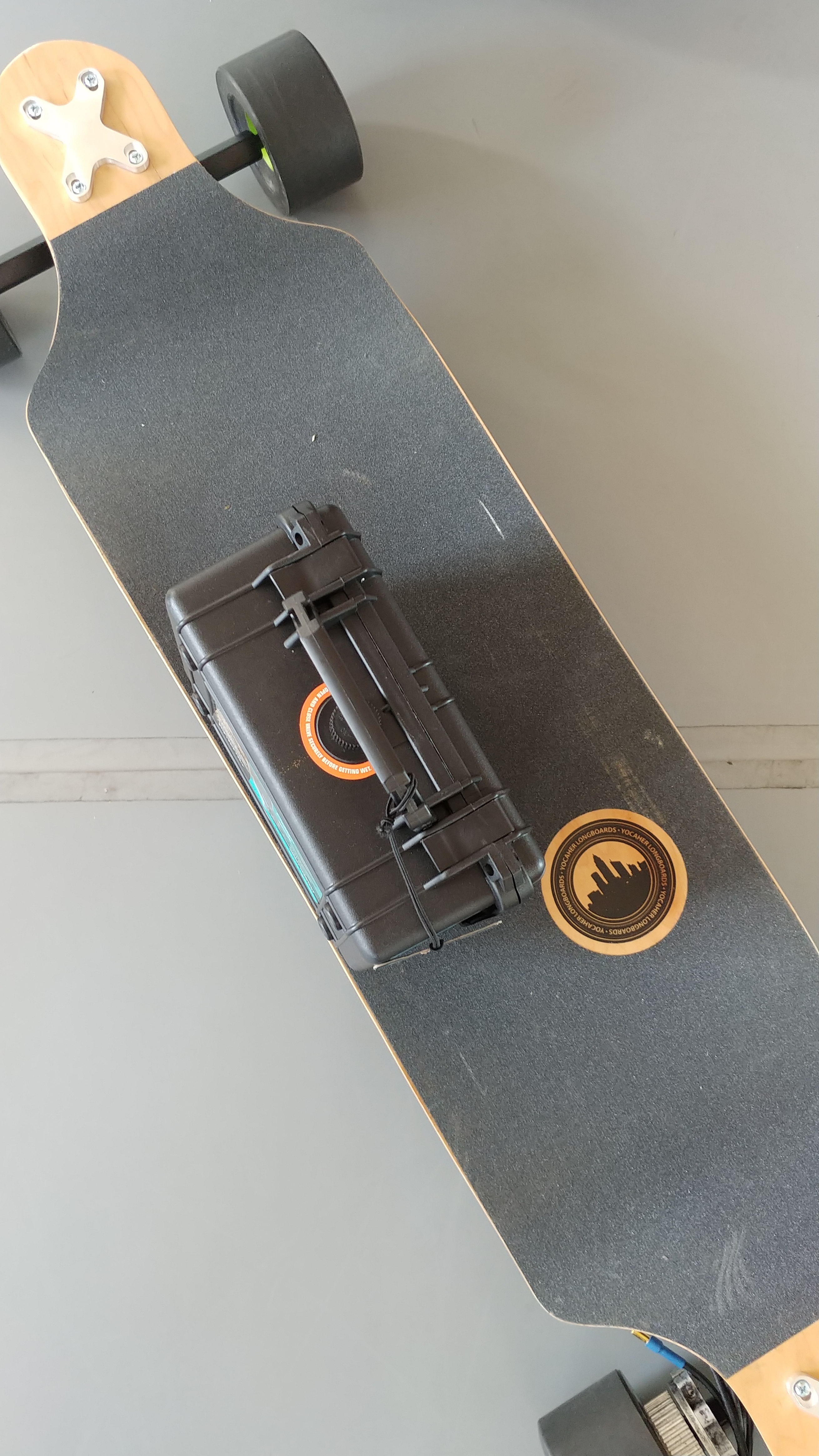

heres how the box looks now…small, discreet and doesnt take up to much deck space

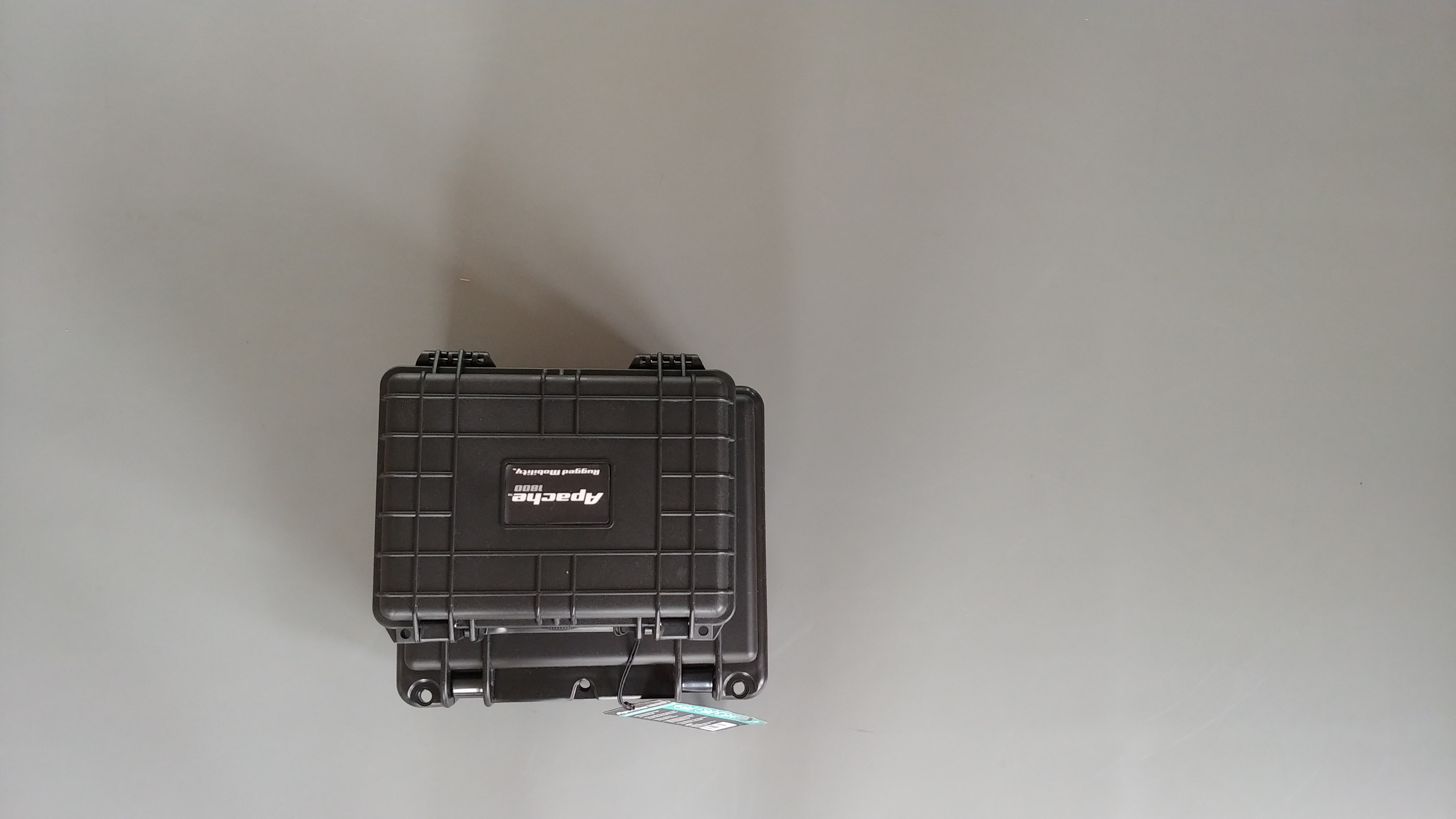

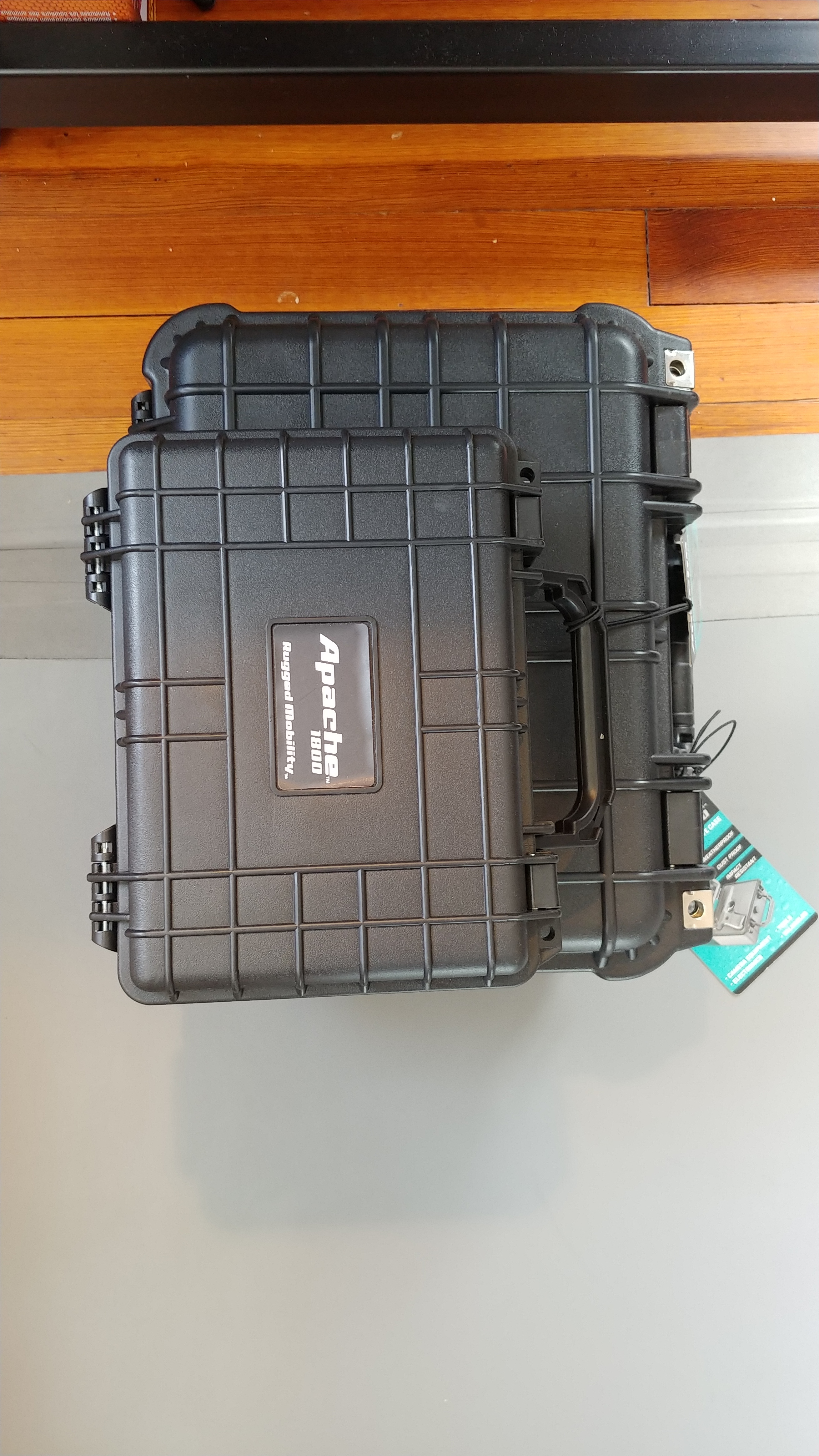

so the options are a larger case… but the next size up from the 1800 is a 2800… which is fucking obnoxious huge, kills deck space, and if you even tried to mount it the other way the sides would be hanging off the board and that looks stupid as well…
both stacked so you can visualize size diff…
so here comes the DIY thinker in me…what if…what if… there was a way to maintain the small profile of the 1800 but double its space with only a smaller amount of vertical space consumption??

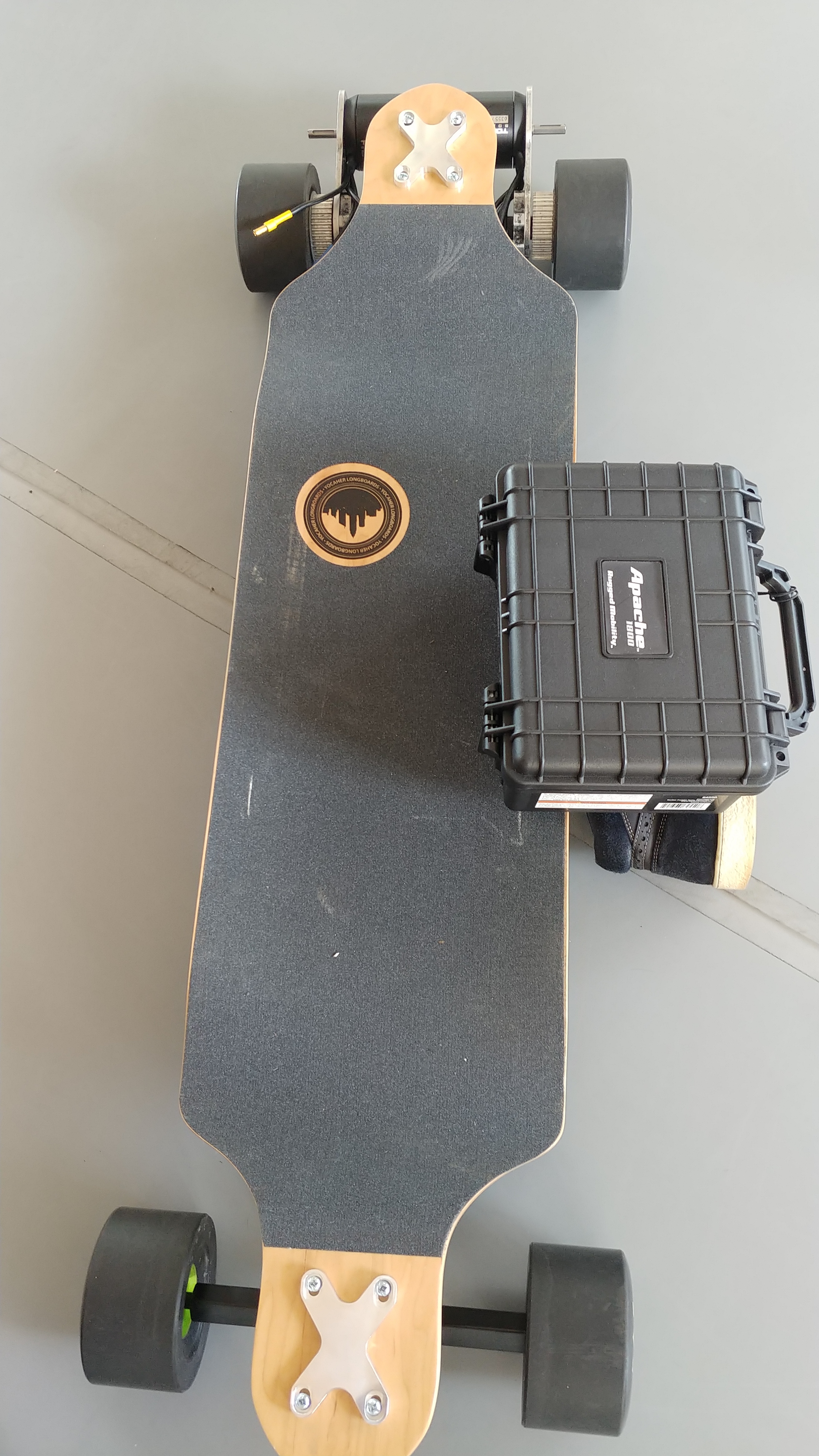

if you stand the box on its side its only half the deck width… but we still need access at some point in time right??
so what if…what if…lol… you have 2 boxes with top lid facing inward… and then my idea is to have a hinge of some sort attached to the bottom of the case and deck of the board…that way when you need to open the cases they lay flat just off the edge like so…
obviously we could easily just forego the hinges all together and just velcro the shit out of the boxes and have a strap the wraps under the deck and back round the top, which I would be using some sort of strap anyways… but I guess part of me wants the cases secured to the deck with hardware to prevent anything…anything…

I’m imagining your idea but butterfly door style
and loving it.
You could also do a pc cover style shape (upside down, squared “U”) that slides over the case/cases.

1 case is less holes than 2 cases. So less things to go wrong
i dont disagree but if there was a box size in between the 2 it would be perfect… but theres not and the medium is just too large

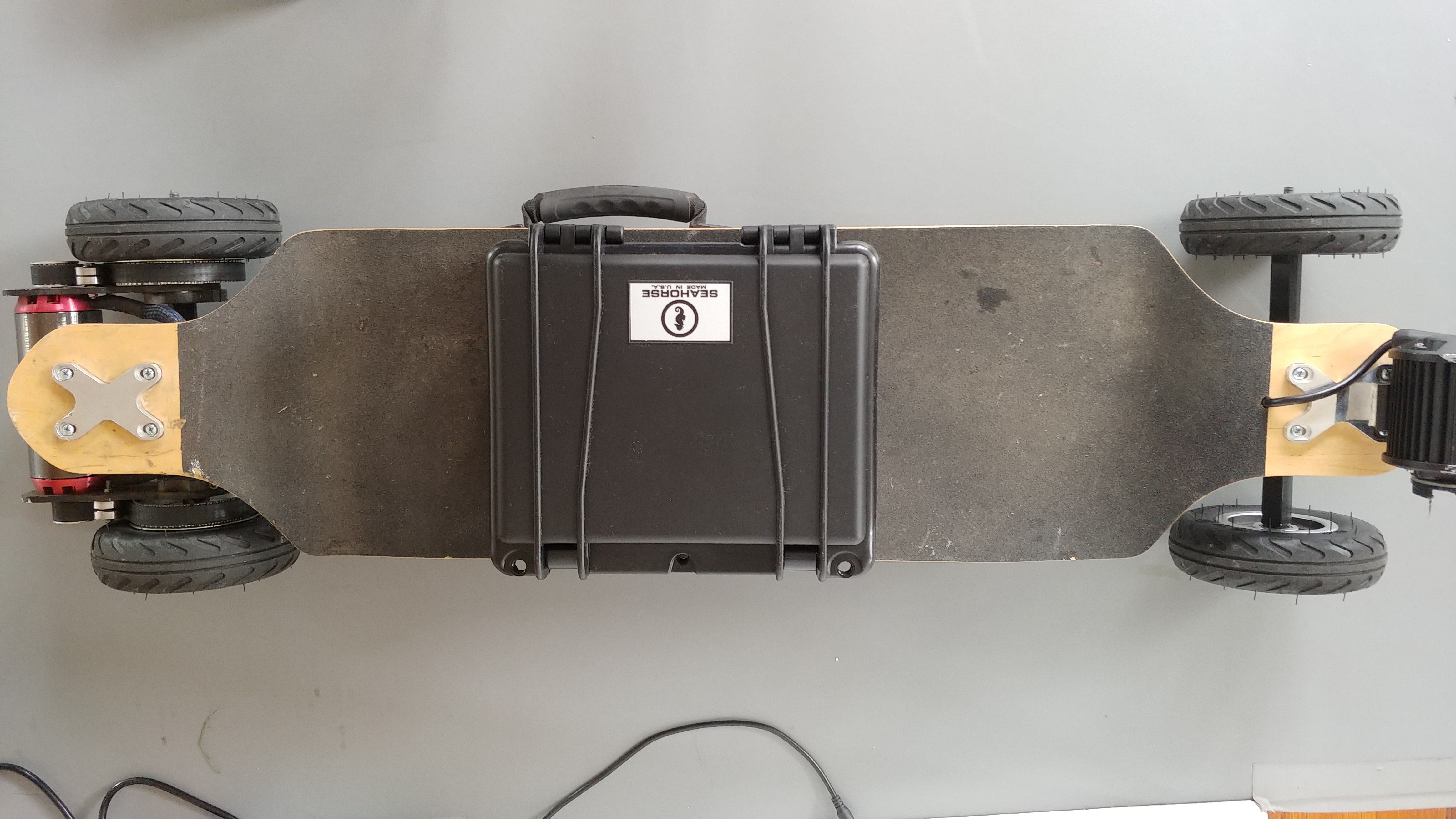

It’s actually a sector nine deck I sanded paint from the bottom. Had it since 2013. I could fit it the other way but I feel more comfortable with it sitting like that. The whole case sits directly on the board that way, if I had it the other way, only half the box would be sitting on the deck

i think i found a good solution…ordered a box off amazon called seahorse… is like a perfect medium size between the 1800 and 2800…
still plenty of foot space and possibly ok with mounting it width wise… will post a few pics later with batteries for public reference and future searches =)
