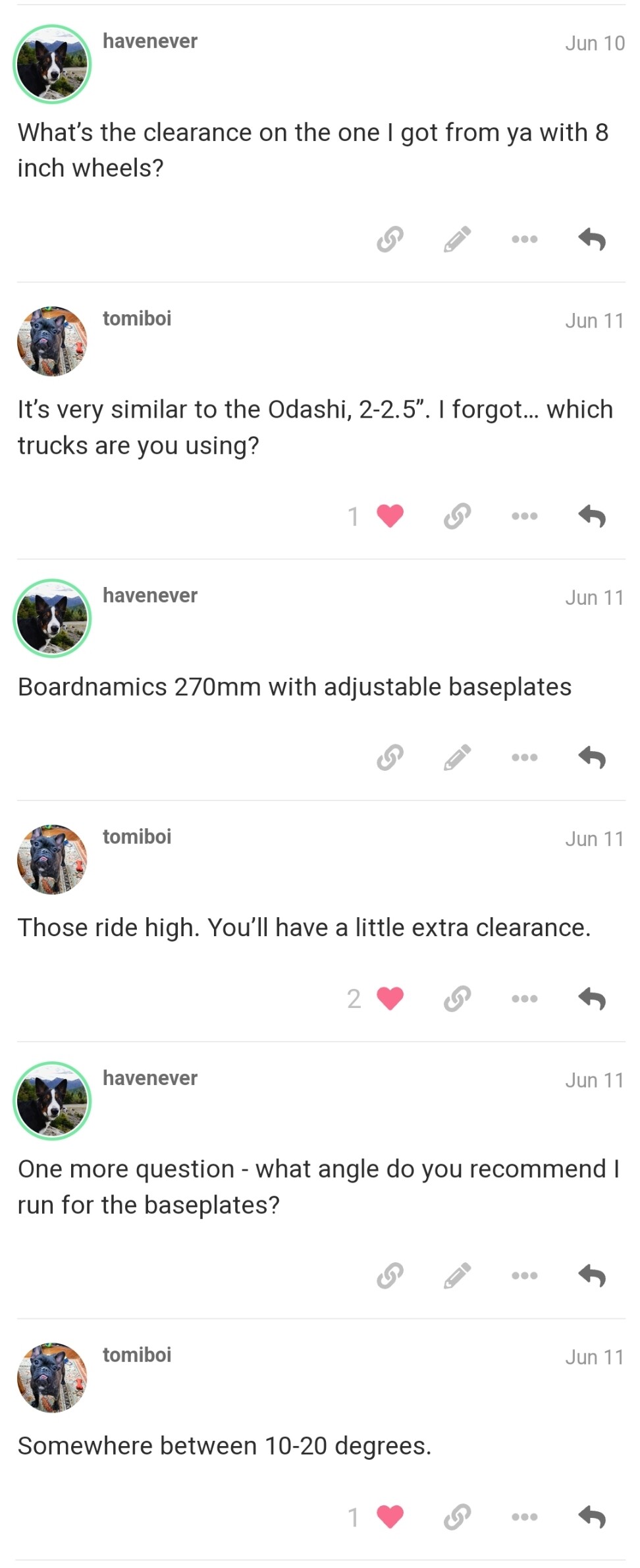

Just pulled the trigger and ordered a 41” mtn board and double stack enclosure. Do you think 150mm wheels would work on this or would i need to go larger?
congrats! we gotta cruise on our new tomiboi builds when we’re done!
Thanks a lot man!! You’ll most likely need bigger wheels. What trucks are you going to use?

I moved the convo to dm because im new and ran out of reply’s lol, but I got the boardnamics M1-AT Drive + 270mm Adjustable Truck Drivetrain Kit, ill update when i get everything in hand and mock it up.

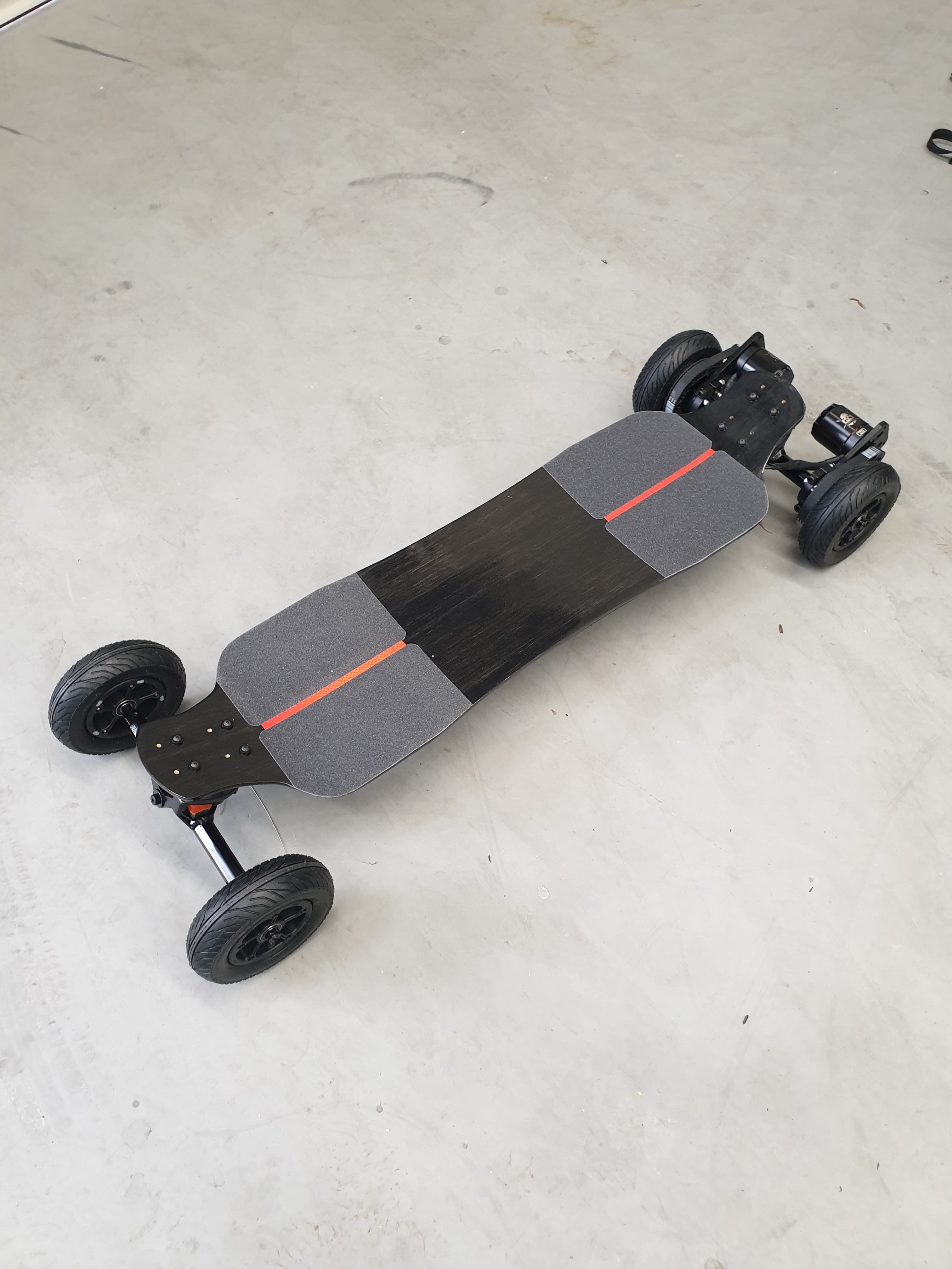

I made a TomCat @tomiboi
Deck is super comfortable to ride!

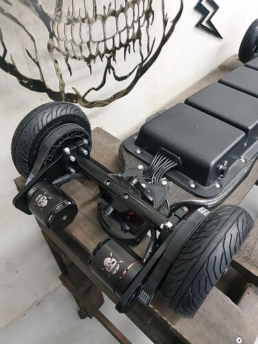

Extreeeeeemly clean looking build you’ve got there :sunglasses:
Got a model for that wire holder by any chance?
