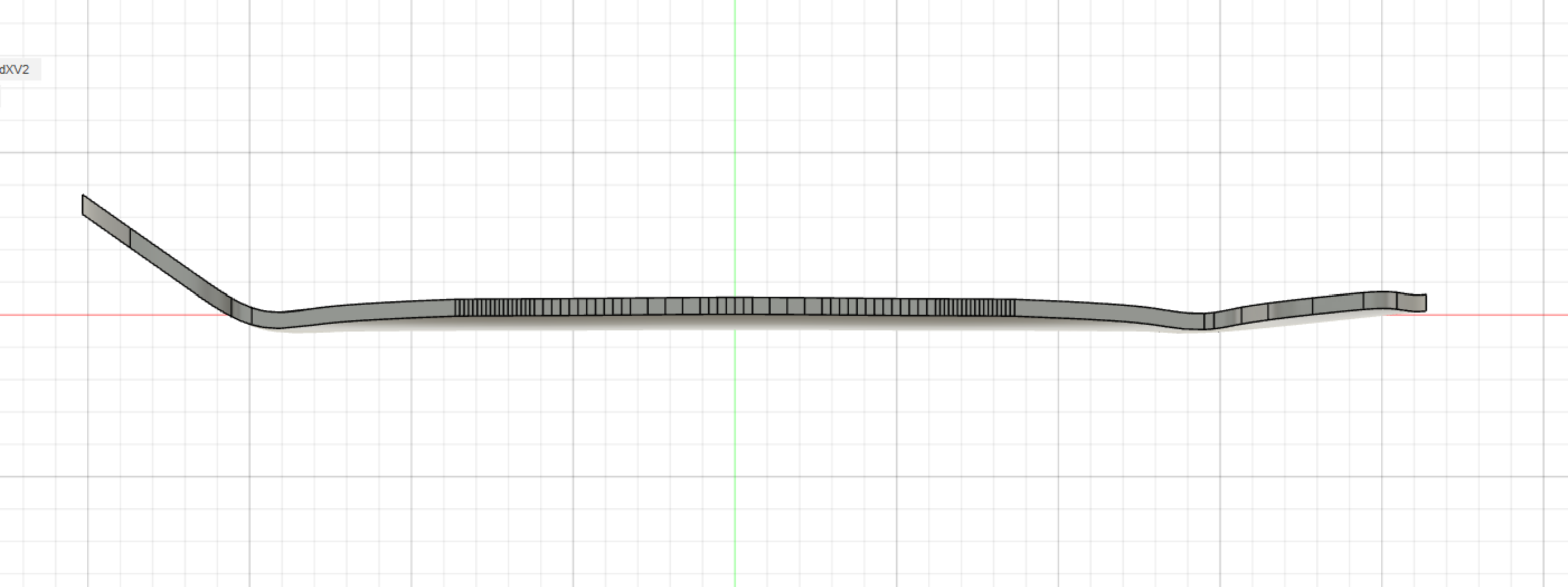

Now it’s time to get serious about wrapping up the deck design and making this death-sled boogie. Here’s what I’m working on with the deck design. First, I’m making it less pointy. As much as I like the spikes, I worry about racers getting gored by one of them in a track pile-up. Next the prototype was designed with brackets in mind, so I made it extra thick to make things strong and stiff. The race-spine design changes things. I can make a deck that is much thinner and lighter. Lastly, I’d like to put more of a nose on the deck so that riders can push their toes out closer to the axle. Here’s a CAD pic of one possible design.
The nose is ramped so that it clears the rods and axle-pivot. It also has a little concavity to it. According to my measurements there should be no wheel-bite with this design. So, anyhow, I still have some work to do on the deck. Recommendations are welcome.

That designs looks very nice! With the steel spine, is the deck thinner than a typical deck? Also, what size battery does he enclosure fit?

I’ll probably go with 6-7 ply backed up with a bunch of fiberglass. I need to get some cells out and see what will fit in the belly pan. I’ll take some pics when I do.

Looks sick dude. Curious about the battery capacity and layout here. I was going to ask if a channel or groove for the spine would work but I see there are flaps to hold it to the board. It’d be sick if somehow you could drop though mount the board so that the he spine would be more flush with the board, mostly for internals. But seems like it’d be splitting it in half.
