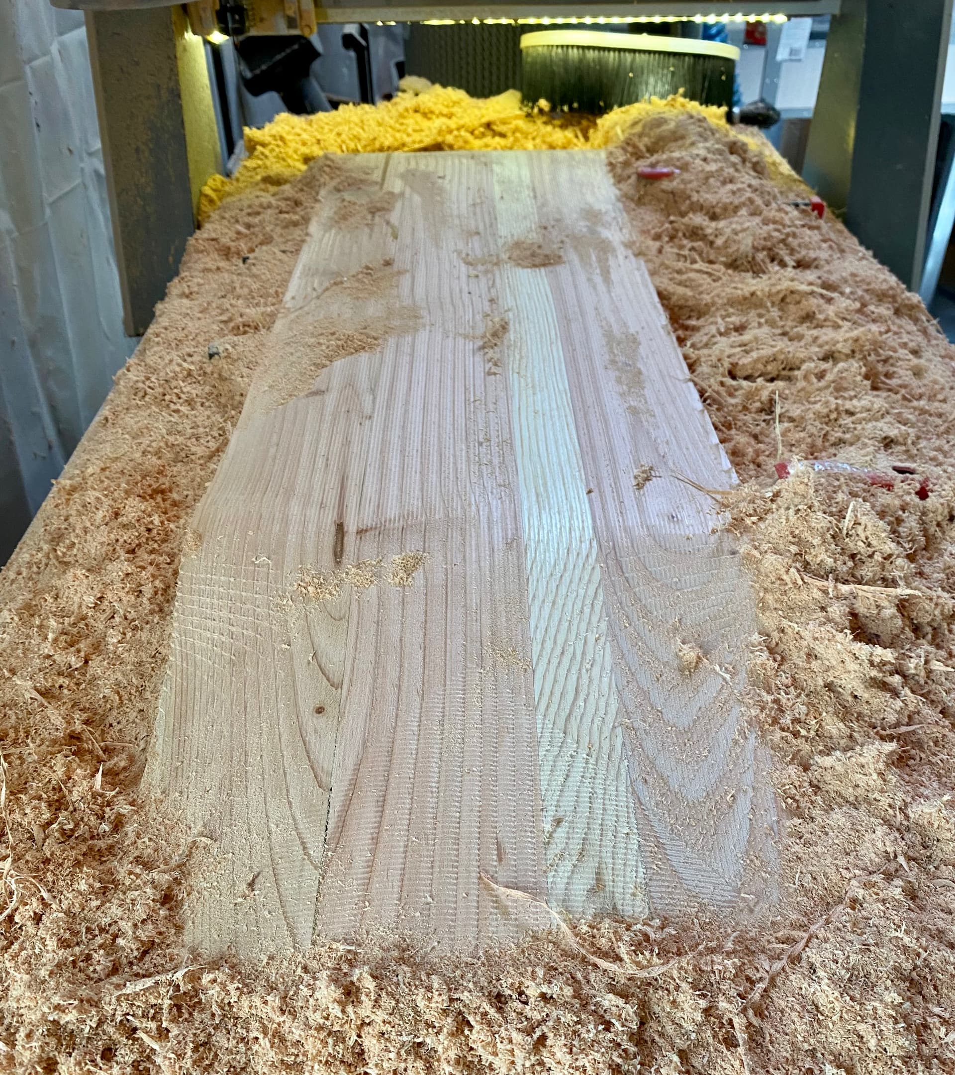

I made a mold… and a mess. The deck is pressing now. I’m really interested to see how the nose of the deck works out.
Yewwwwwww
This deck has been a lot of fun to design. Something totally different.
I’ve been sizing things up and I think I can do a 21700 double-stack. It would probably need to be staggered and there wouldn’t be much room for padding, but it looks like it could be done.
Previously, I thought I’d only be able to do 18s4p, but now I think 18s6p could be done. I’ll post some pics to back up these claims later.

Tomorrow, I’ll have some pics of the deck part of this project.
