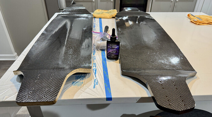

Alright, I’m working on Odachi V3 over here right now. I’m changing the shape and construction a little. I’m also trying out some new materials to try to reduce production time. Generally, my decks take about two weeks to make. Most of that time is spent waiting for high quality epoxy/resin to cure. I found that the epoxy/resins that take the longest to cure give me the best result, but, man, two weeks is a long time. I’m especially picky about the clear coat. I use System III clear coat and It’s really the most flawless clear-coat I can find, but it takes a full day to cure on each side of the deck. I saw people using UV-cured clearcoats on furniture and I thought, “If that works out, I could do my clear-coat in an hour or less.”. So, I bought some and gave it a shot. (UV clear on left, System III on right)
The result, I don’t like it, or at least not this specific product. It’s too viscous and that lead to a lot of bubbles and streaks. I might try out a spray-on product generally referred to as 2K clearcoat. It’s a proper clearcoat for cars and it would make my carbon-fiber work pop, but the problem is that a can of it cost about $30 and it only has a 24-hour pot-life after activation. Because I do everything to order, I’m regularly only doing the clearcoat on one deck. This means I’d be throwing out a lot of expensive clearcoat. This stuff does cure quickly. It can also be purchased for spray guns, which could be a solution, but then I’d have to clean my gun after just doing one deck and that isn’t efficient. Also, I hate cleaning painting equipment. I’d rather just throw the entire paint gun away and buy a new one. If I ever go over to making batches instead of making everything to order, 2K clear coat might be the way to go, but for now I think I’m stuck with System III clear.
