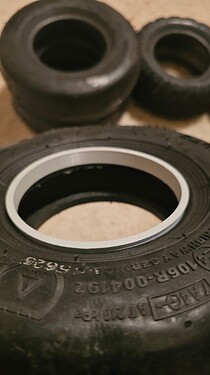

Anyone have success putting 9 inch tires on the hubba hubs?
3d print lip works plenty well. Mine wasn’t a 9in tire but it has a 4in inner hub, which will be the same issue since Hubba Hubs is 3.75in
If you want to widen the hub someone made a design for a 10mm spacer.
