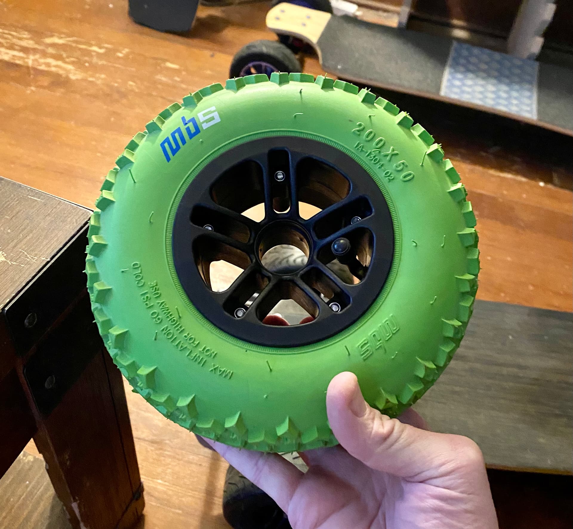

Are they stuck? I just use brute strength and hammers… maybe an angle-grinder if shit gets real.
Take all the bolts out lf the hub and then slowly inflate the tire. The pressure will split the hub pieces apart and you should be able to work one of the pieces out.
Not necessarily stuck. The bead is really tight so pulling the hub off takes a lot of effort.
This type of rim can also be tapped out from the back. Just suspend the tire back-side-up between two things with only the tire rubber touching the things. Then tap on the bearing seat with something until the front comes out. The back should be easy to remove after that.
There is something called a bone tool (just a piece of plastic) you can get from bike shops for like a buck, its really good for getting tires off
There’s a tapered pry bar that’s good for getting a gap between the tire bead and hub rim, and a hooked end that you hook over the rim and drag around the edge to displace the tire, and it’s soft so its non-marring
Lol I do have some didn’t think to try using them. I still have 3 wheels to go so will give it a shot. Will also try a mallet and propping up just the tire to bang out the hub.
Careful when beating the shit out of them, they have a tendency to bounce all over the place
They work out nicely with MBS tires.

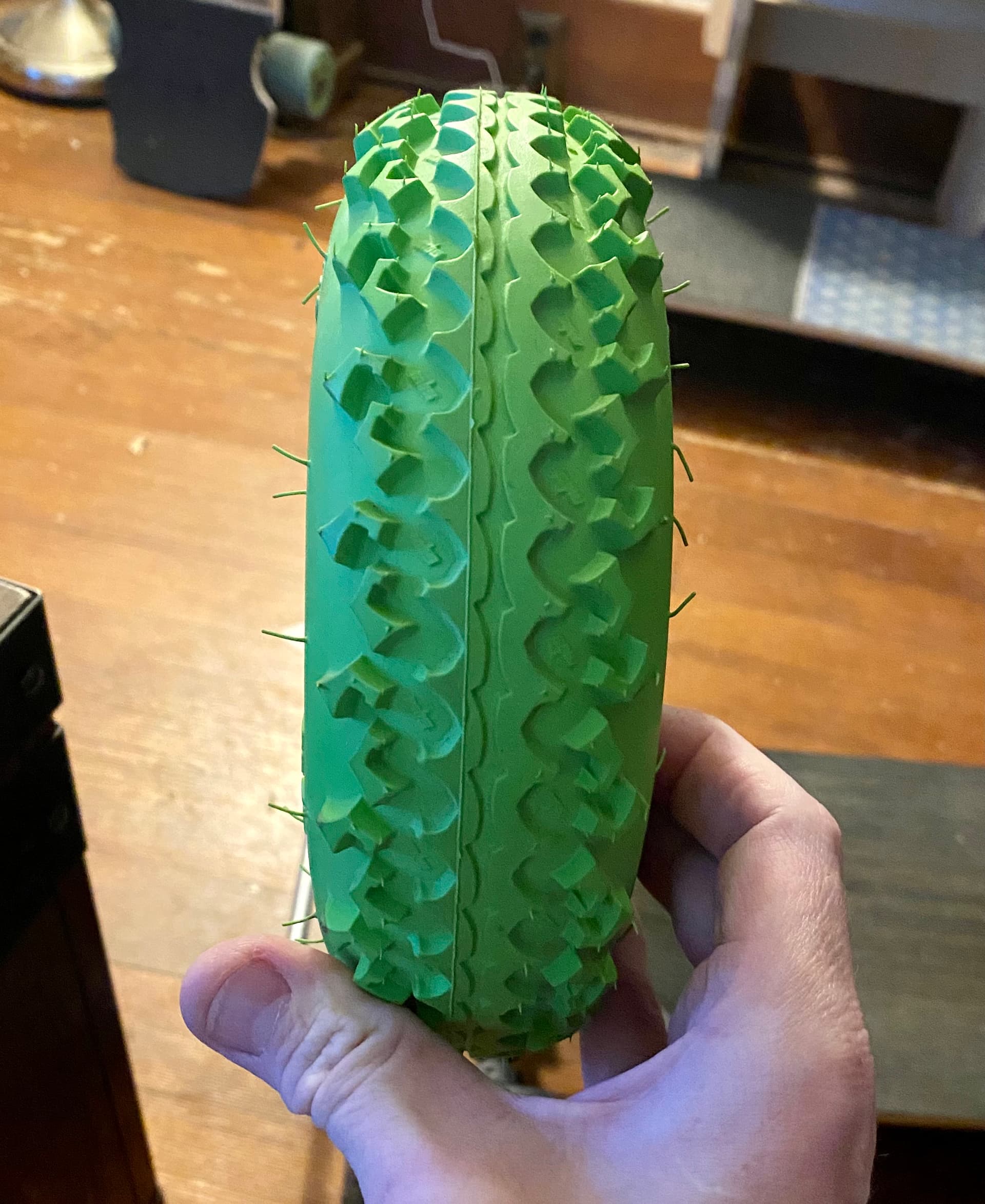

Is that a t1 or t2? It looks nice stretched like that
I believe this is a t3. I’d like to try out a few of trampa’s 8” off-road tires to see how they stretch.
