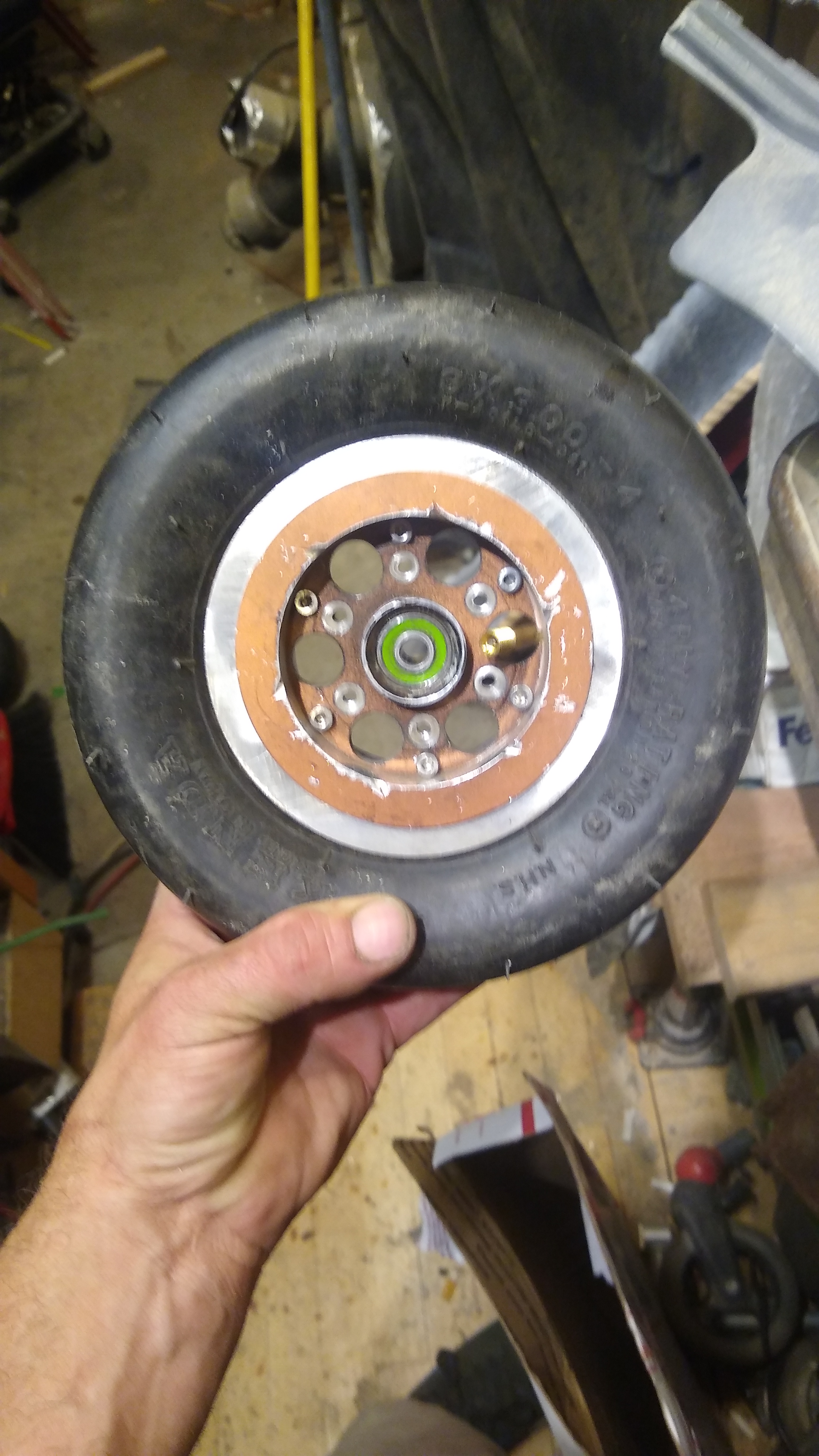

Any tips on turning all-terrain tires into a tubeless setup. I’m assuming people have done this? Ready to get rid of the tubes and stress less about flats. I’m currently using puncture resistance tape over the tubes but would love to just go tubeless.
Any tips? Or links?
Can you even do this on a 2- piece hub?
You can cast the inside with silicone or polyurethane, but you’ll get issues with core delamination unless you have some sort of surface feature (the pressure from the tubes inflated create enough sideways force on the hub so the friction transfers the torque)
2 piece hubs will probably work better since tightening the screws will apply some pressure, Trampa gummies work like that, but I haven’t heard they stay in well

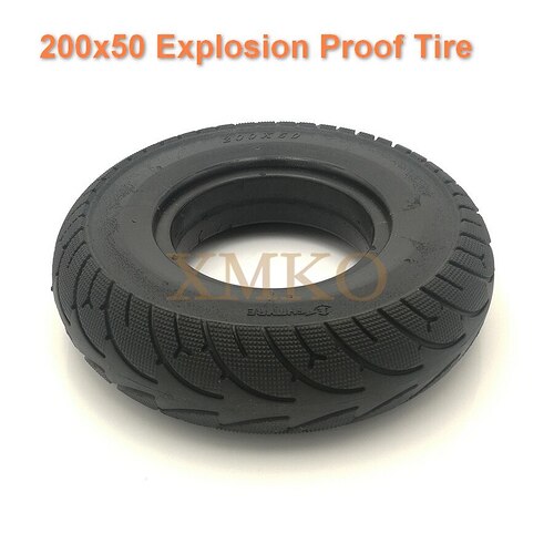

There are tubeless 200x50 tires, but they are filled with foam or other things and pretty heavy. Probably also not the most comfortable to ride.
Idk how you could seal up a regular 2 piece hub so well that you could just pump up the tire without tube without loosing air pressure over time.
Even if, it would still give you issues with punctures as long as you use the same outer tire as before.

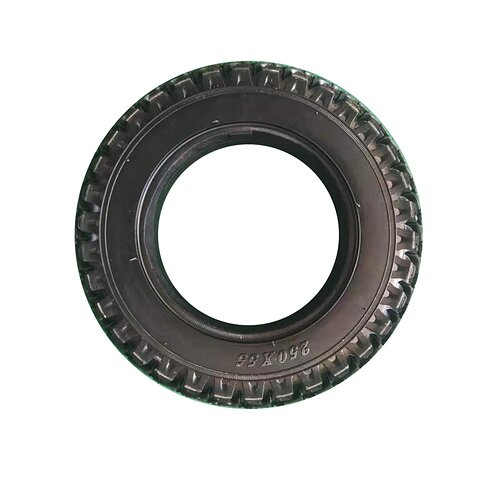

Is it safe to assume that the tires we tend to use are tubeless ready since they’re designed for scooters that are more likely not to use tubes?
The rental scooters in my city mostly use solid tires like those or similar in design
Roller Solide Tubeless
Tubeless beadlocks are different than the hubs we use. Not going to work. Even if you do seal the two part hub. The other issue is the valves. Bike valves are long and straight. Tubeless are presta style instead of the schrader that we use. Not to mention tubeless tires have specific beads as well.
Going to be a ground up design if we are ever going tubeless.
Yup.
Bead lock. :wink:
