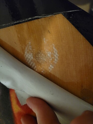

Anyone got a pro tip for fixing an accidentally pushed through insert? Just peel the grip tape back and epoxy it in? That’s the plan currently
You should try and sand the area around the insert some just to make sure the epoxy can soak into and get a good bond with the wood. It also wouldn’t hurt to try and scuff up or scratch the outside of the insert if possible. You probably don’t need to scratch up the insert but it doesn’t hurt to do it just to be safe
if it is inside a different material I would also try and scuff that material up. The sanding doesn’t apply only to wood

I’ve got an insert on my tomiboi deck that pushes through whenever I put the screw in it. Is there a sneaky way to epoxy it in place without having to remove and replace the whole thing?
You sure the insert is moving and not that your bolt is just too long?
I’ve done this, looked quite similar :smiling_face_with_tear:
yeah, it’s the included hardware, all the other ones are fine. had it mounted previously without issue but had to take the enclosure off to find a rattle. when I put the enclosure back on I must have dislodged it :frowning:
You may have cross threaded it, get a tap in it.
Or…
Loctite a bolt into it, let cure, remove insert, epoxy hole, put insert back in
pls elaborate
thanks for the info! i don’t thiiink it’s cross-threaded… probably best to just loctite and replace the insert, just didn’t want to have to go that route :confused:

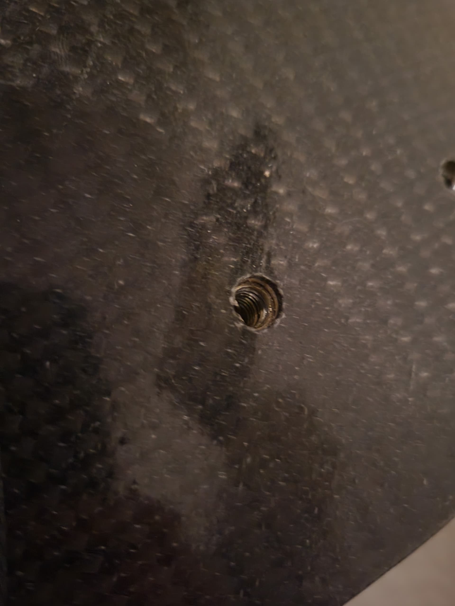

So I tore a threaded insert in my deck, there’s still some insert in the hole but I can’t engage threads with anything anymore. What should I do about this? I’m considering digging out the spare insert and maybe glueing a new one in? Would that be strong enough to form the enclosure to my deck shape?
Bolt through :ok_hand:
