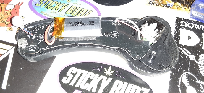

Hey guys, im having a problem with the remote. These lights are on, the remote is slightly vibrating, however it does not give a signal and does not want to turn on and off. Anyone knows how to fix this? I tried all in know and i cant find anything about this.

Pot wires are good, battery is a shit 500mah.
I would resolder those wires and have them flush against the pcb. These wires seem to break off just by breathing at them) Put little glue to keep them in place).

I gave each a tiny tug and they looked ok so I already threw glue on both sides of them, on the PCB and the pot pins.
I used a tiny dab of glue to hold the pot in place instead of just the flimsy housing and now the thumbwheel seems more solid no chatter, so I will try to see if that alone improves the issue at all.
I decided to put a -13% curve on the throttle but forgot the change the brakes at all so I will do that after I do a first test.
