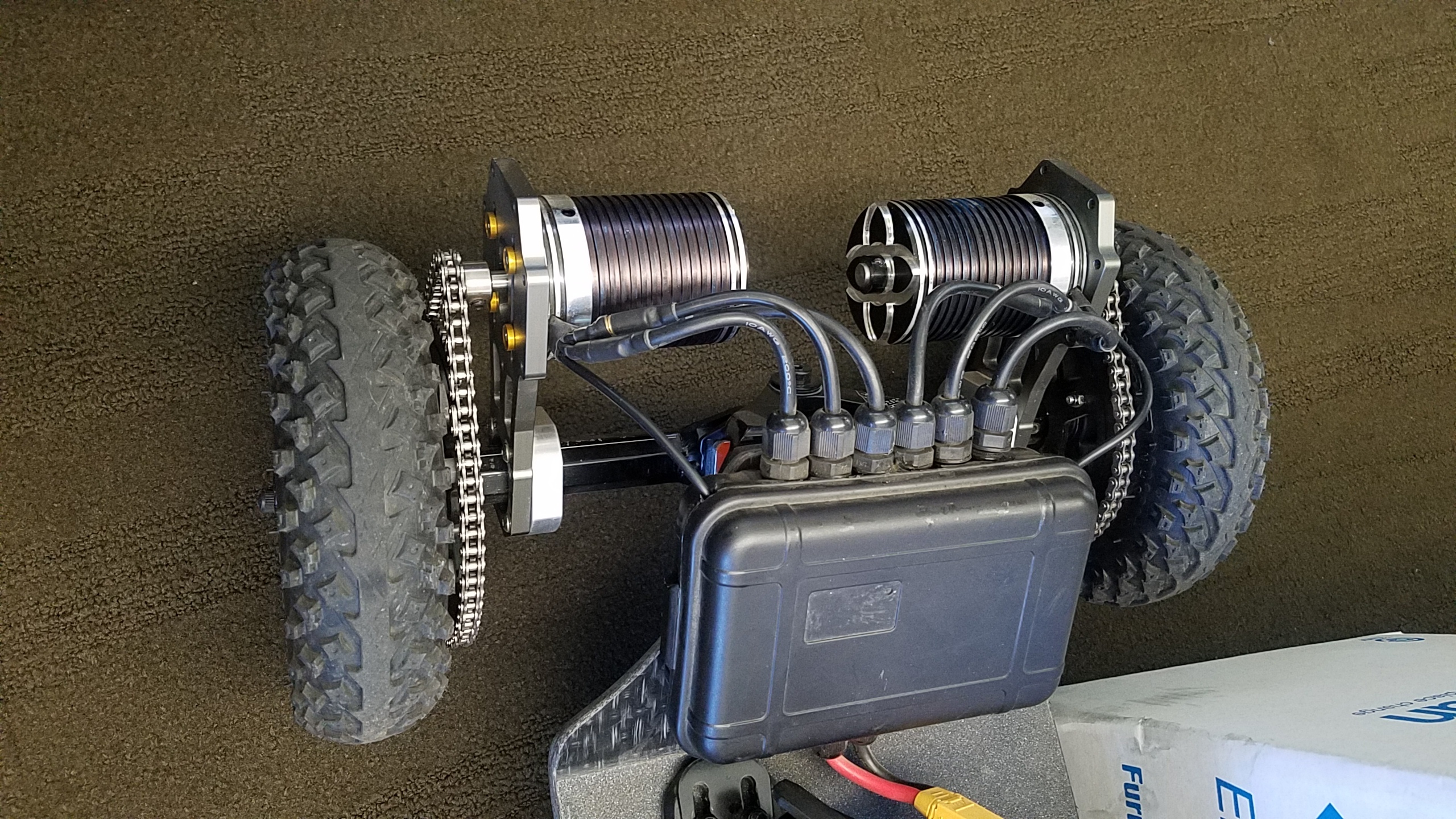

I do the extension cord trick if I have enough extra length. Not the best for wires but they shouldn’t be under any real tight strain anyway…
But it looks so clean without!
Fun fact the VESC FOC algorithm still manages to work with only two wires plugged in.
Albeit super jank
Also where did you get those cable glands.
They’re pg7 cable glands, lokman brand but they’re all basically the same if it’s also pg7.

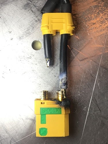

why can’t i solder*
*without getting frustrated and taking a blowtorch to it.
Not enough Watts. Also, need “Helping Hands”.

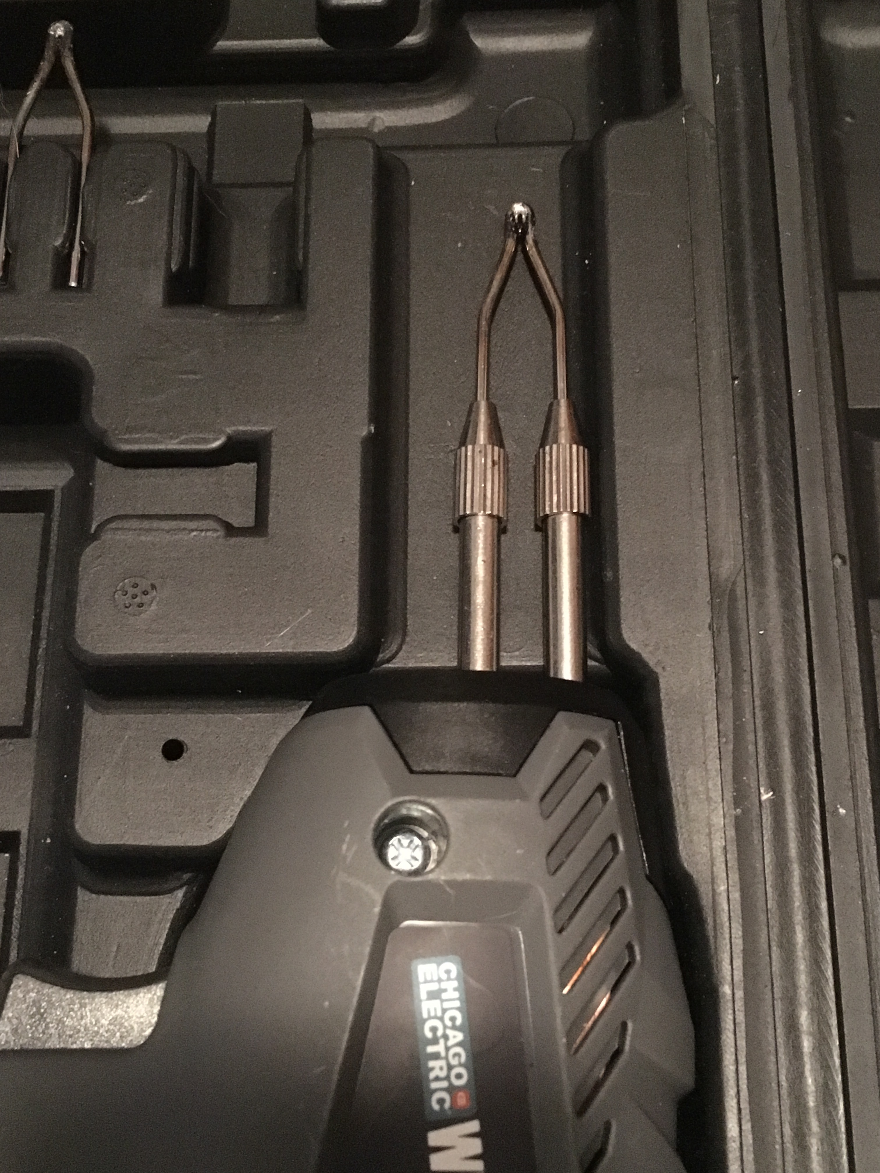

trying with this 100 watt, is this kind of tip ok?
(i’m not going there…)
IDK? As long as you can solder with it I suppose? I use an 80W Arduino based solder iron, but you can get cheaper ones on Amazon for like $20 I think. Also, tip size matters for bigger gauge wires.
The tip is your problem, it doesn’t have much mass mass to store heat, what you need is a powerful iron, as you have, but with a massive tip, copper conducts heat really well, so if your tip is lightweight it cools really fast
