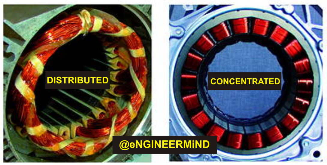

Why couldn’t esk8 motors be halbach arrays and use proper distributed windings instead of this concentrated crap.

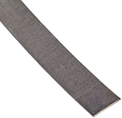

Has anyone tried liquid or bead balancing of pneumatics like semi truck drivers or motorcyclists?
I have not. This lead tape works well.
Wouldn’t both of them lower the power density?
Distributed windings would make the stator shorter for the same external motor length no?
No, distributed windings are just harder to manufacture, especially for smaller stators, but machines exist for it already. They have significantly better power factor and would benefit more from FOCing.
Halbach arrays increase magnetic field strength, meaning fewer turns are needed for the same kv rating so lower resistive losses. I can see in my 6374 can that there is potentially space for lateral magnets to create a halbach array.
But alas it is just not enough, I want to experiment with an 80mm stator at some point.
Thanks, in my mind the distributed winding would take a lot of axial space, this picture shows what I mean, since you have a lot of overlap between each phase
Ah I see what you mean now. Yeah, the wires do take up more space above and below the stator, but this space appears to be unused and available in some of the bigger esk8 motors anyway. If not, just make the can longer, the magnets don’t necessarily need to be longer.
