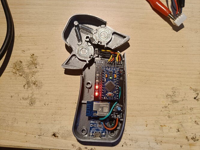

Life’s been complicated and my arm and butt took a little bit longer to recover than anticipated. However, I come bearing great news.
Testing
It’s going great. +200km without issues, great battery life, precise as the first day. My GF has had the same experience as me and will not go back to her VX1. Even painted hers (rounded version with ergonomic addon):

Mostly minor corrections on the calibration. I’m missing three features ATM:
  • Automatic shutdown after some inactivity period.
  • Low battery warning and graceful shutdown.
  • Better pairing. Right now I’m using a combination of LoRa frequency + matching rx/tx id to avoid collisions. This is likely to remain this way through the beta period (1000 channels * 65535 possible IDs make them highly unlikely, only issue is that they’re baked into the FW)

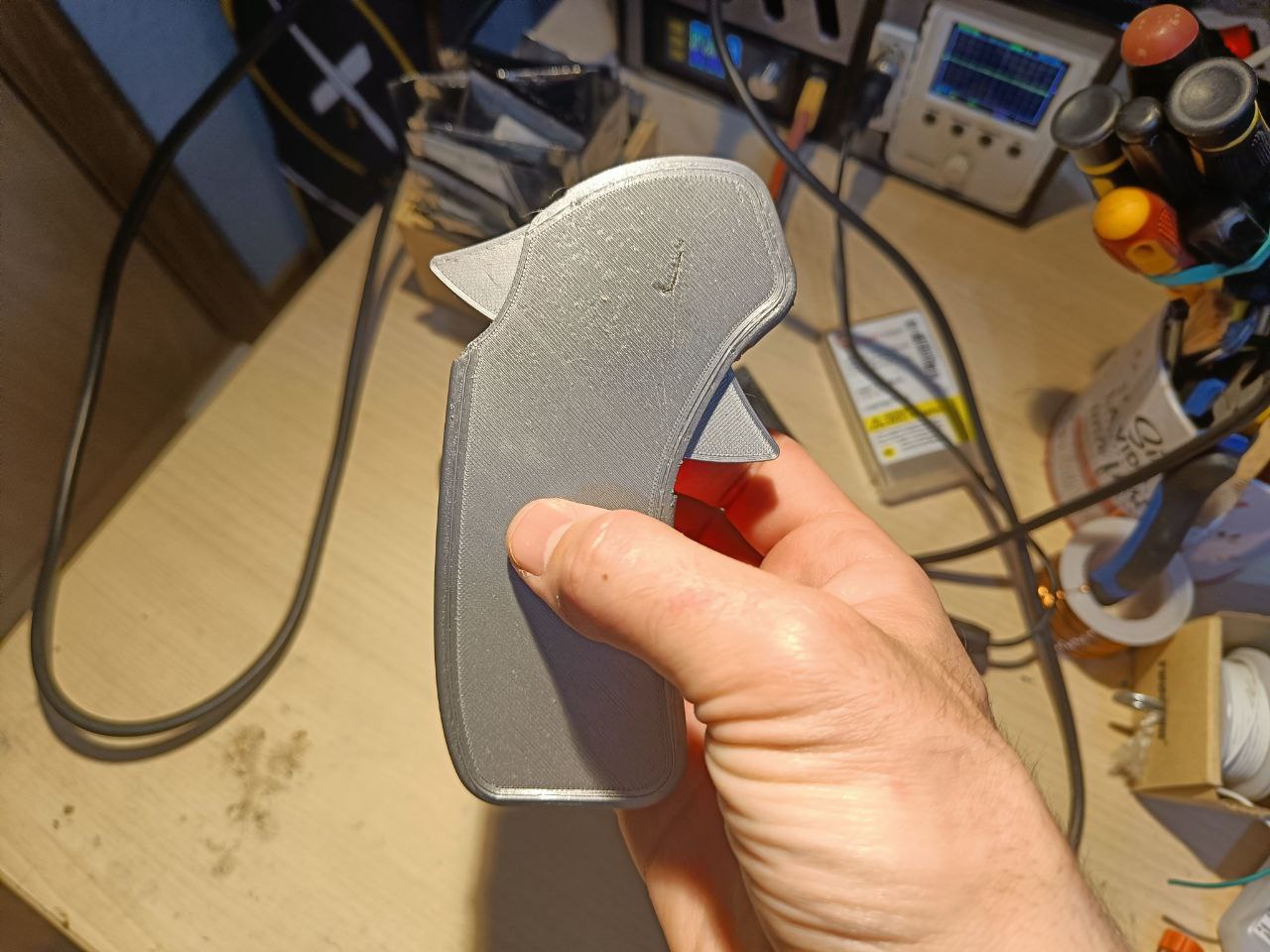

Finished the design for the “VX1-like” version:
Mostly the same footprint, a little bit more comfortable if you ask me!
And finally, due to popular demand and still in early stages but FULLY FUNCTIONAL both on HW and SW sides…
The Dual Trigger Unfancy Remote
A lot smaller than previous attempts and with all the same features, finally validating the dual input in the PCB. I know some folks prefer the inverted trigger for the brakes, but bear with me, it’s VERY comfortable and natural to use. Will try and polish it so I can test it over the weekend.
