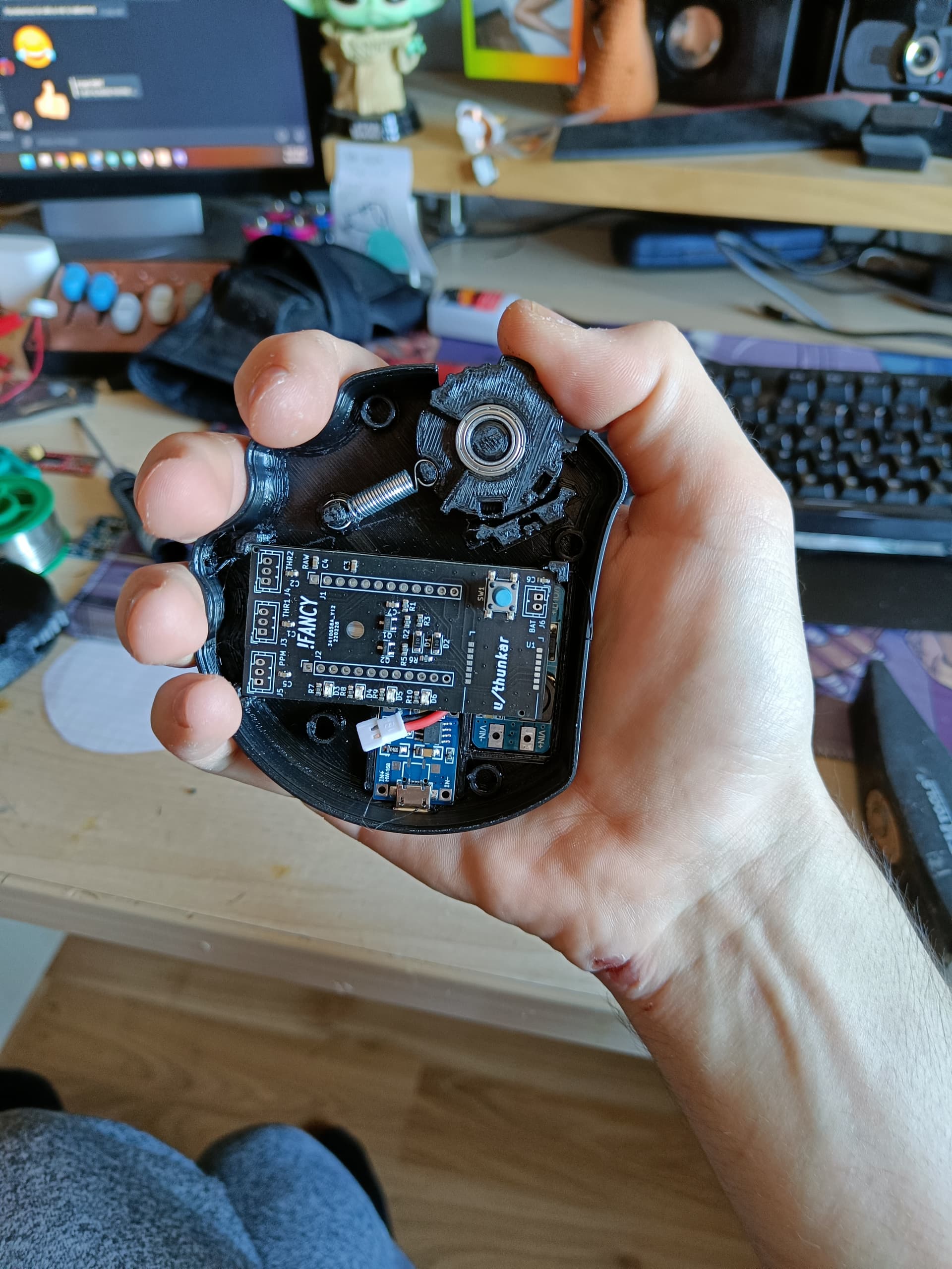

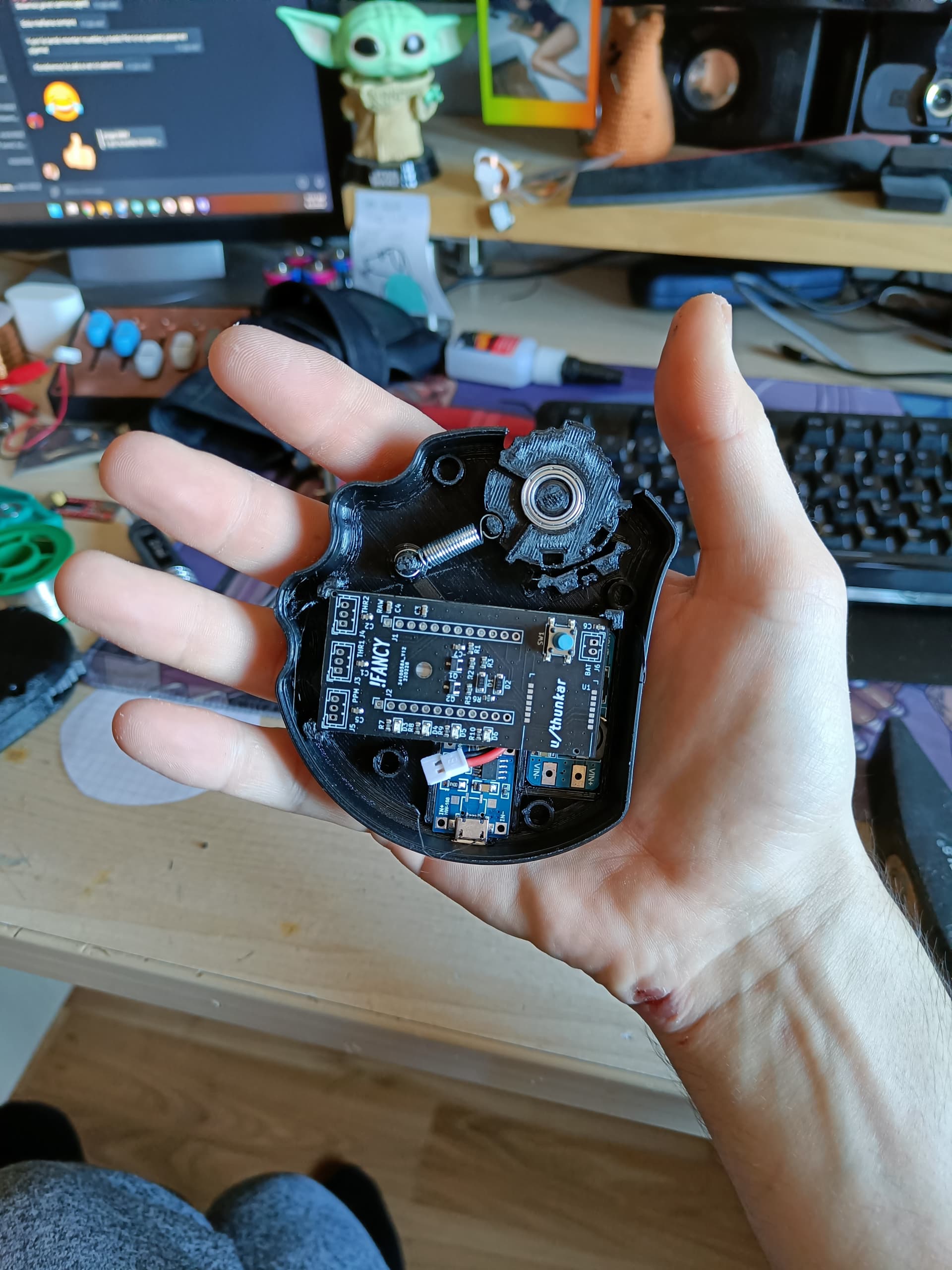

A peek inside:
The Arduino is covered in flux because I made a stupid mistake and had to rip it apart from the PCB after soldering all the pins…
This version is possible because I have started working on stacking components vertically. Also, I know you guys really want a 18350 version, but battery life with a 600mAh LiPo is kind of amazing at the moment.
This remote is getting quite fancy, if u ask me. :smiley:
