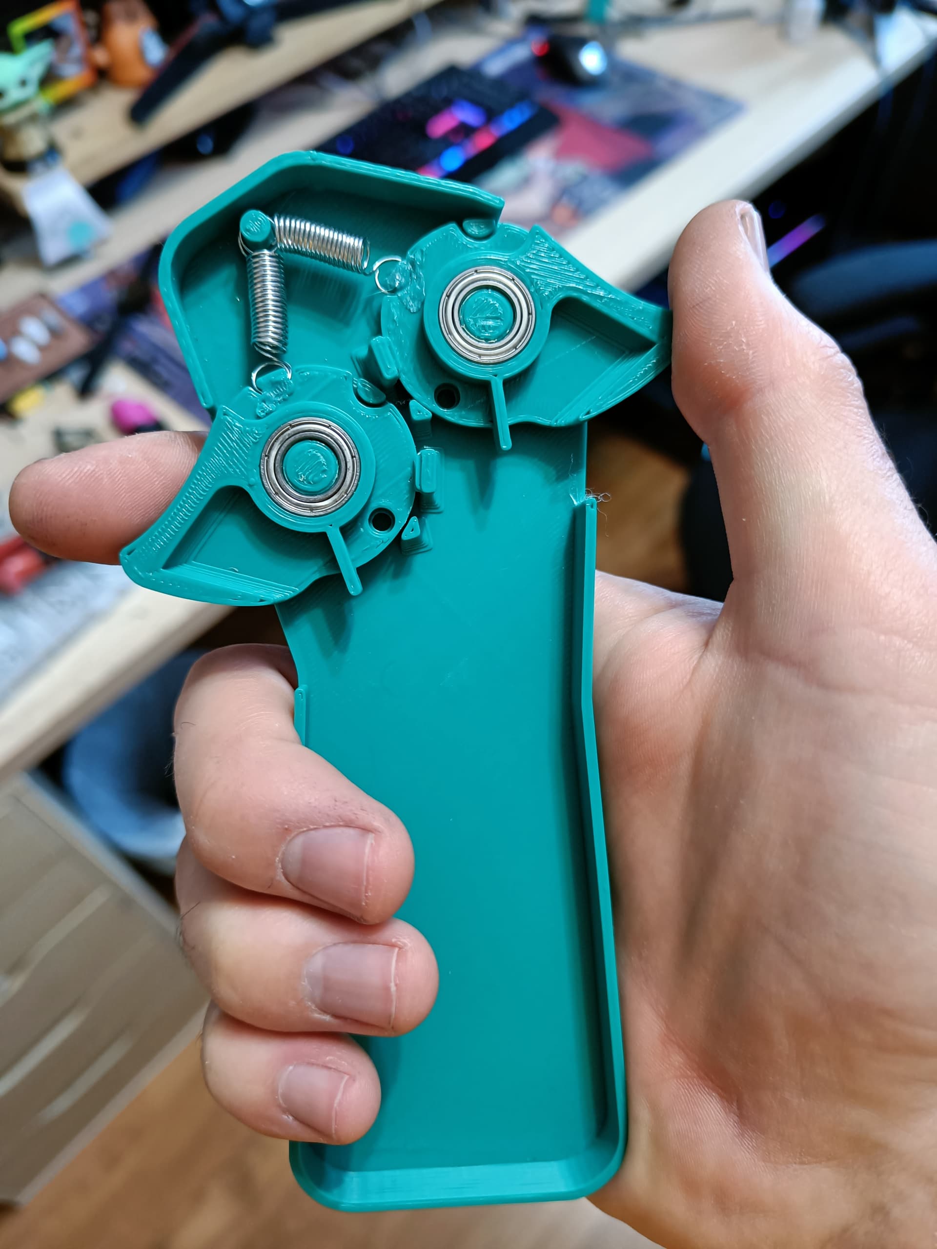

The Unfancy Remote | WIP DIY reliable remote
Nice, but it looks a bit to wide for the palm. If I remember from the evolve days, brake will immediately override throttle input.
I have this r2 sitting around. If you need it for “examination” ill send it to you.

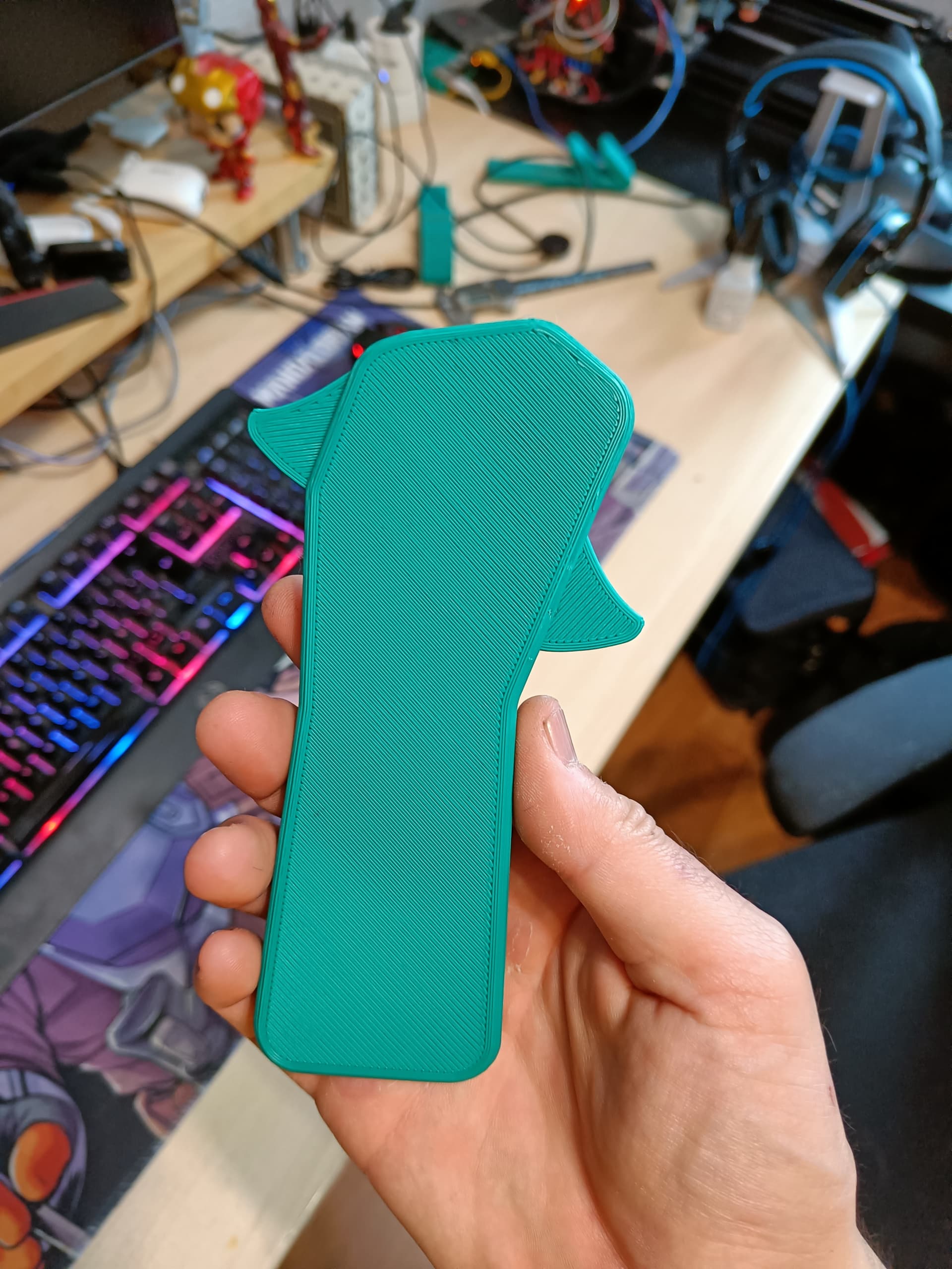

Yeah, I think it’s too wide too, but this is just to validate the software and trigger mechanism. I think I can move the brakes a little bit higher and make it smaller overall.
Thanks for the offer, but in the end I have to fit everything inside and that’s the limiting factor ATM. Also I have gigantic hands and usually commercial remotes are not really comfortable to me, so I’m trying to cater to a wider variety of hand types (and that’s why my GF hides from me every time the printer stops and I want to test a new version :sweat_smile:)

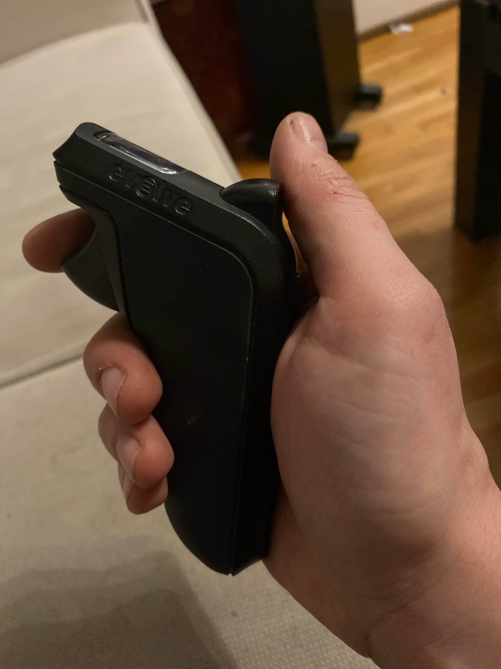

I’ve not felt a vx3 before, it did seem like it would have less throw though
those small triggers are just :face_vomiting: :face_vomiting: :face_vomiting:

I know they look so tiny, I mostly haven’t gotten one to review bc I don’t think I’ll like it enough to use it after lol

Slimmer remote, slightly longer throw. Ready to start with software!
Once it’s functional I’ll do additional ergonomic passes to really dial in the feel :grin:
