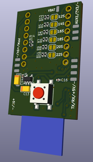

  • If I ever have to order new PCBs, I have a 2.1 version with a stable voltage reference to improve the accuracy of the ADC readings (specially for the board battery measurements) and avoid having to calibrate every single receiver.
  • The more I look into it, the more complicated it looks, but a pairing algorithm to avoid baking anything into the firmware would be awesome
  • Better cases for printability and ergonomics…
  • Everyone and their dog is building HV boards these days, but the unfancy receiver only measures up to 12S voltage. So that.
I seem to always make the same list, but if I find the time it’s easier to tackle the most requested stuff if I find it in the latest comment xD

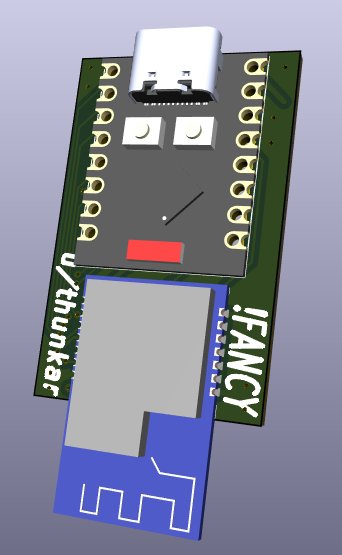

  • Friendship ended with Arduino. ESP32 C3 is now my best friend. Why? Well, 32bit, 160MHz, 2 cores, WiFi, USB C and THREE DOLLARS for a RISCV processor that’s barely bigger than a coin? Sign me the fuck up. Also I don’t have to git good and learn C++, because I can reuse 99% of my code! I guess friendship not 100% ended with Arduino. (https://es.aliexpress.com/item/1005005968727477.html?spm=a2g0o.order_list.order_list_main.107.4979194dL7lRxk&gatewayAdapt=glo2esp)
  • Fuck external power management boards from the deepest corners of aliexpress, 100% integrated power management it is. BMS with TRUE “ride and charge” functionality (https://www.microchip.com/en-us/product/MCP73871), high quality step up converter from Ti, nice step down to 3.3V for clean power.

  • 12-22S support on the receiver (selectable via solder jumpers)! Also there’s 2 PCBs now (TX and RX) since I crammed SO MUCH STUFF on the TX and didn’t want to increase the size. Also the TX is significantly more expensive than the RX (I really hope it evens out since there’s a lot less stuff to buy, the PCB does it all)
  • Dedicated AUX out on the RX (just 3.3V logic, no real power)
  • Same reliable LoRa RF system, most of the same core code, but reorg’d so it’s WAY more readable and maintainable.

Project is getting updated at least once a week in the same repo, feature/v3 branch. No significant issues so far, except for:
  • A stupid HW bug in the ESP32C3 supermini boards you can find in Aliexpress, that pull up a bootstrapping pin unnecessarily (GPIO2) and forces me to clip a resistor from the processor PCB. (https://www.sudo.is/docs/esphome/boards/esp32c3supermini/esp32-c3-supermini-schematic.png). Did you want to use the ADC on that pin? HA!
  • A stupid mistake I made when running the RGB LEDs. If you power them from 5V but run the data line on 3.3V logic, you’re technically out of spec. Most people get away with it, but my step up converter runs at 5.8V, so I have to add a zener diode that brings the LED power line back to 4.8V to be safe.
I’m now testing the RX code with a blank TX PCB before pulling the trigger on the next batch, but looking promising!

@tuckjohn @A-damW thank you guys! I knew of this fault, been using the ESP32C3 supermini for other projects for a while now :grin:
At any rate the integrated WiFi is only used for the captive portal when configuring the remote, LoRa is still used for the actual TX/RX communication. Someone smarter than me has actually done LoRa without semtech transceivers but there’s no way I’m risking that since the best part of the Unfancy is its reliability :smile:
