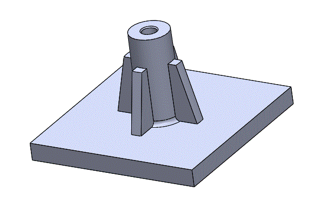

  • Marked in red, both of these parts are begging for support between base and cylindrical part, it can be both a fillet or support structure. Like this: Plastic Part Design Guidelines for Injection Molding | SMLease Design | Design guidelines, Plastic injection molding, Plastic design
    I first printed remote on a shittier printer with larger (0.19mm) layer height and both of these snapped off right in the part between remote base and extruded cylindrical section. I switched to Zortrax hips material and made reinforcement fillet with epoxy and it holds a lot better now. (Also I was a bit confused, you did add fillets for the sensor extrutions that carry way less force)

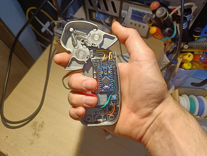

  • Marked in blue, position of spring is not great, the way I believe spring should be placed is so that it always presses trigger against some sortof wall at 0 position, thus trigger will always return to the 0 calibrated value. What me and @CrazedMK encountered was that it would not always return to 0 position, instead not having enough leverege and sitting at ~5% duty cycle.

  • Regarding the “not returning to zero” issue, this is actually commented on the docs. Due to the very nature of the 3D printed mechanism it is recommended to lube it up a little bit so that it as an easier time moving until all the imperfections are sanded down due to use. At any rate you’re absolutely right, the trigger should have a flange to rest at “zero position” when not pressed, at the moment it can actually move the other way like a thumbwheel.

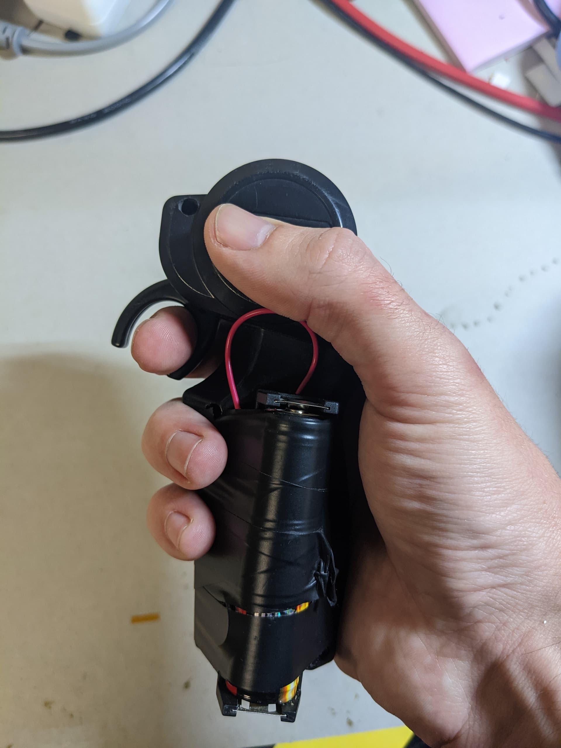

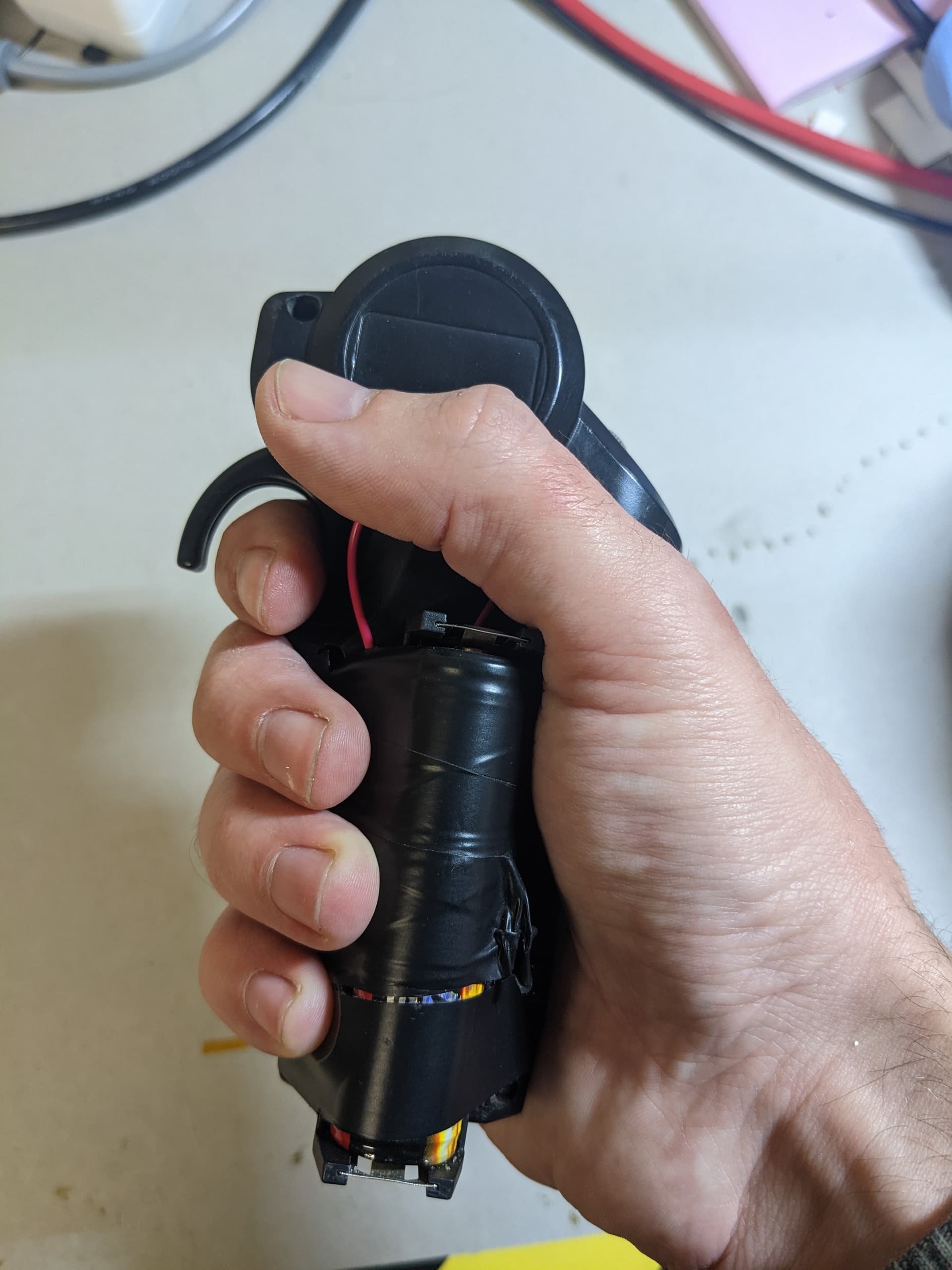

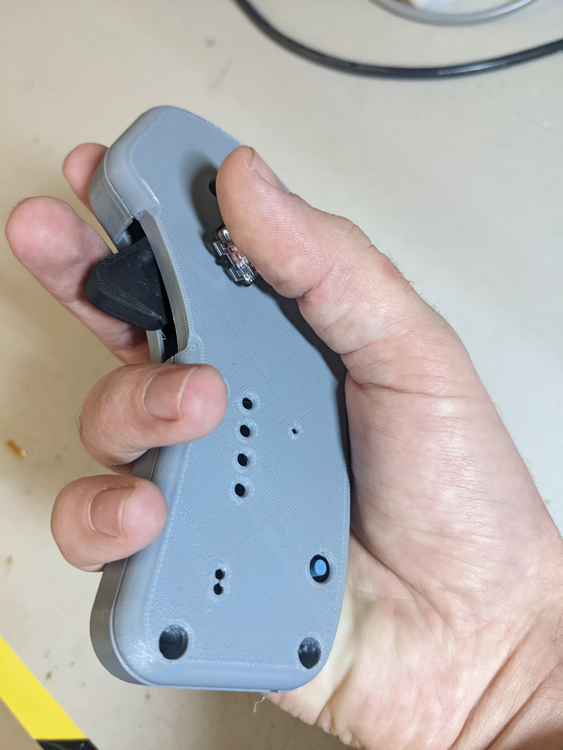

Started tinkering with ergonomics, here’s couple of conclusions ive found so far.
This is my old mini remote, on the left is what most would consider normal grip, however Ive found it troublesome as index finger is touching middle finger, it gets even worse with gloves. So what I’m using is grip style on the right where middle finger is pulling the trigger. Rest of the fingers are used for support similar to OSSR Bruce remote style. I wonder if anyone else has gript like this :thinking:

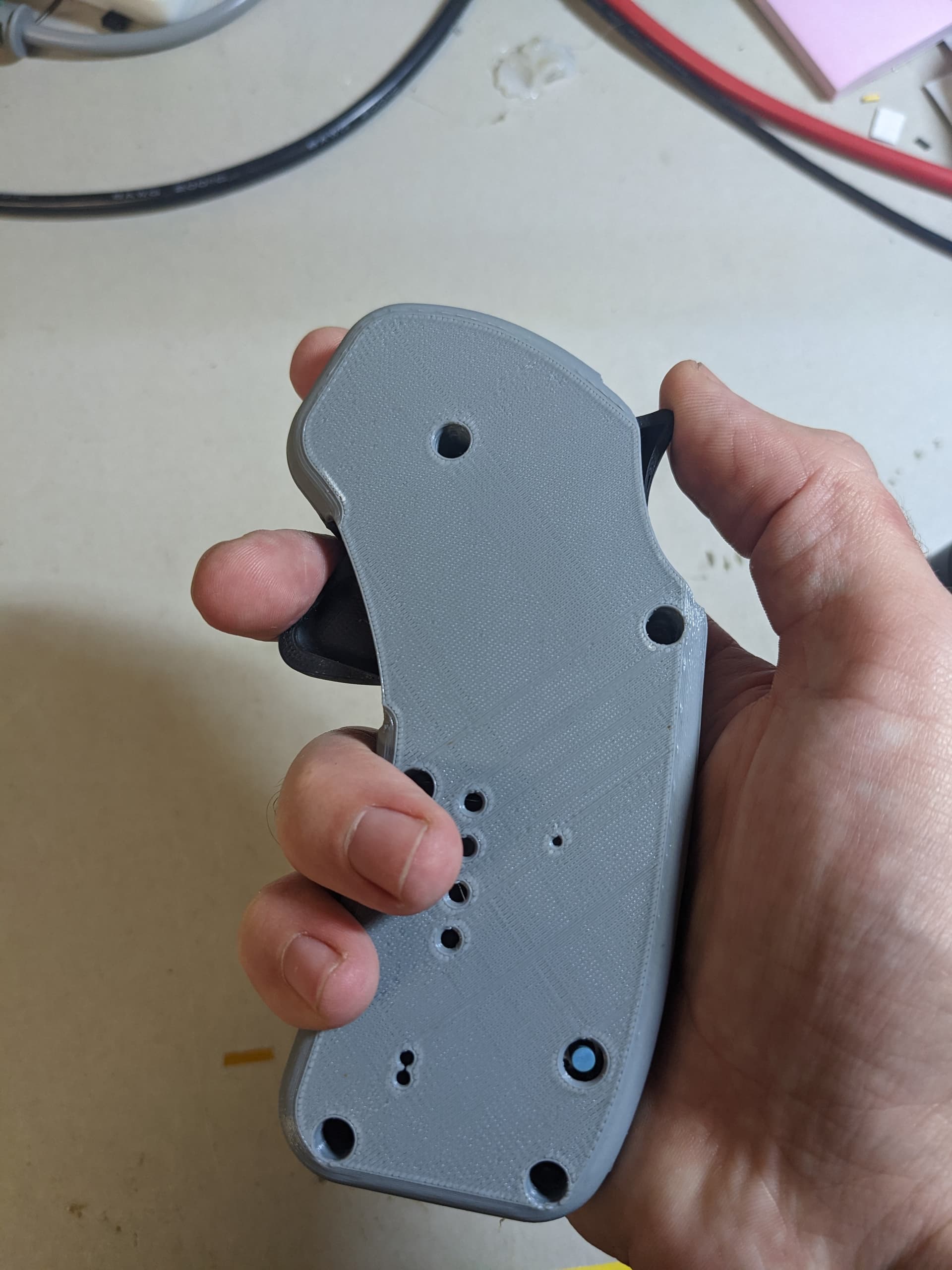

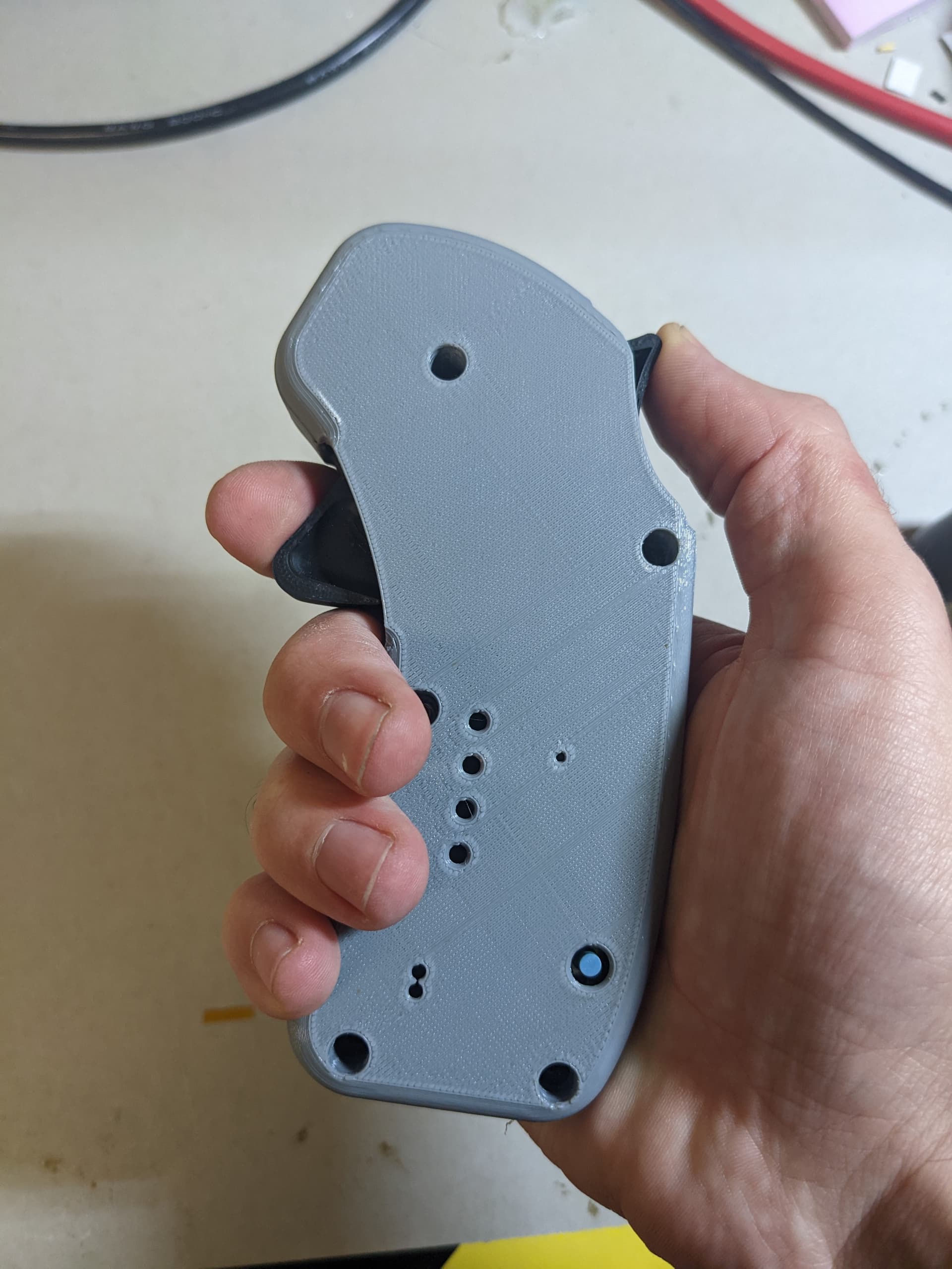

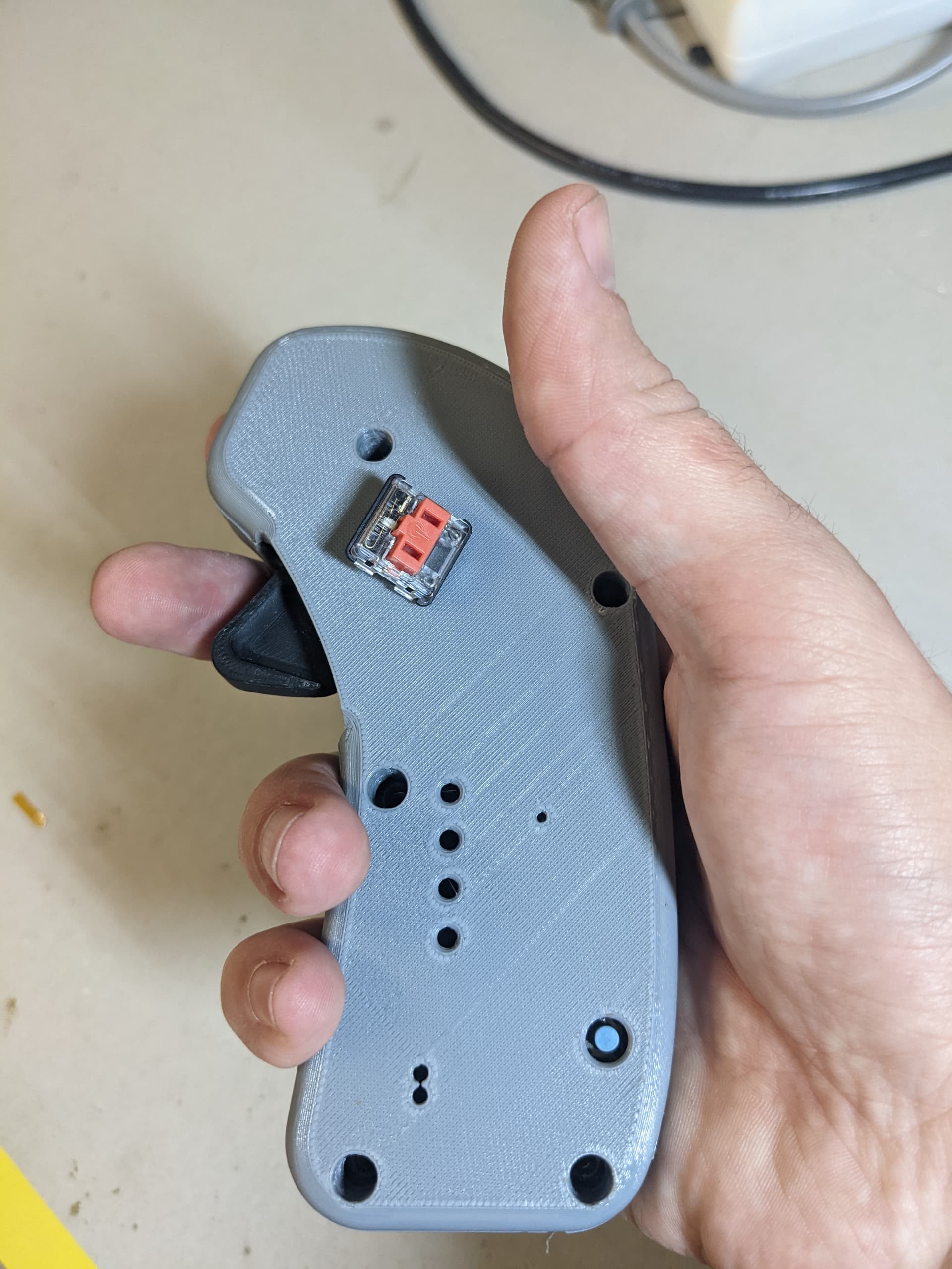

Now I try to transfer same thinking on this remote. Again, on the left shows why I can’t do regular grip, index finger with trigger touches middle finger, when brake is pressed forces get disributed unevenly. On the right is style I use now, sortof works, even though most gripping work is done by the ring finger and pinky. Thumb is still in odd position and gives lot of paranoya as to not accidently nudge it during acceleration that would lead to sudden breaking force being applied.
This got me thinking, what if instead of brake being on top (and thumb being under stress) It would be placed on the side as a pushbutton that reads how far you have pushed the button. Only issue I see so far is ergonomics, it wouldn’t be pocket remote anymore.
