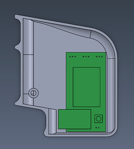

Got the poastmote loaded up and it’s not big enough at all to house the electronics by themselves, nevermind the triggers. I’m going to see if I can keep the ergo and maybe extend it a bit along the bottom so that everything can fit, but as it stands, I can’t even get v1 pcb in there.
Alright, I can’t for the life of me make a dual trigger fit in the poastmote form factor. If I add a massive extension off the bottom, then MAYBE. It’s already larger than the original poastmote, and a tad bit wider. I’m going to continue to mess with it and see what I can figure out.

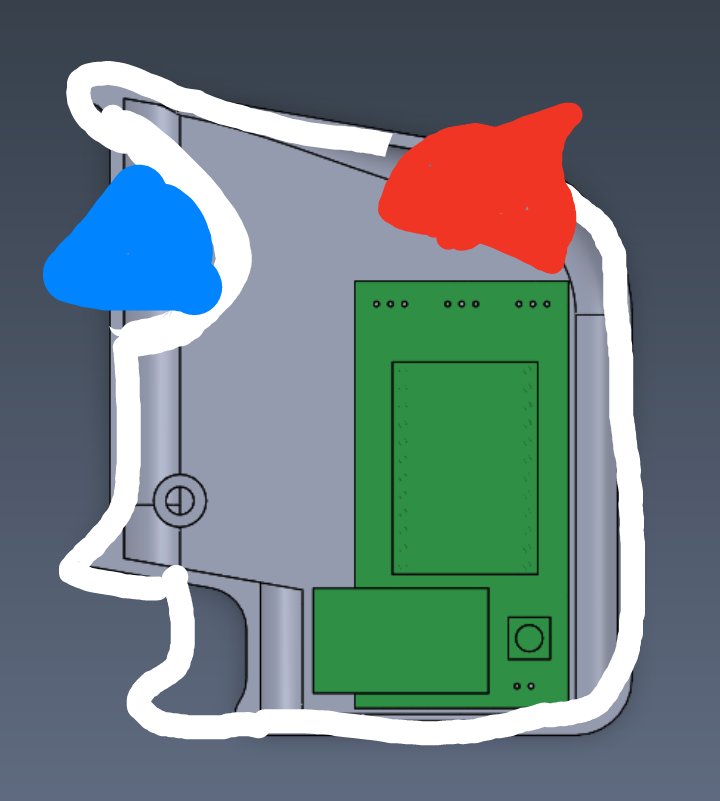

My brain just hatched an idea.
Blue is gas trigger. Red is a one way, nubbed thumb wheel for brake.
Disclaimer I don’t know shit about remote tech.
Idk if the blue is truly enough space for a trigger but not a bad idea

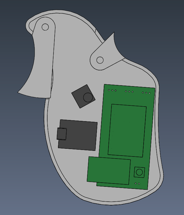

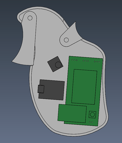

The issue comes in with the pull style of the trigger. Having a short throw trigger like the blue is showing means it will act more like a rocker. I’ll play around and see what I can do. I printed that housing last night, and it’s a bit big, even for my liking. I really want to stuff a 18650 in these remotes for an easily swappable/replaceable battery.

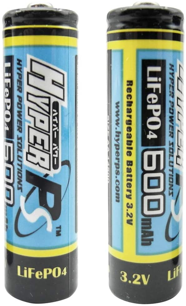

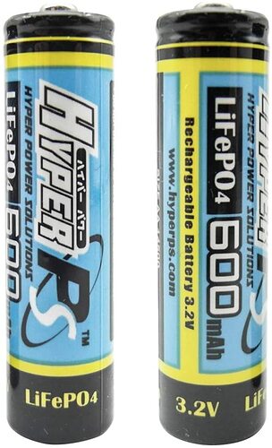

14500 cells can be even easier to swap and replace, they are the size of a AA battery, and they are widely available. They can allow for much smaller remotes as they are much thinner.
These are just 2 random listings I found with little effort. I don’t know about the second, but the first link happen to be cells I do use for esk8 remotes. Second are 4.2V li-ion, first is 3.65V LiFePO4
https://www.amazon.com/CWXY-Replacement-Battery-Custom-14500/dp/B09KRFKYMK/ref=sr_1_26
