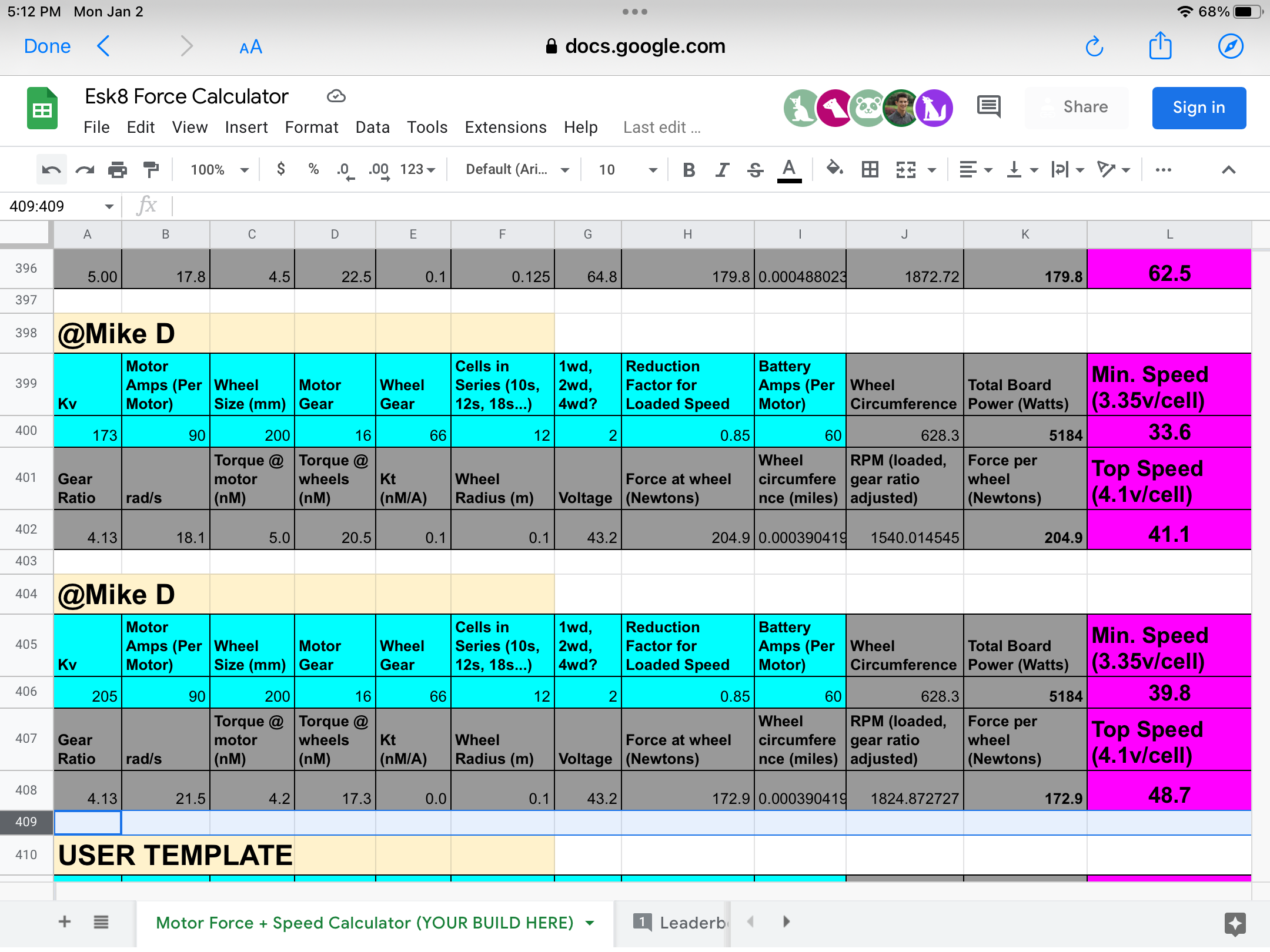

We are only one step away from calculating acceleration. F=m*a, so acceleration = force / weight (board + rider), in m/s^2. 9.8m/s^2 is 1g (gravitational acceleration). It would be interesting to see who can pull the most g acceleration. This can also be used for some extra calculations like theoretical zero to whatever speed timings.
My mountainboard for example is currently 525N, me+the board is 95kg, so the acceleration is 5.52m/s^2. My motor amps are set the same as my battery amps, which means that my acceleration is not going to drop off if I reach a higher speed. If the battery amps are lower then I am not sure if it’s possible to calculate everything accurately in a single cell.
With that and a theoretical top speed somewhere around 15 m/s (54km/h) I should be able to reach my top speed in t=v/a=15/5.5=2.7 seconds, not accounting for wind resistance (to account for wind resistance which is scaling cubically with speed, I need more than a single cell to do it accurately). But from my experience it takes somewhere around 1200w to keep this speed, which compared to my max power of 7.5kW isn’t that much so probably 2.8-2.9 seconds is reasonable. We could also make theoretical 0-20mph 0-30mph 0-40mph calculations and add it to the leaderboard.

That’s awesome. Motor amps are set to 110
Which one would you run?
Is the crossover from where you’re limited by motor current to where you’re limited by battery current just RPM = (Battery Amps) * (Battery Voltage)*(Motor KV) / (Motor Amps)? Naively that is what I would expect, but there could be something I’m not thinking of. It could be interesting to add a thing for what speed you become battery limited at.

I would run the 173kv, but I also don’t ride above 35mph.
On the 205kv, you’re going to have noticeably bad takeoff force with your current setup. It’s less powerful than my dremelseed and I can launch that thing with full throttle with no fuss.
My take off is good and not out of control with the 173kv, but I feel like it could be just a tad more aggressive. Can I get more torque in the vesc settings or would gearing be the route you’d go!!
After looking into it more I was right earlier, but it’s a lot easier to just do Max Torque Speed Limit = (Battery Current)*(Battery Voltage)/Force. That directly gives you the speed at which you become power limited and your torque will start falling off, at least theoretically.
