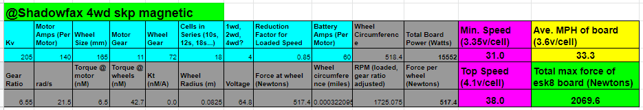

The Ultimate esk8 calculator - with Force in Newtons
What ESC is 22s and 210 motor amps?

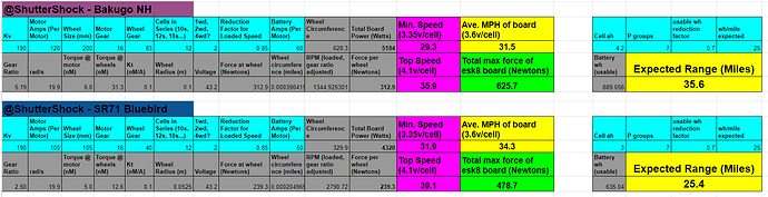

The range estimation is decent, definitely a bit high if I’m flinging it tho
I noticed this as well, my 12s8p would struggle to get the calculated 38 miles with the way I ride.

Bump down that wh reduction factor to 0.6 :slight_smile:

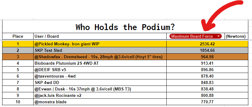

After a considerable amount of effort, I have created a top-ten leaderboard that can show the top ten in speed, force, and range.
Everything should auto populate. Do not touch formulas, the only thing that needs to be configured is the drop down to select which type of leader board you’d like to look at. It’s not super pretty visually right now but it’s definitely cool, and it definitely does the job.

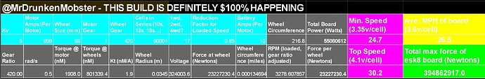

After putting all this work in, I’ve seen some weird things in here, like this:
I would kindly request that things like this do not occur in the future, maybe we can find a nice way to fix this.
