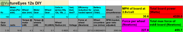

The Ultimate esk8 calculator - with Force in Newtons

is 190kv on 12s a huge thermal difference? vs 170
You will trade a little acceleration in favor of more top speed. Depending on how you ride, this might be worth it.
The calculator available on our site also estimates your builds power, force. Plots it on a nice interactive chart, against speed and kv (@rusins )
Top speed is confusing in your calculator because it’s not top speed. It’s speed at nominal voltage. You might change that to say “speed at 3.6v/cell” or something like that.
It is a very nice calculator.
I purposely left out torque because it is a confusing unit. Most people think torque is the same as force, and it’s simpler to just present the force value, because that is what we care about really.
I’m not sure your force calculation is correct. Maybe check it against mine and see what doesn’t line up. All my formulas are in the spreadsheet.
Between 190 and 170 nah I don’t think so. And if you get reachers you’ll get even better cooling

Feeling good about these numbers for my new build. I used the RAMM calculator when I was planning the build. This is cool to be able to see your numbers compared to other boards.
