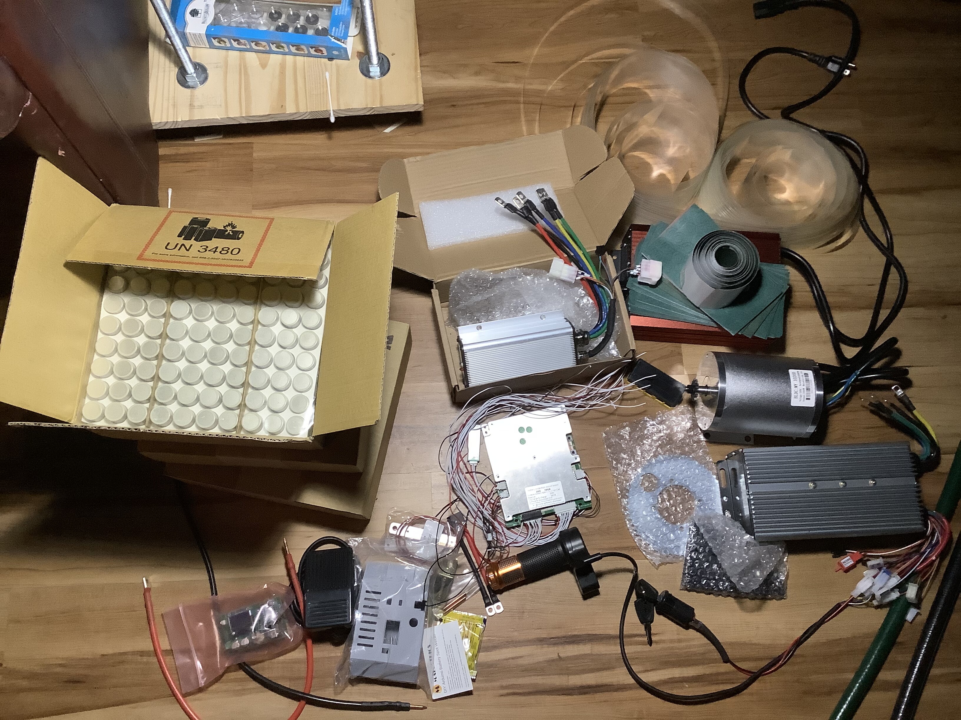

Called it the storm because it’s a shitstorm of parts I ordered
Crap I’m waiting for:
Razor SX500
72v 3000w 1020 motor with 50a controller
Kelly kls7218s
20S charger with 12a adjustable
LLT 100a Smart Bms
Molicel P42a x100
Maelectric Spot Welder
I was thinking 20s4 or 5p, but seeing a 20s20p build I’m wondering about more :rofl:, if I don’t get screwed on customs first time and whatever fits nicely. Also I might set up a BMS bypass for running 200a 20sec turbo. I’m thinking I should have just got the 200a but seemed excessive idk?
Well that’s basically all I got now and waiting. Need to order battery supplies still.

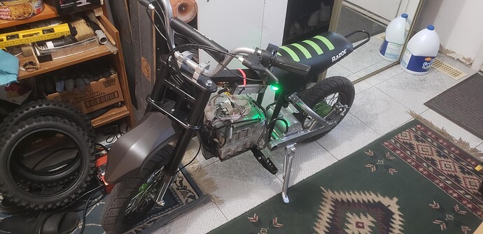

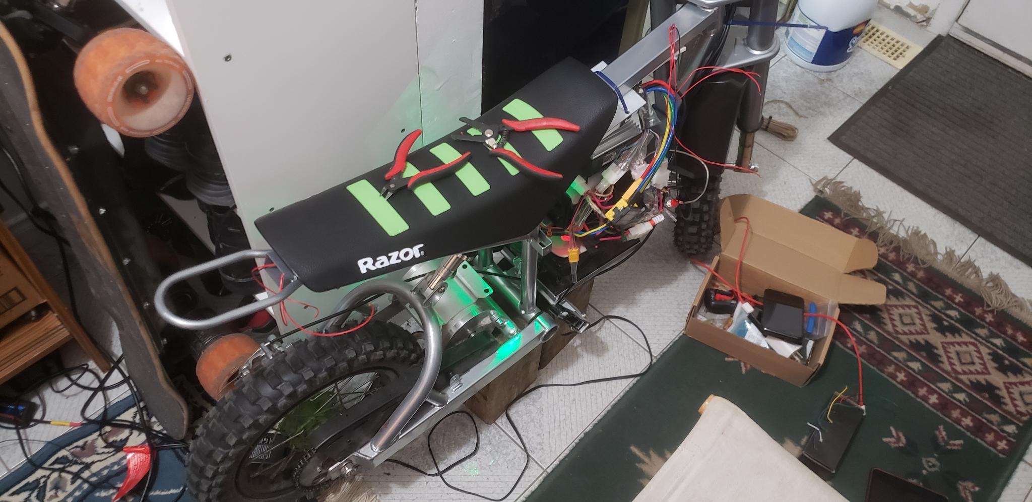

1 brazillion years later and after all my stuff came from china including slow boat, the bike came in. Dremeled the frame a bit to fit the motor screws otherwise perfect. Switched to my stock motor sprocket. Working through all the wiring shitshow now and repinning connectors.

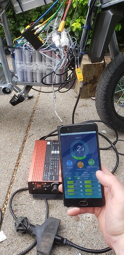

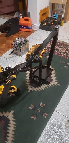

Got sick of the lead acid and did the 20s6p finally. Not the greatest build, lots of stuff I’d improve next time but seems ok. Would have liked to do 3 stacks but I felt for a first build it would be too much. I could always build another spare like this.

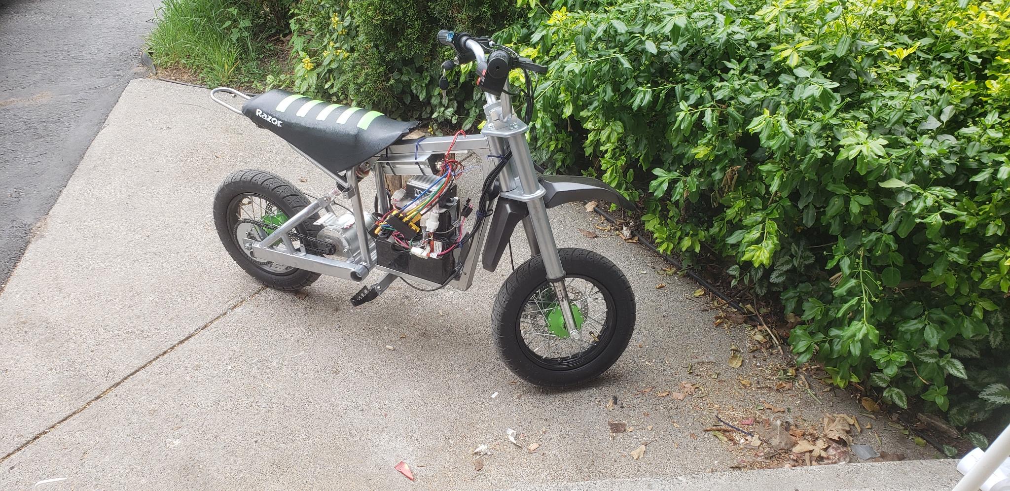

Painted and did some wiring cleanup. Running 100A its crazy, I guess goes without saying. Not sure what info would be useful from this build to people. Extremely happy how things are right now.

Started at full voltage 84.1 and after was 82v

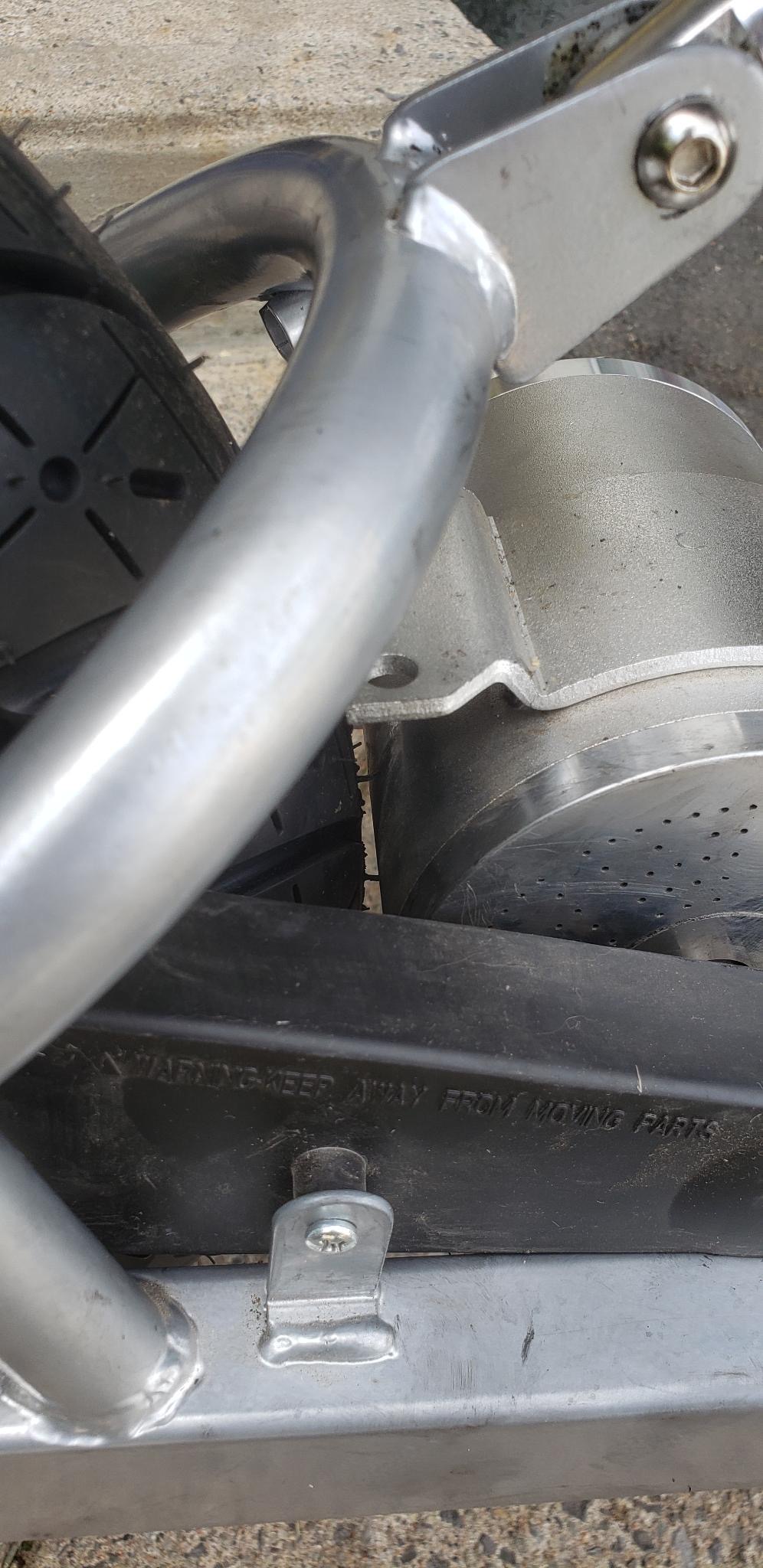

Soo against most good advice I proceeded to order a 3.5x10 rear and after dremeling the rear bolt and caliper mounts it fits pretty nice. I have about 1mm of clearance to the motor, this is fine :joy:. Debating grabbing a 2.75 for the front to balance things a bit. The handling has improved dramatically, the front feels a bit squirrly still so thinking a slightly wider front would be awesome. Efficiency is down, motor runs warmer and so does the controller. Motor was finally hot to the touch today. The wheel is a larger diameter with the fitment on a 2" rim so I’m thinking changing the front sprocket to a 7 - 9 tooth will improve things.
I wonder if the wheel could potentially touch the motor while moving at a certain speed with the centrifugal force.
for the heat could you find a heatsink that would fit on the motor? kinda like the ones you can find on some rc cars
for the controller i guess you could stick a fan or 2 on it to actively cool it or get a better one
Yeah I could attach a heatsink to the motor since I got the version with the mount plate. And yes the tire does touch the motor when it spins really fast in the air but it doesn’t seem to happen when rolling on the ground fast. Only issue is how I created a channel for the wheel to move back, it creeps forward now because of the forces. May need some bead welded in there to make the axle sit permanently at the modded spot.
