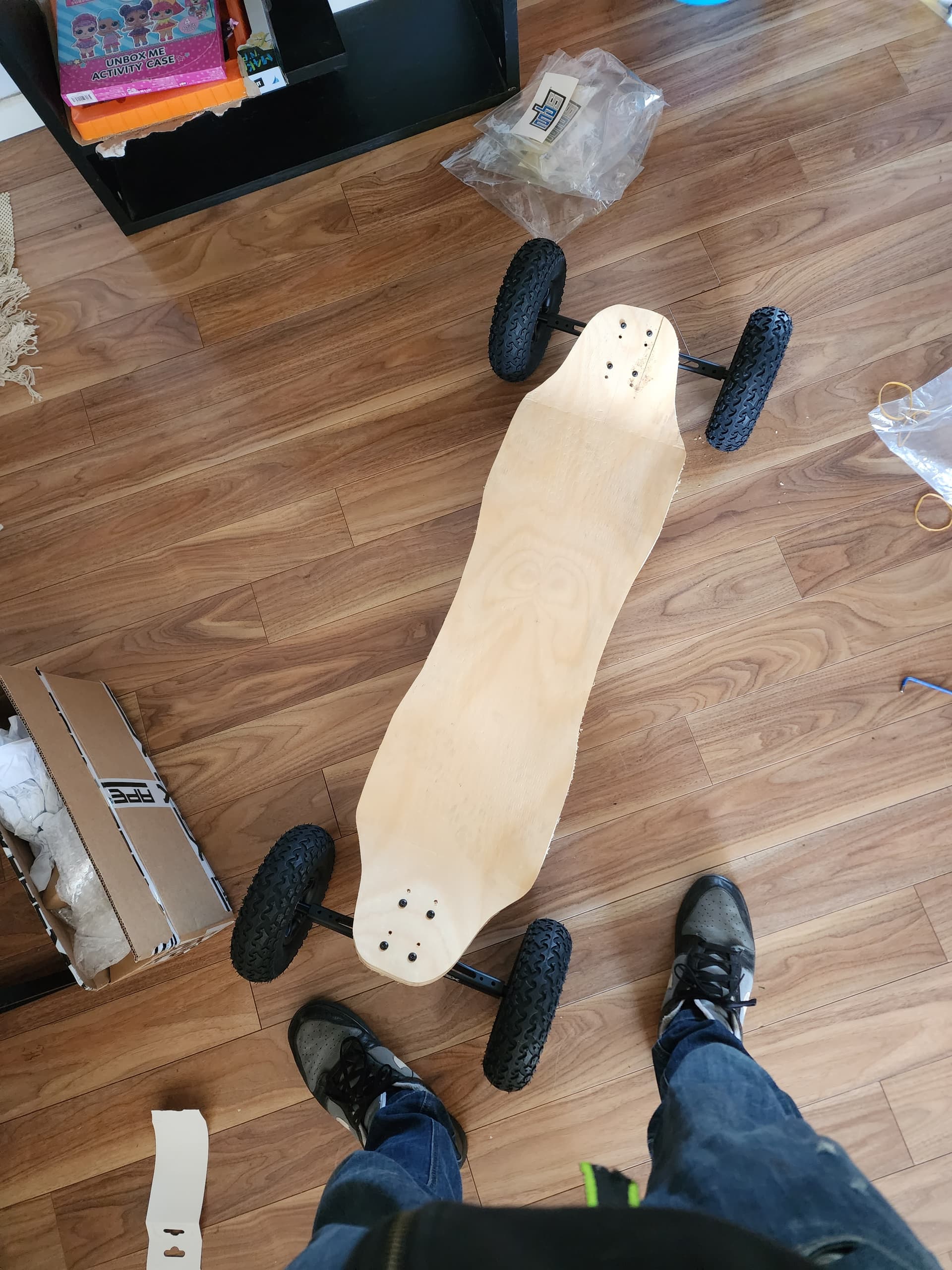

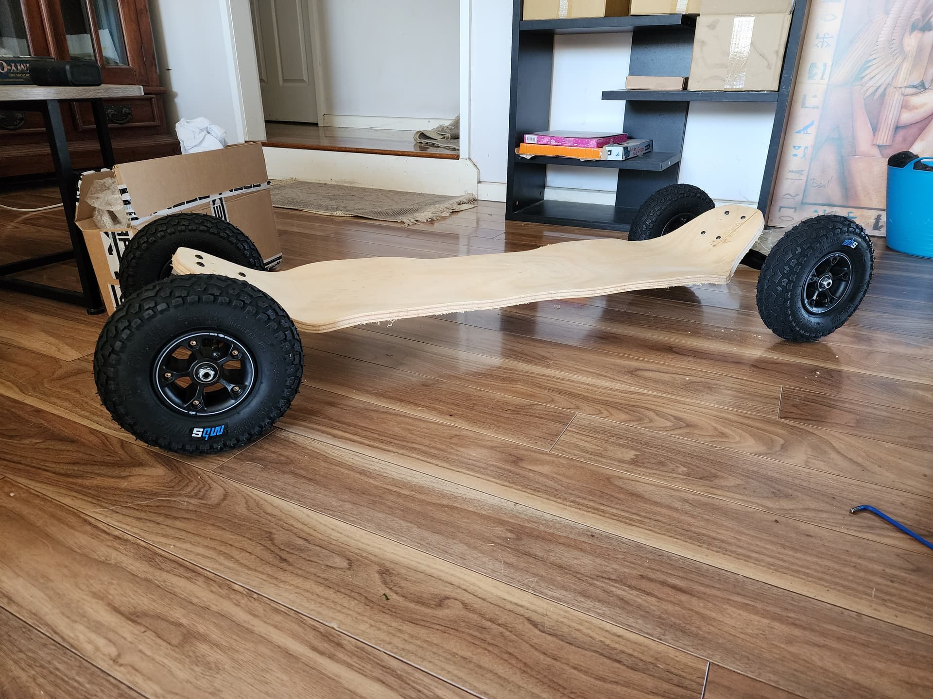

Found some valuable minutes… this thing feels fucking huge. Axle to axle I have 1015mm on the outermost mounting positions, at a guess I would say it’d be more like 975mm on the inner positions.
Standing platform feels really roomy, but gonna need to mock up the top box to determine binding positions, which I reckon is gonna be a bit tricky to accommodate my posi/posi stance.
Flex feels like it’s gonna be good! I need to add some reinforcement to the deck as the hoop pine alone isn’t gonna cut it, but I need to be careful not to add too much, I don’t want this one super stiff.

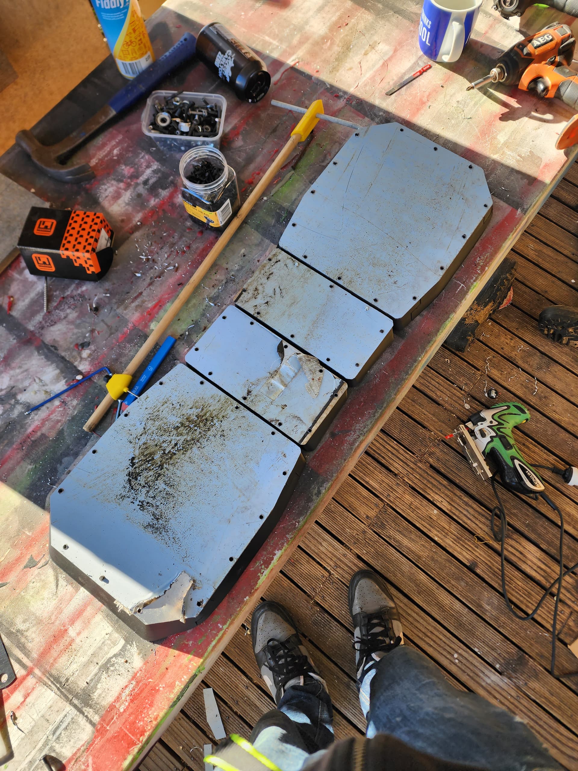

The aluminium plates for the enclosure are roughly cut and drilled, need to snag some sikaflex from work to fully assemble the enclosure, will bond the enclosure walls together and to the aluminium and then i can sand and paint as one.

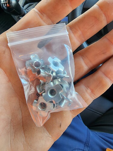

Got a bunch of m5 bolts and t nuts for the enclosure. Plan is to counterbore the top of the deck so that these t nuts sit flush, and then skin over the top. Gotta hope that i never ruin the treads, but shouldn’t be too much of an issue considering the bottom box will only be holding batteries.
Also need to get some of these in m6 for the bindings.

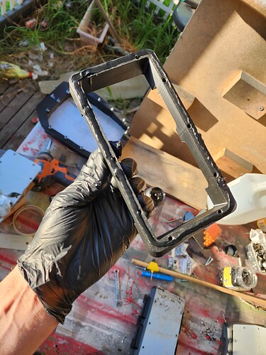

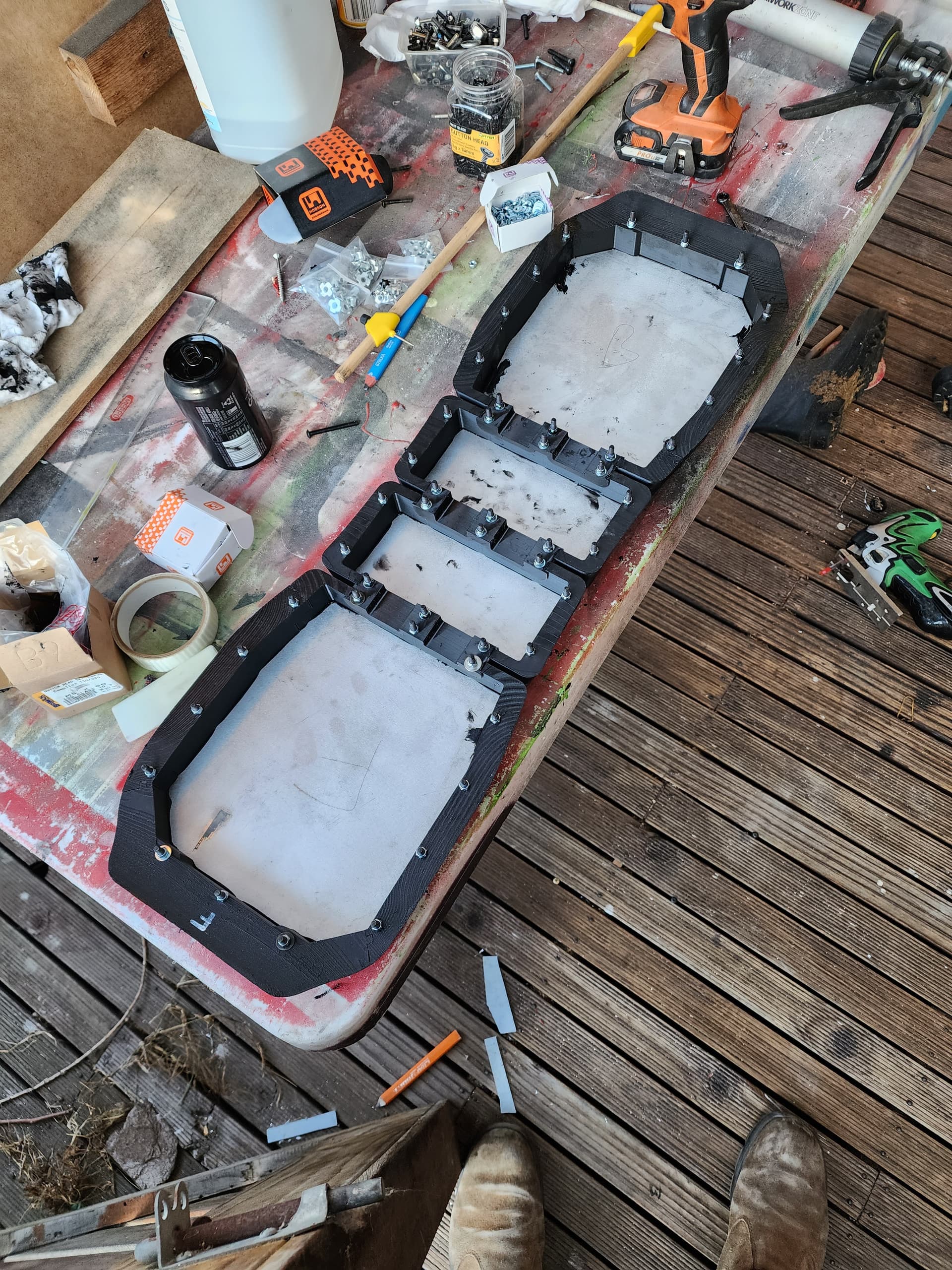

Found a tiny bit of time. Slapped on the Contino Condoms and got messy with the sikaflex. Sealed between all the aluminium/petg/tpu sections, as well as sealing in the joins where the petg walls connect together for the larger sections.
Didn’t realise how heavy this enclosure would be :flushed: it’s not ridiculous, but definitely got some heft. Should be tough as nails tho!

Removed all the temporary bolts and the sikaflex polyurethane sealant is doing its job perfectly.
There are some bolts that won’t go all the way through and have a housed nut inside the petg walls and the tpu flex connectors.
The nuts in the tpu don’t hold when trying to tighten them so i’ve superglued them in and hoping that will do the job :grimacing:

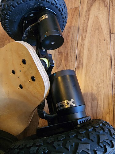

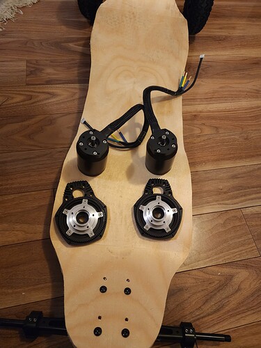

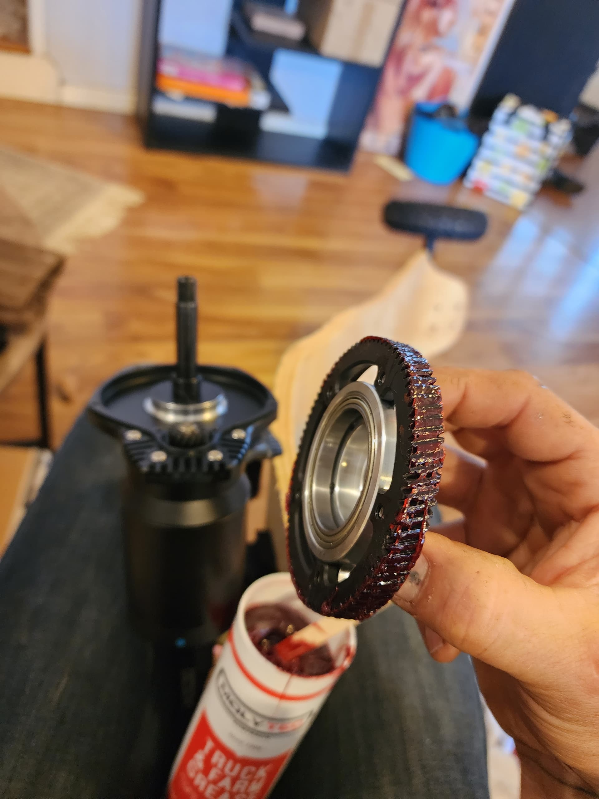

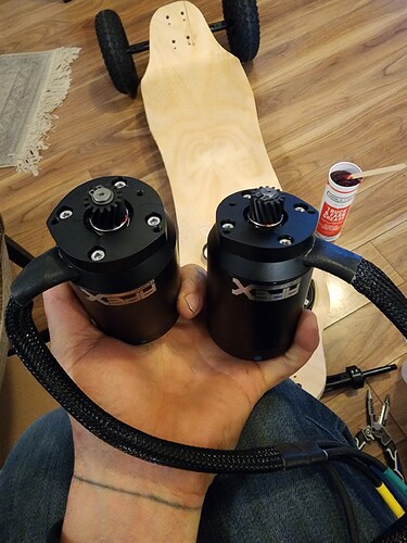

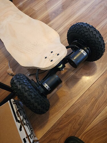

Gear drives installed!!!
Was a super easy and pain free installation, start to finish, fully loctited and greased in 1.5hrs :partying_face:
Thanks @ApexBoards !

Drilled all the holes through the deck and then counterbored them with a spade bit for the t-nuts
I tried clamping them in and while this did work, it tended to follow the curvature of the deck, rather than following the line of the hole… this resulted in some of the screws cross threading when I tried to install the enclosure :expressionless:
The problematic nuts were removed and replaced. If i ever do this again, I will skip the clamp idea and just go straight for bolting them in. The bolts pulled the t-nuts in beautifully.

I also need to countersink all of the aluminium holes to appease @Bavioze … i wasn’t going to do it, but I tried a few and it looks great.

Have you tried heat set inserts?
I imagine that would have the same problem as the nuts (the tpu would deform around the inferface features allowing it to spin) only worse (because those interface features are smaller).
For my money, I think his strategy of glueing the nuts in place is his best bet, as it actually bonds the interface features of the nut to the faces of the plastic. Maybe a t-nut in the TPU would be even better than that, because its interface features would anchor into the plastic :thinking:
