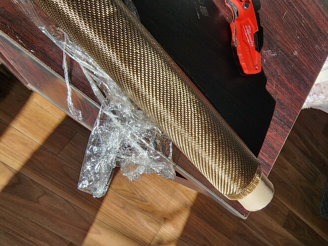

Ooooh the basalt is prettier than I thought it would be… keeeeeennnnnn

Ooh… looks like snake skin :fire:

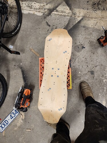

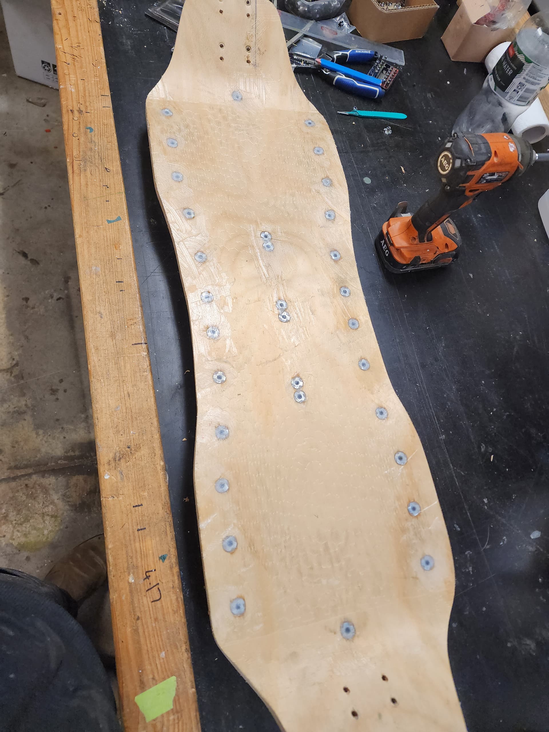

Countersunk all the holes and filed any sharp edges
Filled in around all the t-nuts with thickened epoxy. I put a bolt in each hole to protect the threads… hope it worked :rofl:
Not quite sure how i’m gonna protect all these threads when I do the actual skinning, but I do know it’s gonna be a fucking pain in the dick.

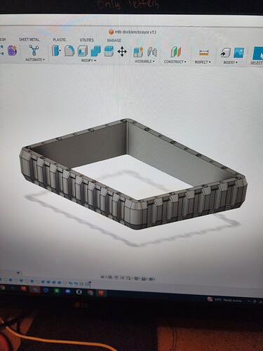

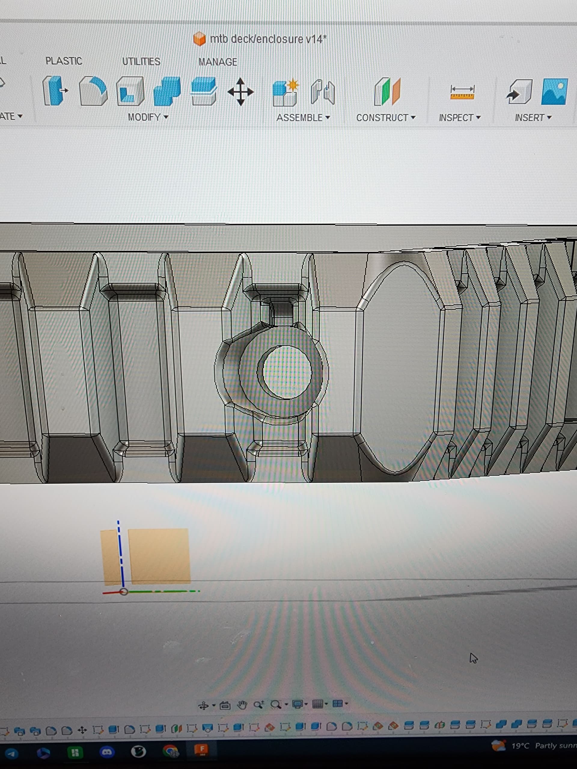

Got a little CAD time in this eve. Pretty happy with the shape of the box, still gotta figure out how i’m gonna split it to fit on the print bed. I got ideas, just need to finesse them into reality.
I don’t think heat set would work very well in tpu. Tpu is such a weird material I think it would just deform around it. They work amazing in the materials though if you set them right

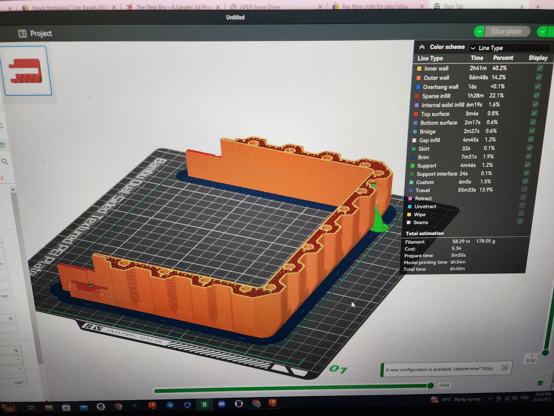

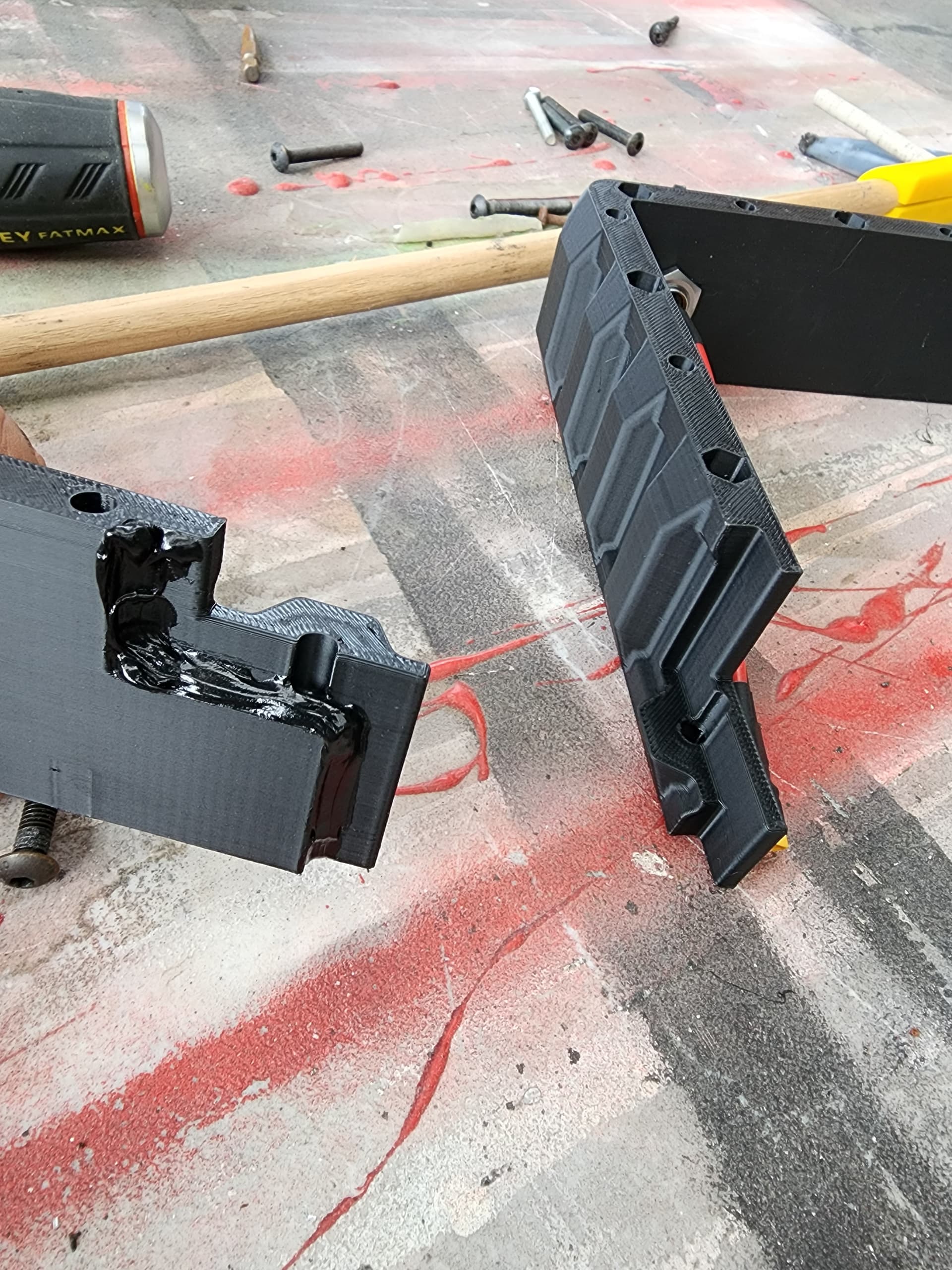

Added a charge port hole and split the model in 2. First half printing now.
Tried some binding positions and locked them in with m6 t nuts. Also added some for the top box to bolt down to.
Pretty much ready to skin!

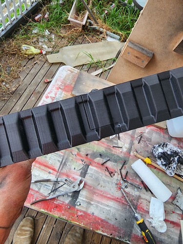

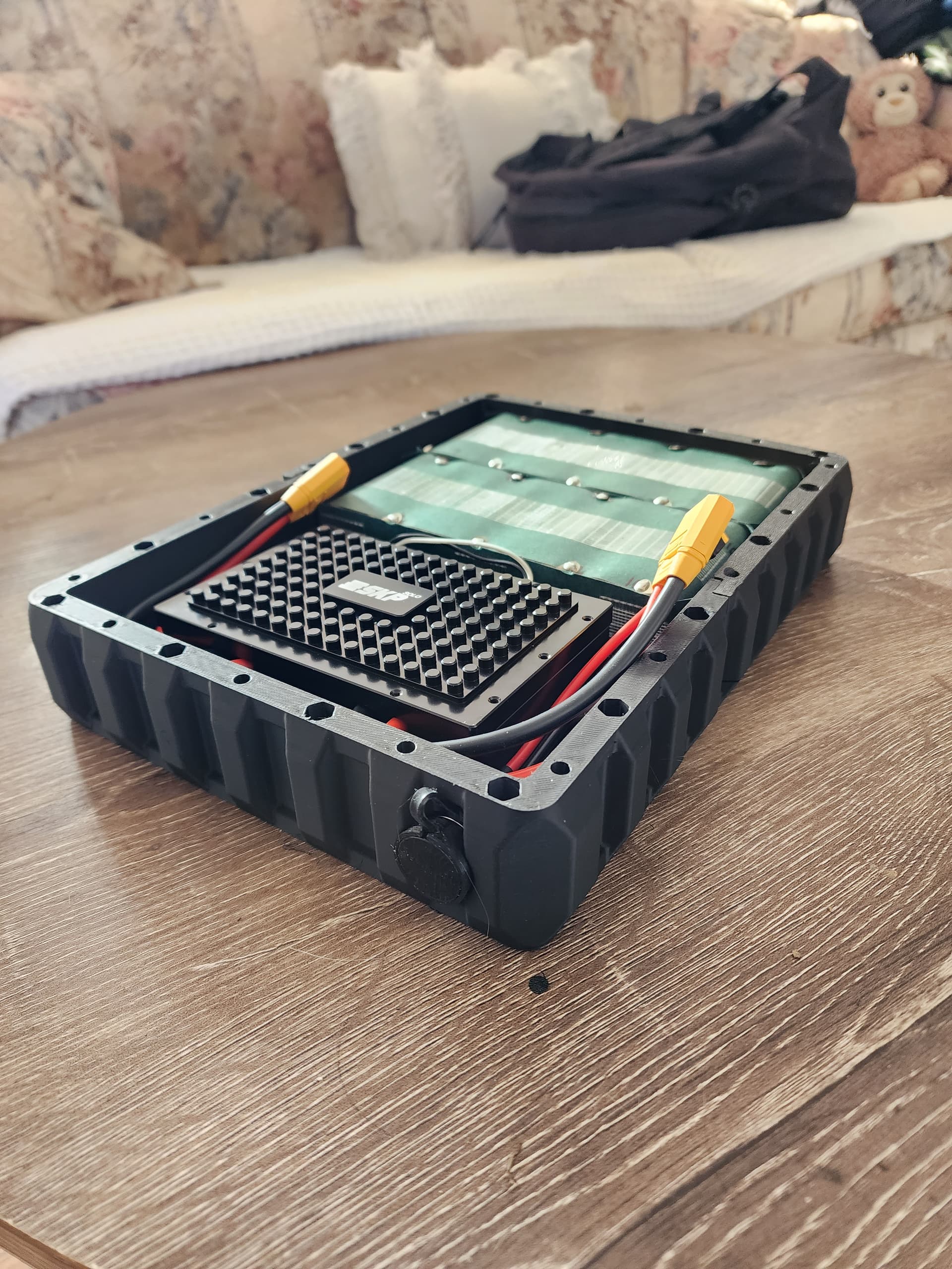

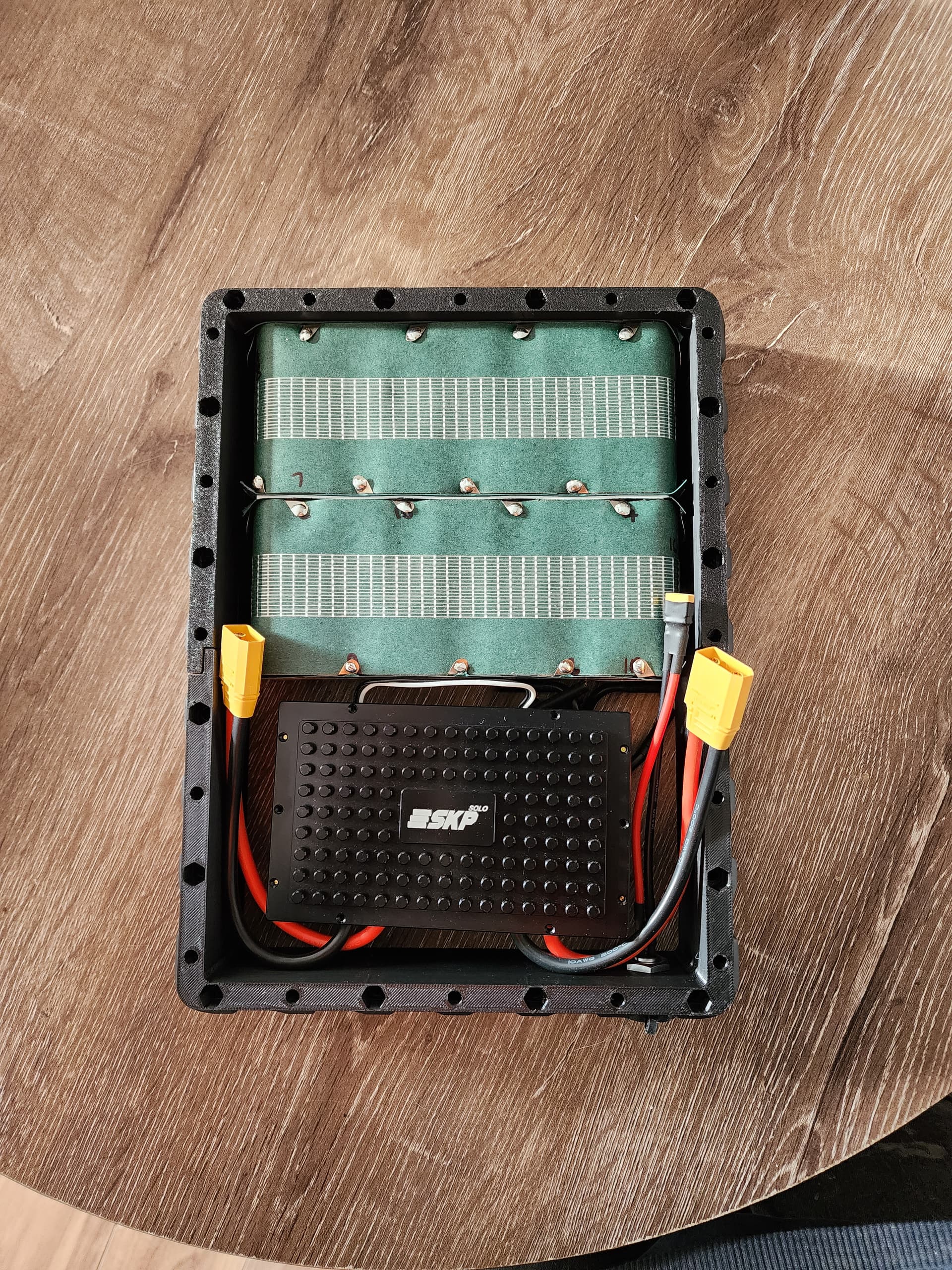

Got the box sealed together, seam line isn’t too bad.
Gonna be a super snug fit in there, but the box is already bigger than I’d like, so it is what it is, just gotta make it work.

Cheers dude. Looking at this top enclosure next to the bottom enclosure, I kinda wish I had’ve designed both at the same time and translated a bit of the design language from the top one into the bottom one… but no matter, the function is the most important part!
Best part is you’re designing this yourself so it could evolve but I reckon some dirt and mileage you’ll not worry about it.

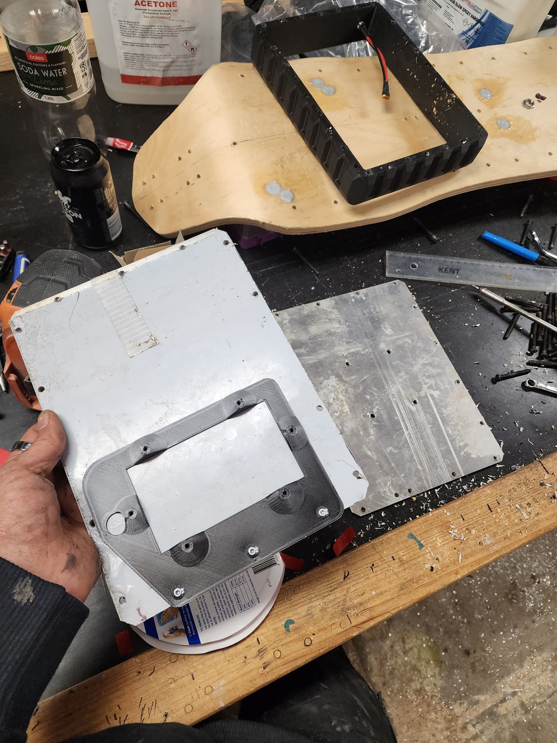

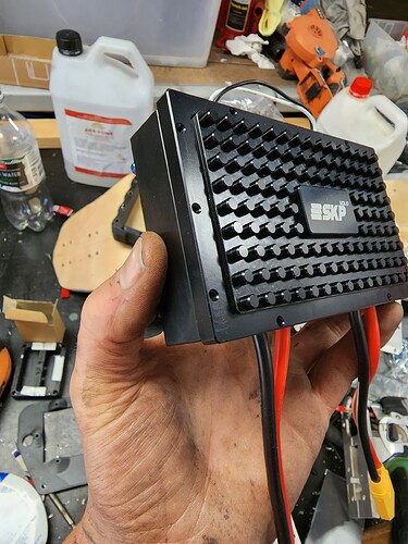

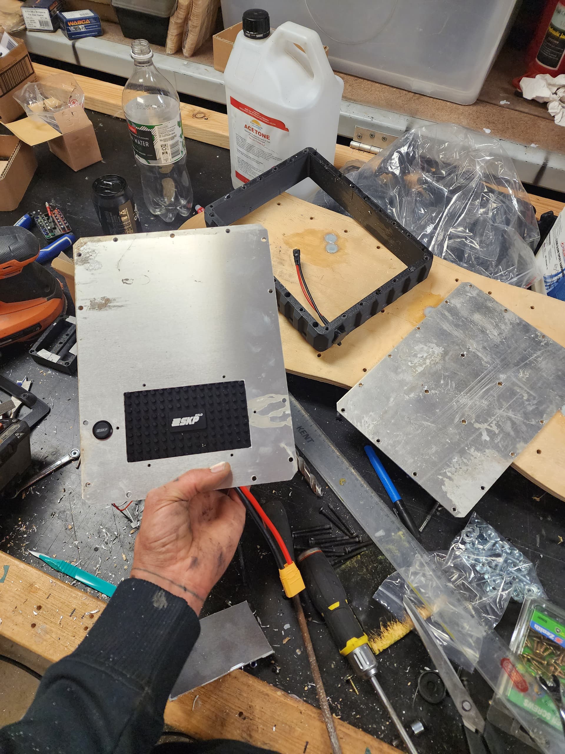

I used the 3dp walls to drill the perimeter holes in the top and bottom lids and designed a little bolt on scribing jig to make the holes for the esc.
To make the perimeter holes, i first cut the lids to size and then used double sided tape to hold the lid to the walls while I drilled. Worked a treat!
They still need a lot of finishing work, but this is good progress!

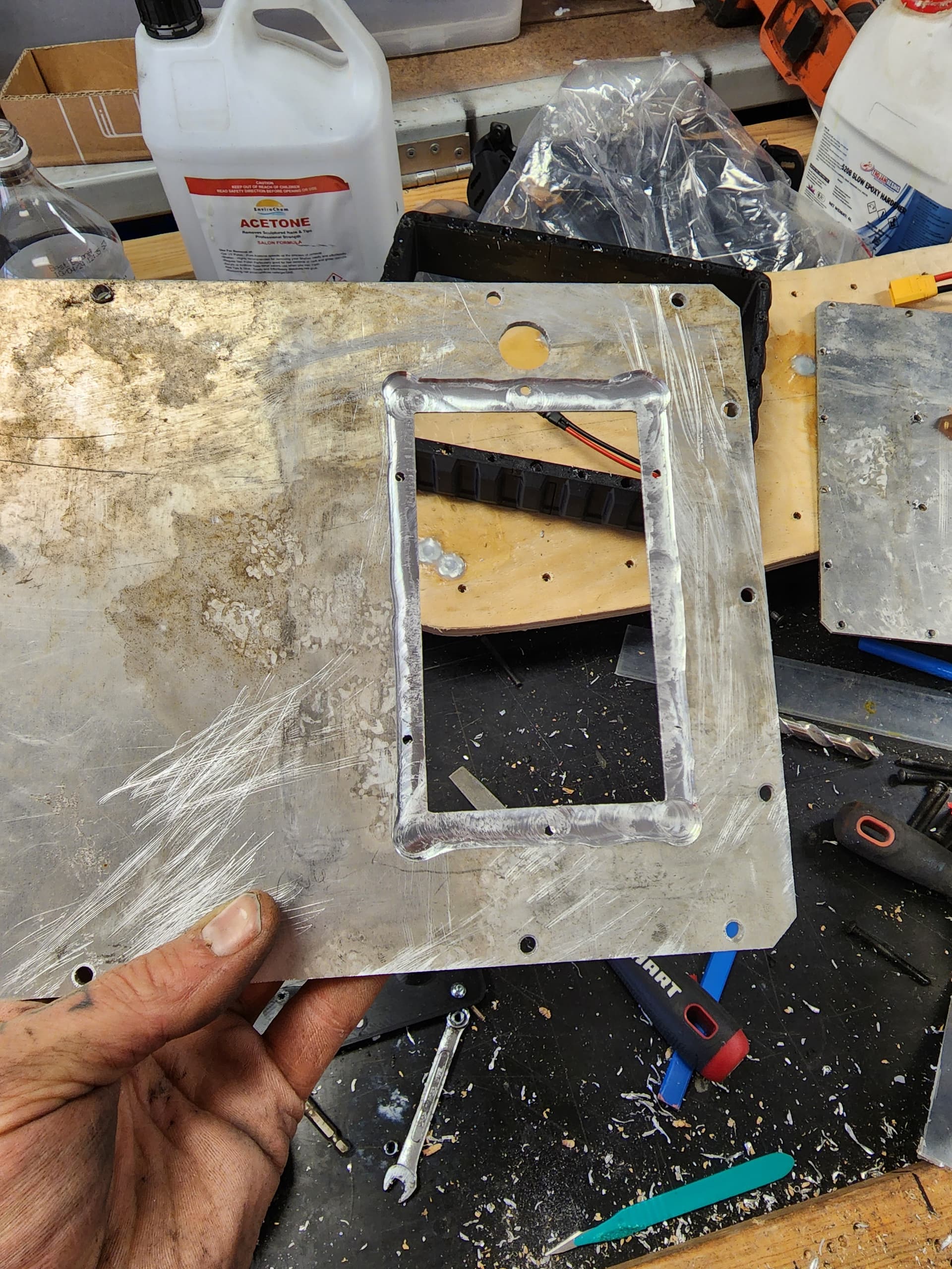

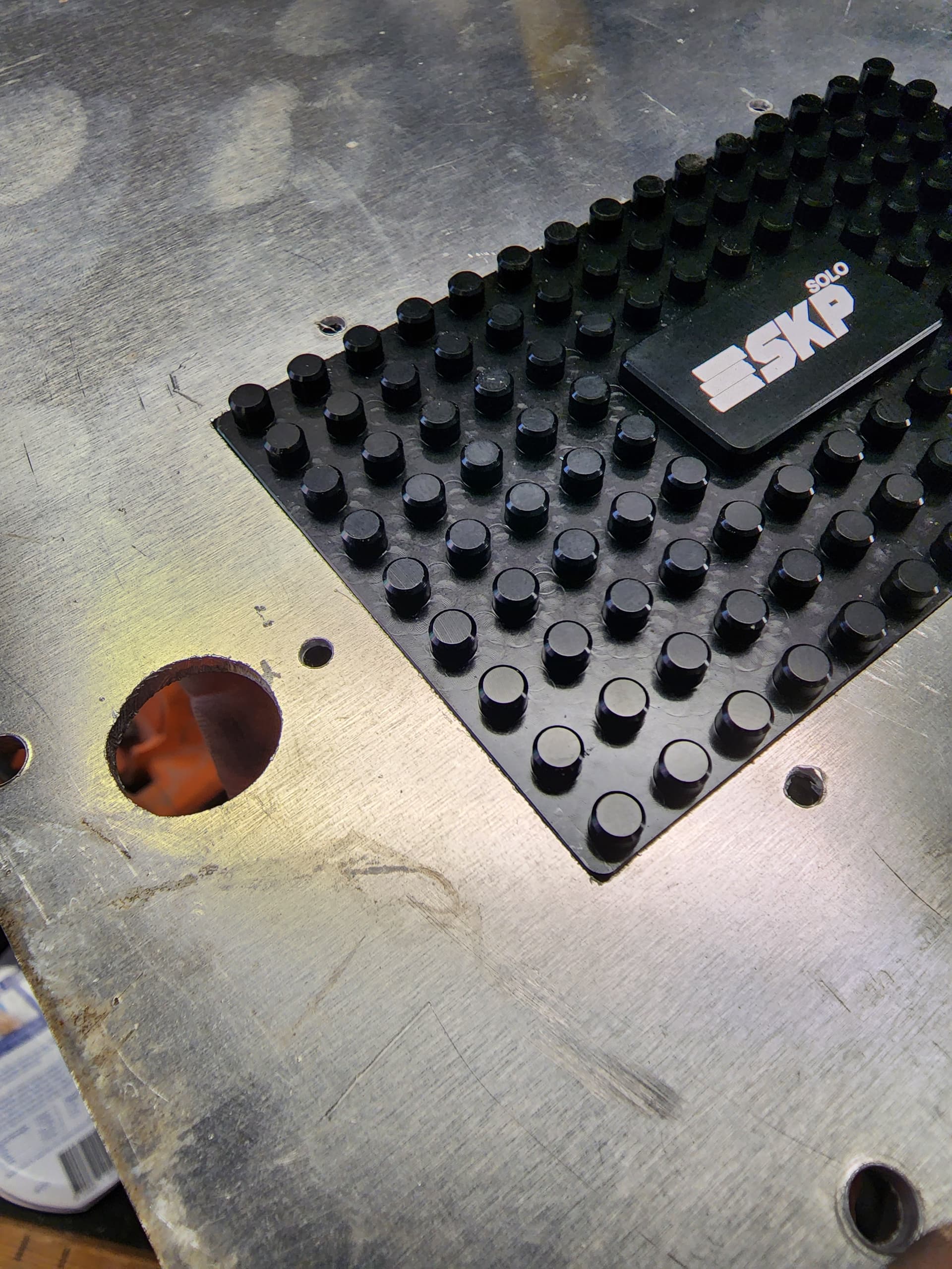

I wasn’t happy with how the solo heatsink looked a little set down from the top face of the plate.
Savaged the underside with a router/trimmer to get the top to sit nice and flush. Much happier now. Definitely gonna paint these plates black, will probably do the same with the plates underneath too just for consistency

No offence but… that kinda looks like you can add lego to your ESC for extra style points :rofl:
