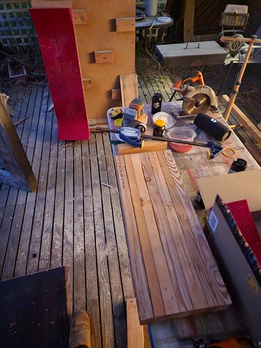

Got the bottom half of the mold together and started working on the top but ran out of daylight.
Got the big timber block assembled to fill in the big void in the top mold, just gotta tidy that up a bit with the belt sander and then attach the whole top together.
After that i’m gonna need to build in some sort of registration so the two parts close together perfectly, that’s one thing that’s missing from the semendeed mold and it can be a bit of a pain.
Then I just need to pray that I have enough height in my press :rofl: i think i’ll be ok. Worst case scenario i’ll need to swap out the timber plates i’ve got in it for some ply.
Ooooh baby! It’s done!!!
There was quite a lot of work involved, definitely not just as simple as design/print/done. Pretty stoked with it as a mold building method though.
It’s definitely gonna fit in the press, so no dramas there. Just gotta hope it holds up under pressure!!!
Added a couple of dowels in each end to register the two halves of the mold and make sure they are in the right position before pressing, hopefully they work out ok.
Once the foamy glue cures it’ll be ready for a little tidy up with the sander and then good to go! Got some shit I need to get done in the shed over the next few days, so the first press gonna need to wait til the weekend… pretty excited for it tho!
